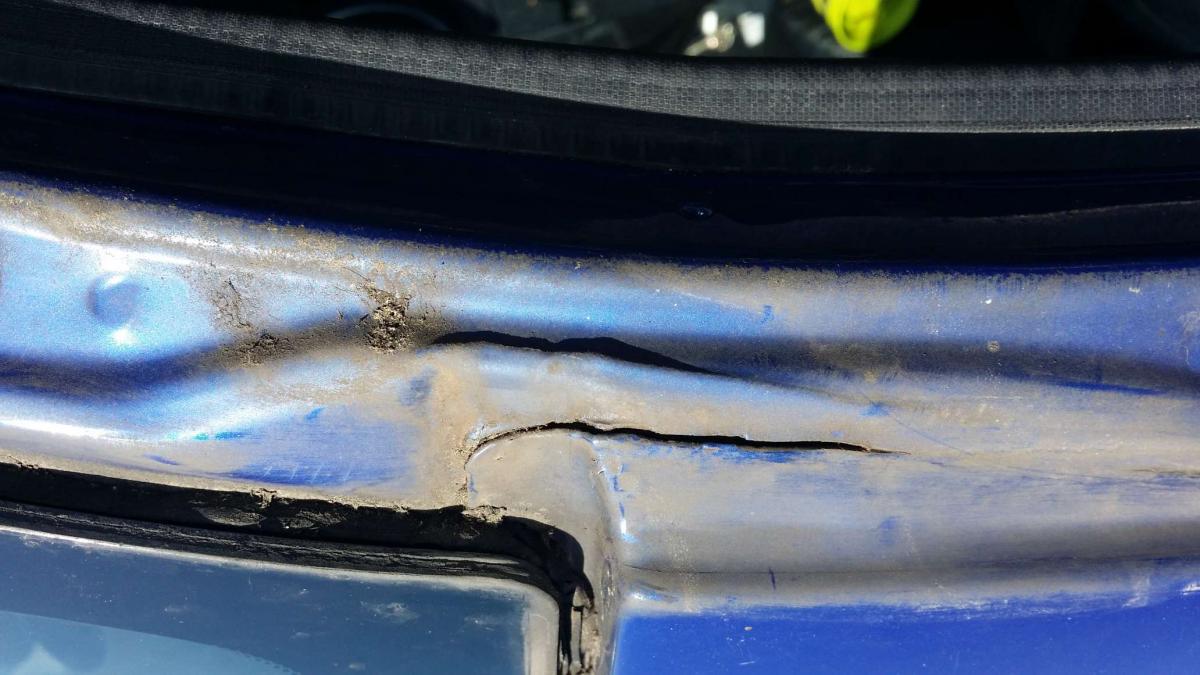

BenC Posted July 13, 2015 Share Posted July 13, 2015 (edited) Hi All, I bought a 350z the other month and when having a windscreen replacement for a small stone chip I found there was a 5cm long, few mm wide crack on my A Pillar (hopefully an image attached below). My local Nissan Dealer is unable to help and I want to find a good body shop to replace the crack and fit a new Door/Roof Trim that also was cracked and just filled, and a new upper seal and trim mounting. I am based in London (SE) and work in Essex. Can any one help!!!! Thanks, Ben Edited July 13, 2015 by BenC Quote Link to comment Share on other sites More sharing options...
MIGWEL Posted July 13, 2015 Share Posted July 13, 2015 Im sure any bodyshop could do an easy repair on that but without filling the whole thing. Probably weld it and grind and then a skim of filler. Im in the south east and theres a brilliant bodyshop near me but probably too far for you as im 5 minutes from gatwick Quote Link to comment Share on other sites More sharing options...
Randy_Baton Posted July 13, 2015 Share Posted July 13, 2015 very odd place for a crack, I'd like to know the sorry behind that! Pm Zmanalex for 2nd hand door trim or try Clark motor sport for a new one. Trim is usually very easy to fit, getting the old stuff off without breaking it is usually the hard part. Quote Link to comment Share on other sites More sharing options...
ATTAK Z Posted July 13, 2015 Share Posted July 13, 2015 very odd place for a crack, I'd like to know the sorry behind that! Pm Zmanalex for 2nd hand door trim or try Clark motor sport for a new one. Trim is usually very easy to fit, getting the old stuff off without breaking it is usually the hard part. Have you looked at the photos ? ... that is not trim ... it's structural Quote Link to comment Share on other sites More sharing options...
Bodyboarder81 Posted July 13, 2015 Share Posted July 13, 2015 Where did you buy the car from ? Quote Link to comment Share on other sites More sharing options...
Ebized Posted July 13, 2015 Share Posted July 13, 2015 Have you looked at the photos ? ... that is not trim ... it's structural My local Nissan Dealer is unable to help and I want to find a good body shop to replace the crack and fit a new Door/Roof Trim that also was cracked and just filled, and a new upper seal and trim mounting. Thanks, Ben You got Porsche red mist Hugh Quote Link to comment Share on other sites More sharing options...
ZMANALEX Posted July 13, 2015 Share Posted July 13, 2015 Ouch!!!! that has taken some whack. Closer inspection is definitely required. Quote Link to comment Share on other sites More sharing options...
ATTAK Z Posted July 13, 2015 Share Posted July 13, 2015 Have you looked at the photos ? ... that is not trim ... it's structural My local Nissan Dealer is unable to help and I want to find a good body shop to replace the crack and fit a new Door/Roof Trim that also was cracked and just filled, and a new upper seal and trim mounting. Thanks, Ben You got Porsche red mist Hugh Sorry , don't understand that ... Quote Link to comment Share on other sites More sharing options...
Bockaaarck Posted July 14, 2015 Share Posted July 14, 2015 Agree with Alex, that looks to have take a real whack at some point. I would get it checked asap. I would also start looking at getting yourself prepared (just in case) for taking it back to wherever you bought it from and getting your money back (should that be required). If its structural I would be very concerned about the implications of that alone, plus any other potential damage which may be / may have been hidden Quote Link to comment Share on other sites More sharing options...
mouthwash Posted July 14, 2015 Share Posted July 14, 2015 It's already covered in filler isn't it? (just to the right towards the windscreen) Quote Link to comment Share on other sites More sharing options...
Grundy Posted July 14, 2015 Share Posted July 14, 2015 That's a Cat D/C right there. Quote Link to comment Share on other sites More sharing options...
Bodyboarder81 Posted July 14, 2015 Share Posted July 14, 2015 We really need more info dude ...... If bought from a dealer in the last 3 months I would be heading straight back . Quote Link to comment Share on other sites More sharing options...
veilside z Posted July 14, 2015 Share Posted July 14, 2015 Was it bought with a cracked screen cheap with this structural damage? This was obviously covered by the old trim, then im thinking why would you buy it with a damaged trim. I can't believe Nissan can't help. They all have a body shop they use. If damage is just surface then it can be easily fixed Quote Link to comment Share on other sites More sharing options...
