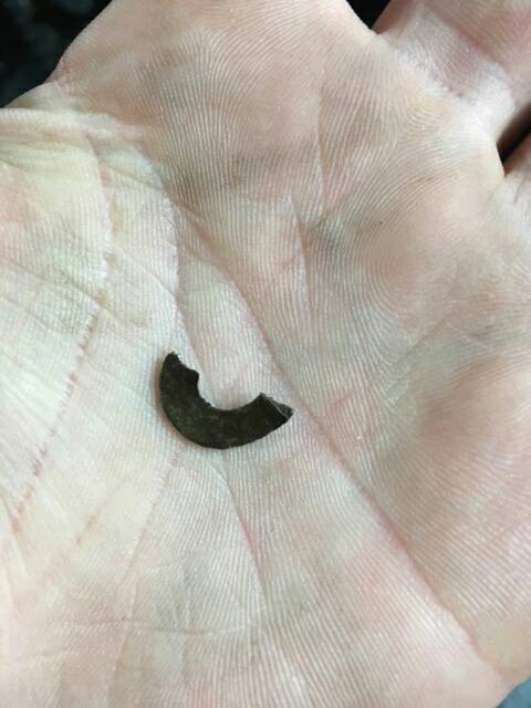

blobbish Posted January 26, 2016 Share Posted January 26, 2016 So the car is part way through the SC fitting and I asked the tuner to change the gaskets. Good job too as there started to break. Sent from my Nexus 6P using Tapatalk 1 Quote Link to comment Share on other sites More sharing options...

blobbish Posted February 4, 2016 Share Posted February 4, 2016 Do you mind sharing a ball park cost on this The gaskets are only £48 I'll ask tomorrow when I check progress on the SC. Sent from my Nexus 6P using Tapatalk Quote Link to comment Share on other sites More sharing options...
nissanman312 Posted February 4, 2016 Share Posted February 4, 2016 Do you mind sharing a ball park cost on this The gaskets are only £48 I'll ask tomorrow when I check progress on the SC. Sent from my Nexus 6P using Tapatalk Thanks Quote Link to comment Share on other sites More sharing options...
blobbish Posted February 5, 2016 Share Posted February 5, 2016 Do you mind sharing a ball park cost on this The gaskets are only £48 I'll ask tomorrow when I check progress on the SC. Sent from my Nexus 6P using Tapatalk Thanks Asked the question which I think you won't like. Cost of the gaskets £48 + roughly 6 hours labour. This is not something you just want to do unless your prepared. Glad I've changed mine though. Sent from my Nexus 6P using Tapatalk Quote Link to comment Share on other sites More sharing options...
nissanman312 Posted February 5, 2016 Share Posted February 5, 2016 Do you mind sharing a ball park cost on this The gaskets are only £48 I'll ask tomorrow when I check progress on the SC. Sent from my Nexus 6P using Tapatalk Thanks Asked the question which I think you won't like. Cost of the gaskets £48 + roughly 6 hours labour. This is not something you just want to do unless your prepared. Glad I've changed mine though. Sent from my Nexus 6P using Tapatalk Thanks mate Good to know for future reference I have ano oil presure gauge going in asap I'll take it from there Quote Link to comment Share on other sites More sharing options...
