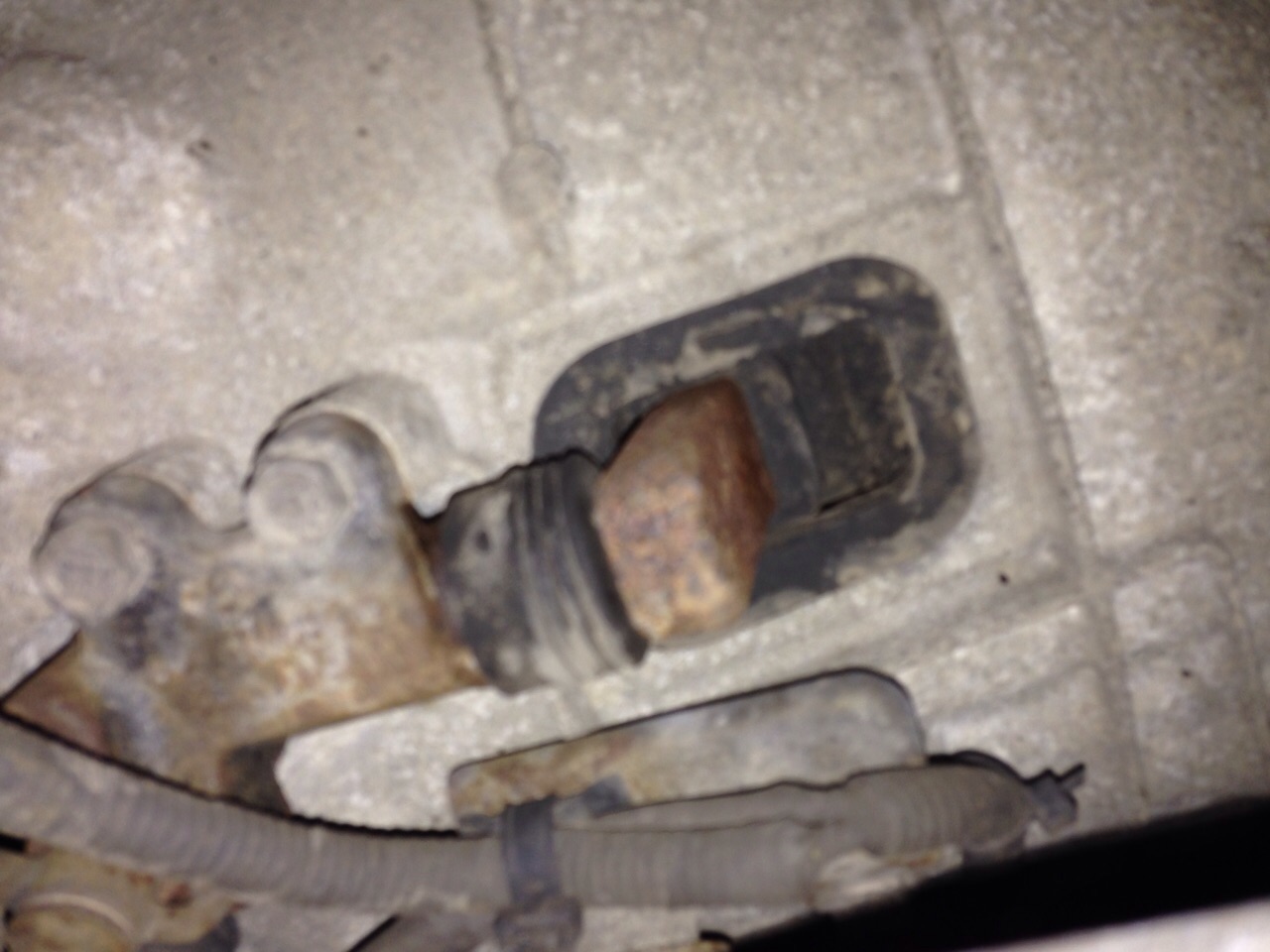

Well I found the culprit tonight after jacking the car up. It's a rod attached to the clutch going into the clutch housing.
I think I should be able to grease inside there once my grease arrives and hopefully that'll fix the issue.

Sorry, I've read so many different threads over the last few days I forgot who said what. Do you think I'll need a new bearing?
Fixed the squeaking yesterday :) .
At first I put some copper grease around the joint but it was difficult to see where to apply it and it didn't seem to work. Although some people have suggested it takes a couple of hours of driving for the joints to grease up.
Anyway, I gave it a spray with WD40 and after a couple of pumps of the clutch the squeaking was gone and the clutch is now much lighter :) .
Thanks for all the help everyone. I'll update after a few weeks of driving to see if the squeaking returns.

Where exactly did you spray? I'm having this exact issue and it's driving me insane!
Sorry I've only just seen this. There's a small rubber boot directly in the middle of the clutch housing underneath the car. You need to partially remove this and then spray the WD40 or grease directly up on to the metal joint. For me it was really dark and difficult to see anything but I sprayed the WD40 and after a few presses of the clutch the squeaking was gone.
Just to let everyone know the squeaking hasn't returned :)
