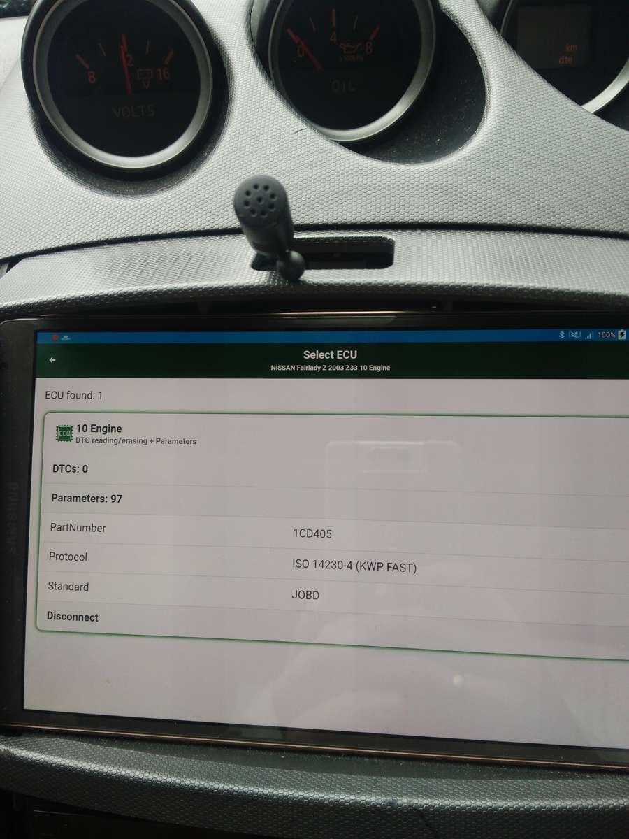

Sebastian Posted August 26, 2018 Share Posted August 26, 2018 Hello , been trying multiple WiFi, by OBD2 readers and finally got them to work on 350z JDM . Tried these expensive ones Obdlink LX, MX and cheap Amazon ones . Verdict : all work with different apps . Obdlink LX, MX scanner works with Car gauge Pro and Motor Data only.( Checked lots of different apps and these 2 apps successfuly established connection with ECU , while OEM app didn't find protocol and manually changed to right one didn't work. Cheap Amazon scanners do exactly the same job . Car Garage Pro - after installation tick Japan OBD and connect / Nissan/ECM Gasoline / engine 10. This should establish connection between ECU and scanner. MotorData - first thing after installation you need to create profile for nissan z33 ( it's free for testing, after successful connection you have to buy plugin for £4.99) and you ready to connect , app will automatically find right protocol. Both apps have all you need . Car Gauge Pro fast live readings and MotorData great for diagnosis , let's you fully understand codes and all warning light etc . Thanks. Quote Link to comment Share on other sites More sharing options...
