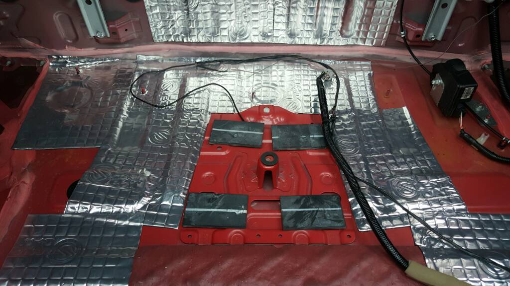

Kev T Posted May 12, 2015 Share Posted May 12, 2015 Fitted the reversing camera kit and decided to soundproof boot with 4mm silent coat ( cheaper than Dynamat ) at the same time, it has taken about 5/6 hours in total but i have been very reaxed about the job doing it over 3-4 days and i am going to put silent coat sound absorber foam inside the plastics before i refit them to maximise the effect. 1 Quote Link to comment Share on other sites More sharing options...

Kev T Posted May 13, 2015 Author Share Posted May 13, 2015 Silent coat bulk pack has 23 sheets and if you creatively use the off cuts it is just enough. Quote Link to comment Share on other sites More sharing options...

Stutopia Posted May 13, 2015 Share Posted May 13, 2015 Looks a neat job. How does it adhere? And did it feel like when it went in, it was in FOREVER? Quote Link to comment Share on other sites More sharing options...
Kev T Posted May 13, 2015 Author Share Posted May 13, 2015 Looks a neat job. How does it adhere? And did it feel like when it went in, it was in FOREVER? Once it is pressed in with a wallpaper roller, it's there forever ! Quote Link to comment Share on other sites More sharing options...

GreenLandy Posted May 14, 2015 Share Posted May 14, 2015 As a vibration damper, only 25% coverage is necessary... Still, can't knock a thorough job! Not sure how much effect that foam will have either tbh, it only really absorbs high frequency noise (not that much of which is in most cars), and it's main job is to act as an insulation layer between the vibration damper and a mass loaded barrier. Will be interested to hear the feedback though Quote Link to comment Share on other sites More sharing options...
Kev T Posted May 16, 2015 Author Share Posted May 16, 2015 We went for a drive for the first time tonight and both Gill and i agree the soundproofing has definitely helped queten the road noise etc. from the boot area, so all in all a worhtwhile job imho. 1 Quote Link to comment Share on other sites More sharing options...

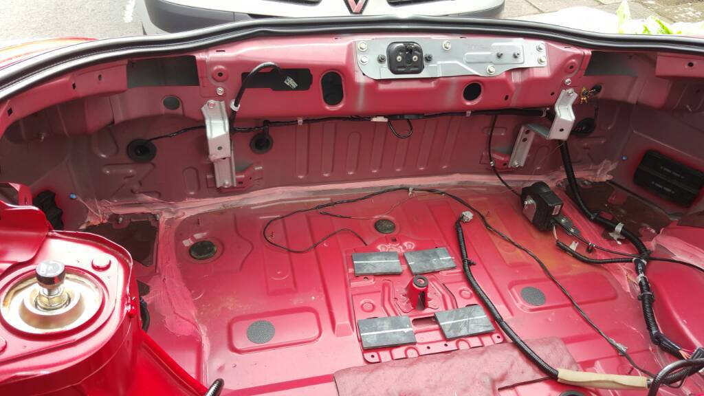

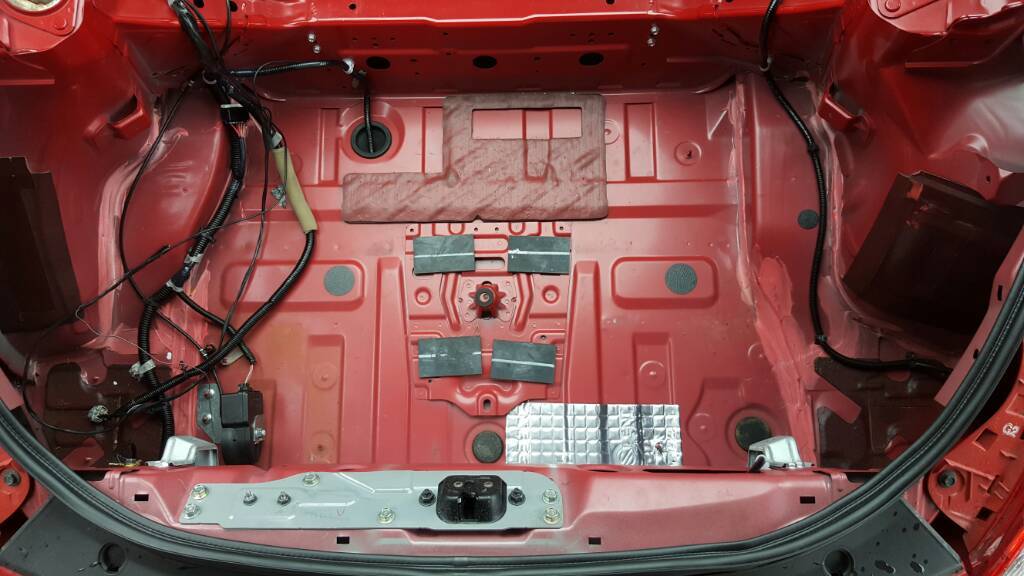

TGC-Z33 Posted March 2, 2016 Share Posted March 2, 2016 I did this last month with the same stuff, as the boot was already stopped when I bought the car. Road noise and exhaust vibration was terrible at 2000rpm , about 40% coverage made a massive difference. No boot vibration, I might apply some to the doors as suggested. Might post some pics tomorrow if anyone's interested. Sent from my SM-G925F using Tapatalk Quote Link to comment Share on other sites More sharing options...
TGC-Z33 Posted March 2, 2016 Share Posted March 2, 2016 Before and after, no more vibrations. Bought and refitted the standard interior after this. So much wasted space with the Bose sub and foam. I'll do Flyboys boot mod, with underlay and heat mould a carpet in place. A few other more important jobs to do first. Quote Link to comment Share on other sites More sharing options...
