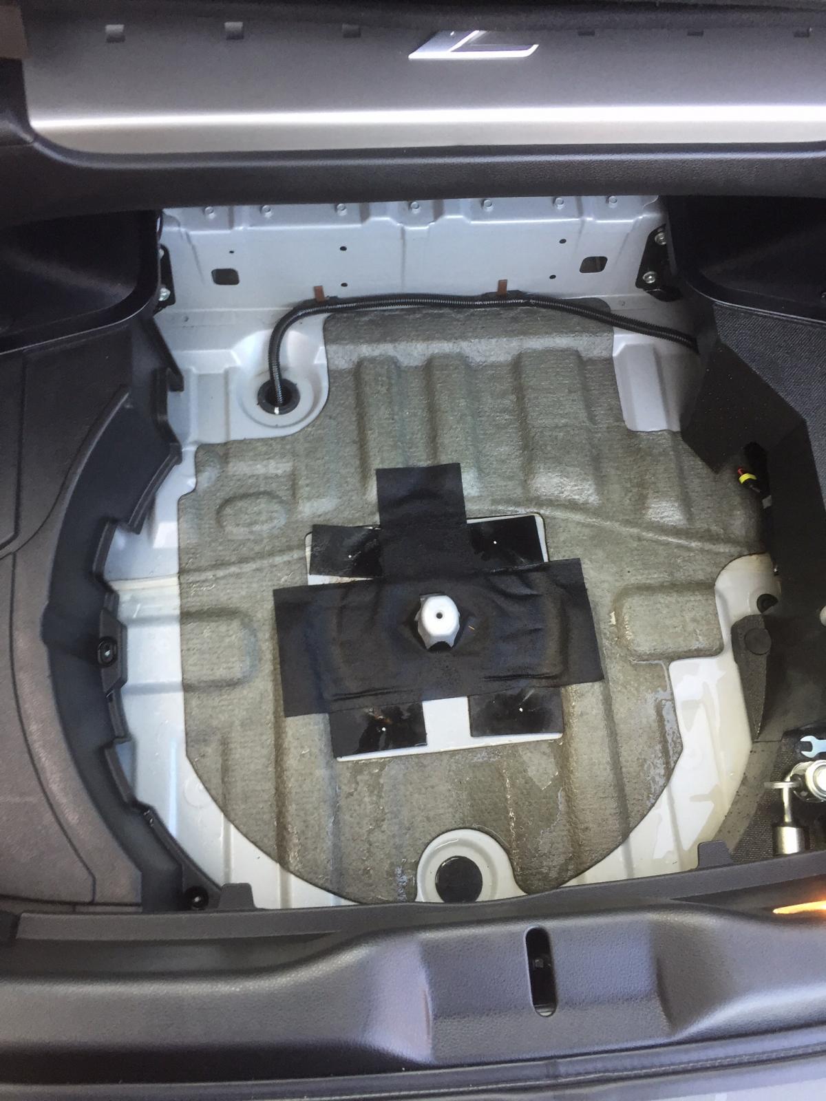

andy62 Posted March 31, 2015 Share Posted March 31, 2015 Hi, I'm new to this forum so please bare with me! I was hoping for some advise on where I need to be looking or how to remove appropriate panels. A couple of days ago I noticed a puddle of water where the spare tyre well is in the boot. The water is not on the carpet of the boot only the under area. I soaked all the water up to monitor it and today after heavy rain last night I have found more water within the area. I have took a photo of the area. Any advise will be much appreciated! Quote Link to comment Share on other sites More sharing options...
bigjackb Posted March 31, 2015 Share Posted March 31, 2015 I had the same problem when I first got my car and the problem was there is a small vent in the rear of each quarter panel. Take the foam out and have a look at them as one of the seals had failed. Zmanalex will be able to sort you out with one if this is the problem. Quote Link to comment Share on other sites More sharing options...

H1979 Posted March 31, 2015 Share Posted March 31, 2015 I had exactly the same thing after I picked mine up in November. Not sure if this is necessary but I removed most of the plastic trim starting with the two either side of the grey z panel to get the polystyrene type tool holder and amp cover thing out the way. I recommend the use of some plastic trim removing tools, a little brute force at times and plenty swearing helped a lot. I did break one clip, but super glue sorted that a treat. The vents are pretty cheap (£6 ish each), although I got them from the garage I bought the car as I noticed within a week. The seal that goes is a pretty sh1t material. Quote Link to comment Share on other sites More sharing options...

AndyG8nby Posted April 1, 2015 Share Posted April 1, 2015 I had the same thing, the gasket between the vent and rear quarter seemed to be made from a sponge like material as I could squeeze the water out of it. Quote Link to comment Share on other sites More sharing options...
veilside z Posted April 1, 2015 Share Posted April 1, 2015 Also check the rubber seal too, that goes around the boot lip, you could also get somebody small, into the boot space once stripped out and then spray the hose pipe around the various points. All should be revealed. Quote Link to comment Share on other sites More sharing options...

andy62 Posted April 4, 2015 Author Share Posted April 4, 2015 Hi all So finally got round to looking at my water leak and you were right! The problem was from the rear vent, the seal was completely broken. The other side was completely dry under the vent but the water was very visible on this one Tried ringing nissan but they are closed! Also because the vent was Renault I rang them but from the part number they said it was a boot plug... Which I wasn't confident in telling them to order. I also messaged the recommended member - Zmanalex So hopefully I will be able to source a replacement soon. Feel so relieved to have found the problem, couldn't have done it without the help of all you! Thanks again 3 Quote Link to comment Share on other sites More sharing options...
