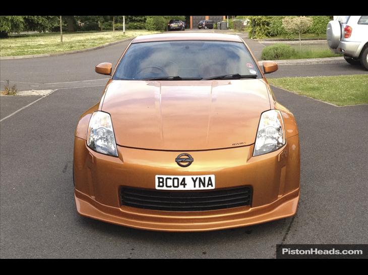

Hey all, after spending the week searching the web I've found a plate size im content with but there is no detail of the plate size. Firstly i apologise using a possible members photo.
Can anyone help me with working out the size so i can order one from demon plates.

easiest way would be to get a sheet of A4 and hold it to the front of the car. Mark it with the rough proportions you want then measure that. Print your reg onto a piece of paper so it fits those dimensions. If it looks good, order that size :lol:

Go onto a plate making website, write down the most common small sizes, draw the outline of them onto a piece of paper and compare :)
I'm struggling to see what you're after ... the photo shows a standard size plate with standard (legal) font ... Are you looking to get a plate that is smaller ? If so you'll have to tell us your registration and we can then work out what size your plate will be

Characters must be 79mm tall
Characters (except the number 1 or letter I) must be 50mm wide
The character stroke (the thickness of the black print) must be 14mm
The space between characters must be 11mm
The space between the age identifier and the random letters must be 33mm
The margins at the top, bottom and side of the plate must be 11mm
