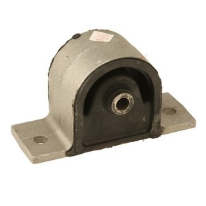

RobPhoboS Posted March 4, 2015 Share Posted March 4, 2015 Just so you know, the molyslip is probably worth plopping in for sure but most of the clunks come from the crappy transmission mount (and probably the diff bushings). I have a Torque Solution poly mount installed for the transmission, no clunks, no odd feeling going from 1-2 & 5-6 like it did before and a far more direct, positive shift. The downside is the transmission noise that's amplified into the cabin but it doesn't bother me. Jez at H-dev sells some Hardrace rubber parts which I probably should have gone with tbh. http://www.h-dev.co.uk/product_info.php?products_id=25700 (transmission mount) http://www.h-dev.co.uk/product_info.php?products_id=25701 (engine & transmission mount) Quote Link to comment Share on other sites More sharing options...

RobPhoboS Posted March 5, 2015 Share Posted March 5, 2015 (edited) £338 for three mounts You only need the first one imho (specifically for the gear changing feeling). My poly mount was £84 inc postage etc from the US but it's a bit noisy, the hardrace one won't be. Look at the difference: Easy to install: Edited March 5, 2015 by RobPhoboS 2 Quote Link to comment Share on other sites More sharing options...
