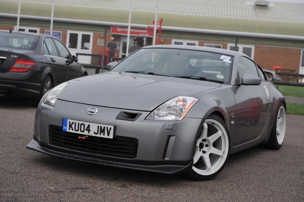

adab Posted February 24, 2015 Share Posted February 24, 2015 (edited) Hi guys, Hopefully one or more of you may be able to assist! Cars in the garage having BC coilovers fitted with host of other bits and will then have a full geo setup. Mechanic sets up mx5 race cars and has a Hunter 4 wheel alignment system. He's just asked me to ask you............ as many will have been through the process. Car to be set up for trackday use, Whats the best set-up to try for camber and toe in front and rear? She is sitting on 19" rota grids. Probably many different answers but any help from the tried and tested would be appreciated and forwarded on. Thanks in anticipation.. Edited February 24, 2015 by adab Quote Link to comment Share on other sites More sharing options...
philw99 Posted February 24, 2015 Share Posted February 24, 2015 This is mine mate Also got BC coilovers fitted, feels really good on the track. Wheels are 18s Sent from my iPad using Tapatalk 2 Quote Link to comment Share on other sites More sharing options...

Ekona Posted February 24, 2015 Share Posted February 24, 2015 I'd go with Phil's numbers, they're pretty decent although I'd personally run with a bit more toe out at the front (5deg either side), but that really is just my preference. That's a really solid base to work from to figure out what you're after, thanks for posting Phil What settings do you run your BCs at, Adab? I had a play with some on a Zed recently, I think I settled around 10 from hard on the front and 14 from hard on the rear, but that was for road use. I'll have to check on those numbers, but I think they were around there. Quote Link to comment Share on other sites More sharing options...

GT4 Zed Posted February 24, 2015 Share Posted February 24, 2015 I would agree with Dan on this as a good base to start with as setup is such an individual thing based on how you like your car to behave but in general the zed certainly needs toe out(-0.05-0.5deg) in front and more positive caster(9-10deg) and negative camber(-ve 2 - 3.5deg. At the rear I feel 1.75-2deg negative camber is optimum anything more is counter productive imho. You need toe in at the rear. You can increase or reduce this to in high speed stability or understeer or vice versa if you want to encourage twitchiness/oversteer or ease of rotation. Ultimately you are limited by how much adjustability you have up front and the type of tyre you are using and how much trade off tyre wear against handling you are prepared to make. Goodluck. Quote Link to comment Share on other sites More sharing options...
