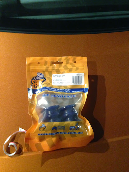

S14DST Posted February 26, 2015 Author Share Posted February 26, 2015 (edited) Finally today I received and installed my superpro poly rear sway bar bushes and new drop links! It made a noticeable difference, because before I was able to move arb by hand, so there wasn't actually a point of it Sorry for crappy phone pic... https://lh6.googleus...9M=w415-h553-no Unfortunately for some reason I can't upload pictures from my google+ account! Edited February 26, 2015 by S14DST Quote Link to comment Share on other sites More sharing options...
