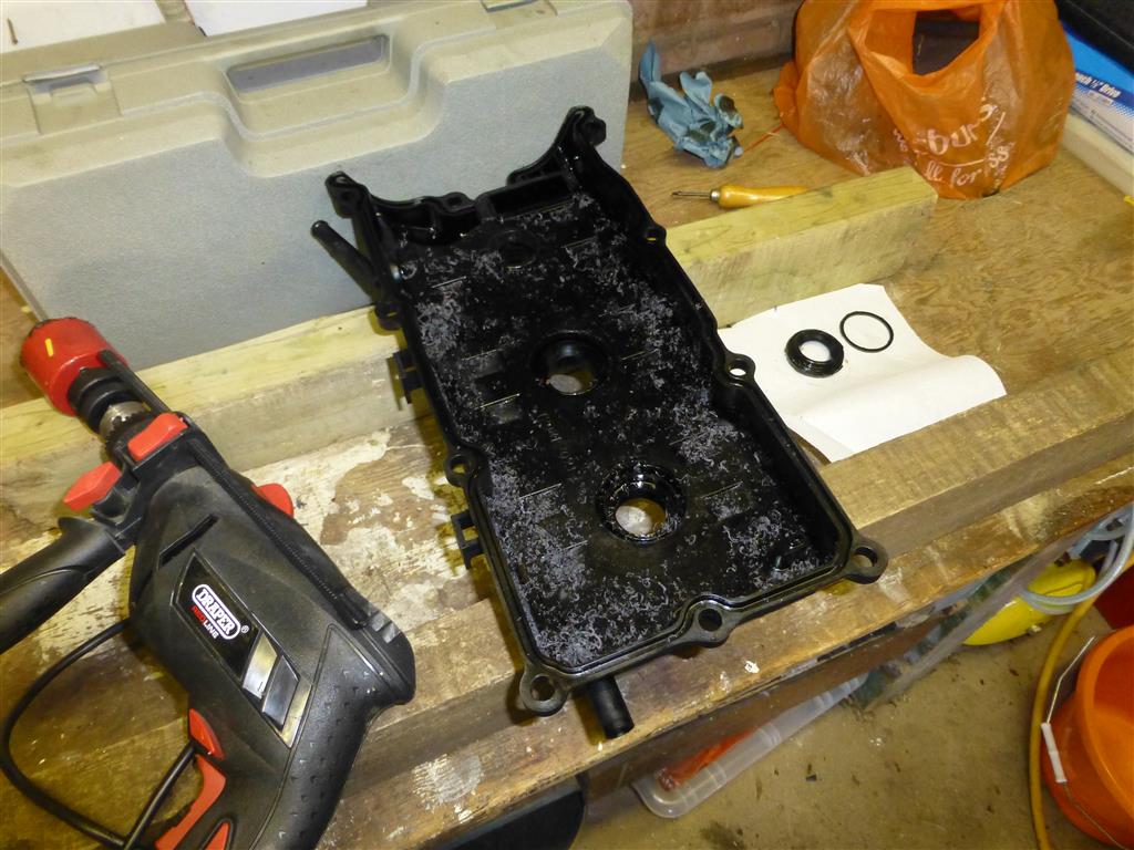

thedon Posted April 26, 2015 Share Posted April 26, 2015 Well, all back together again and amazingly the car still works Once I'd got the right cover past the tight bracket it all went back together again with no dramas. Oil pressure good and it drives well. Will check for any oil drips in the morning but praying there are none - I really don't fancy stripping it back down again just yet. I've attached a picture that shows how not to let the waste plastic build up (it's a pig to flush it all out again). For anyone about to attempt the job you can also see the ring of plastic that you drill out from the baffle, letting you pry up the existing grommet. Good luck! 1 Quote Link to comment Share on other sites More sharing options...
