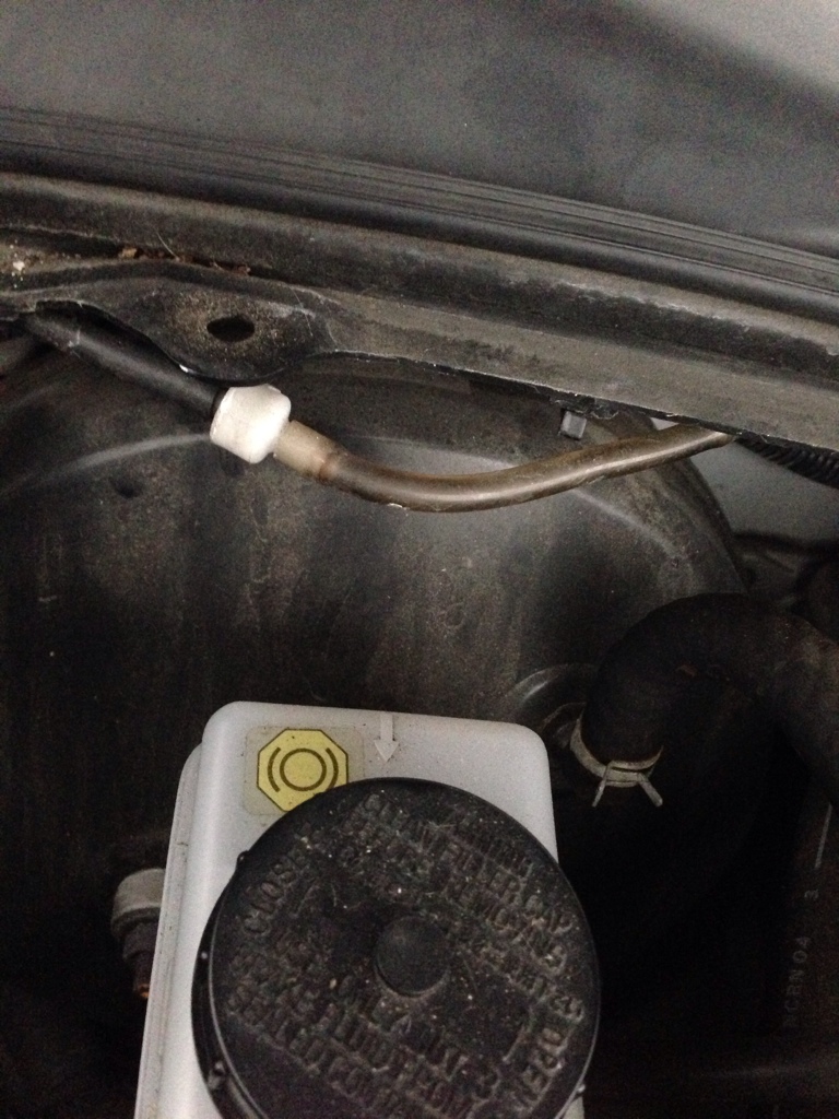

GMballistic Posted February 7, 2015 Share Posted February 7, 2015 Fyi ~ You can get at the non return valve from inside the brake fluid/clutch fluid compartment on the drivers side. You can pull the windscreen washer jet hose from under the windscreen scuttle (it just clips in under it) and you should see a small black or white plastic piece. Will look like this most likely.... Gently pull the pipes apart (if it's tight use a hairdryer to warm it up & a twisting motion to separate) then with the pipe off away from the non return valve try your washer for the front. You should see a fairly decent amount of water coming out of the end with the non return valve removed. Then you could try doing the same again with the non return valve put back on the end, ...if the amount of water is not as good as it was then that's the problem. Personally I'd just remove the non return valve altogether and replace with a straight piece of tube. It made my washer jets so much more powerful and it really isn't needed as the washer fluid usually stays in the pipes anyway. Think it will be a 4mm or 5mm straight through pipe you will need to replace it ~ something like this: http://www.ebay.co.uk/itm/2x-4mm-Vacuum-Hose-Connectors-Plastic-Hose-Joints-Tefen-Blue-Ramair-/350772405492?pt=LH_DefaultDomain_3&hash=item51abaa24f4 1 Quote Link to comment Share on other sites More sharing options...

88sam88 Posted February 7, 2015 Author Share Posted February 7, 2015 Also just noticed you said the back isn't working either but you can hear the motor going. I know there is a non return valve for that one as well but not sure where that is sorry. The non return valve for the rear may have failed too or could even be a pipe come off or could just be blocked so I'd try to get the fronts fixed first then investigate the rear one further. One problem at a time as they say. Yea I'll solve one at a time first 😄👠My guess is the white part is the non return valve ? Quote Link to comment Share on other sites More sharing options...
GMballistic Posted February 7, 2015 Share Posted February 7, 2015 Also just noticed you said the back isn't working either but you can hear the motor going. I know there is a non return valve for that one as well but not sure where that is sorry. The non return valve for the rear may have failed too or could even be a pipe come off or could just be blocked so I'd try to get the fronts fixed first then investigate the rear one further. One problem at a time as they say. Yea I'll solve one at a time first í ½í¸„í ½í± My guess is the white part is the non return valve ? Yes you're right that's it. Let us know how you get on. Quote Link to comment Share on other sites More sharing options...
