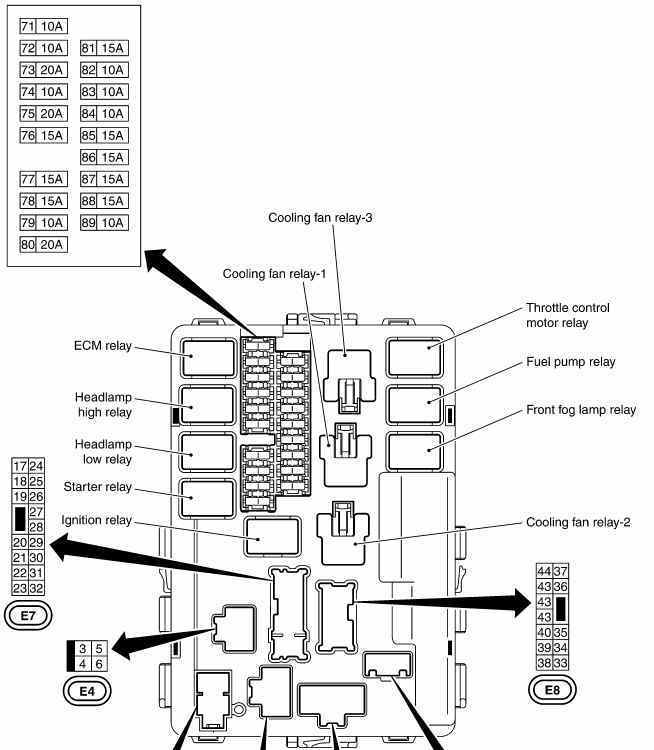

Scully Posted January 22, 2015 Author Share Posted January 22, 2015 I don't think the engine has seized but I'll try and turn it over by hand, I guess it's just a case of getting a wrench on the crack? No warning lights of any kind On the electrical side the 40A fuse infront of the battery and the 15A behind are fine, just need to find a diagram to show which relay is ignition. Quote Link to comment Share on other sites More sharing options...
GIXXERUK Posted January 22, 2015 Share Posted January 22, 2015 Quote Link to comment Share on other sites More sharing options...
Scully Posted January 22, 2015 Author Share Posted January 22, 2015 Cheers that's the diagram I found too Relay tested ok Quote Link to comment Share on other sites More sharing options...
