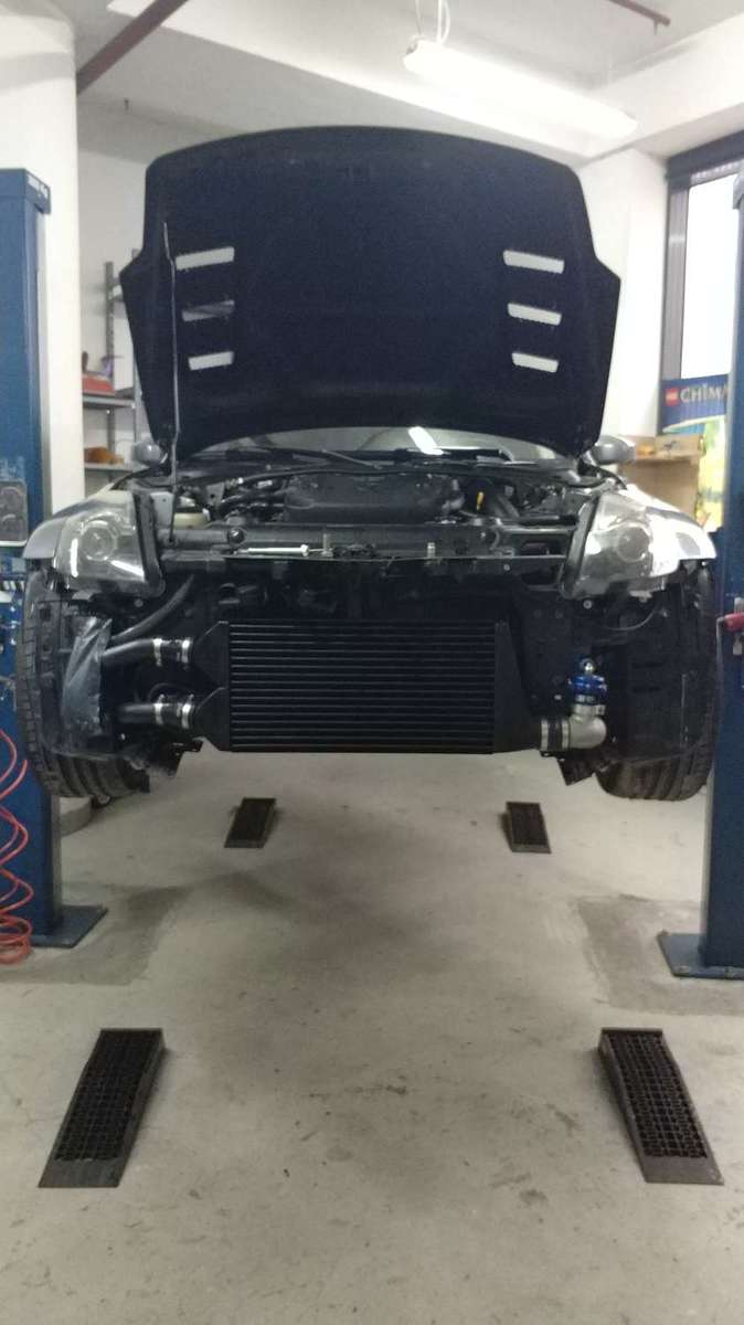

Snjur Posted January 27, 2018 Author Share Posted January 27, 2018 Stealth look completed! Quick photo as I need to clean bit engine bay before a proper picture. Remains to replace blue silicone hose from radiator to expansion jar to complete all black look. Strut bar as well as new intake aluminium pipe have been powder coated in black. I think to an amateur and untrained eye it is hard to notice any changes inside engine bay. Once all properly cleaned it will look almost like OEM Just a few revs with new camshafts and car feels completely different on throttle than with OEM cam. Since we still didn't tuned the car on dyno I haven't tested it aside of reving it. But Rpm needle is jumping much faster with this cams and throttle is reacting instantly on touch. Cant wait to hit the dyno and test acceleration and behaviour of the car VID_20180127_164320.mp4 2 Quote Link to comment Share on other sites More sharing options...

Snjur Posted February 4, 2018 Author Share Posted February 4, 2018 (edited) 2 hours ago, EzeePzee said: Looking good and very stealth engine bay! :-) Thanks It was my aim to keep all clean and as much as possible OEM. Few bits remain to round up all. 1 OCC mount i need to paint in black. But now is all about minor details. Once i complete all i will make a proper cleaning with degreaser and high pressure wash and make few pics Edited February 4, 2018 by Snjur 1 Quote Link to comment Share on other sites More sharing options...
Snjur Posted February 6, 2018 Author Share Posted February 6, 2018 (edited) Completed air filter replacement. I went with KN RC9980 and they fit perfectly. Greddy IC painted in black and degreased Ready for dyno Edited February 6, 2018 by Snjur 1 Quote Link to comment Share on other sites More sharing options...
