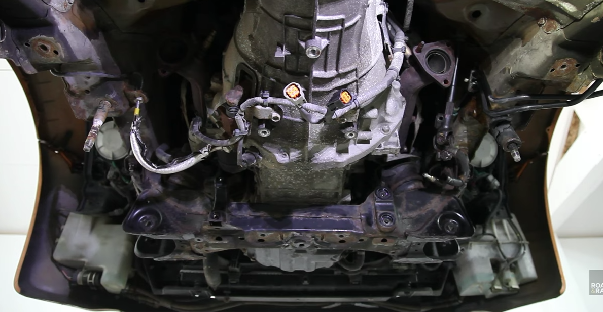

SHEZZA Posted January 10, 2021 Author Share Posted January 10, 2021 (edited) Well not updated this for a while ! The poor old zeds not seen much action having only covered around 500 miles in the last year due to having now brought the house we’ve been renting and working on that. Oh and of course COVID and not being able to attend any shows/meets. She’s had two services since I last updated this. Some new LED sequential side repeaters as one was split and letting water in. I’ve also had to replace the windscreen washer pump as that had failed prior to its last MOT back in September. You can get at the pump by removing the inner arch liner without removing the wheel, but I did as it is a lot easier, especially when fitting the new pump as it’s a two hand job really. There’s two washer bottles on the 350z one each side and I always thought that one was for the rear and one for the the front. But as every day is a school day and what I now no is. The one the passenger side is for the headlight washers with its own pump and the one on the drivers side has two separate pumps for front and rear. With the pump which I needed to replace on the right for the front windscreen Old pump versus new and some nice new MOTUL screen wash, just because. Cheers opieoils for supplying that. Edited January 10, 2021 by SHEZZA 2 Quote Link to comment Share on other sites More sharing options...

davey_83 Posted January 11, 2021 Share Posted January 11, 2021 I'm confused On 18/03/2016 at 20:46, ZMANALEX said: BluePrint Nissan 350Z rear washer pump motor: Part n# ADN10316 BluePrint Nissan 350Z front washer pump motor: Part n# ADN10315 Good to know. How can the one pump with one outlet serve for both front and rear jets? Quote Link to comment Share on other sites More sharing options...
Olly350z Posted January 11, 2021 Share Posted January 11, 2021 7 hours ago, davey_83 said: I'm confused How can the one pump with one outlet serve for both front and rear jets? Some washer motors are valved, the new Jazz as an example. One motor on the bottle that does front and rear, bit of a pain in the backside to be honest as they're far too delicate 1 Quote Link to comment Share on other sites More sharing options...
davey_83 Posted January 14, 2021 Share Posted January 14, 2021 And yet interestingly the Z had two washer tanks, one for the front and rear screens and one for the headlights. I also spot x3 pumps, Jap cars ay. Quote Link to comment Share on other sites More sharing options...
