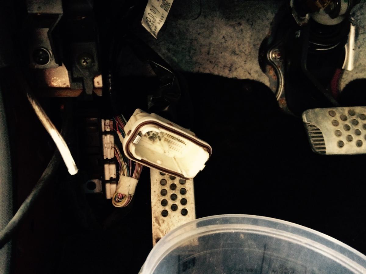

cakesson Posted November 25, 2014 Share Posted November 25, 2014 Hi guys, I just got a disassembled 350z (newly painted) and I´m putting it together. However I have this pretty big connector under the steering wheel by the pedals, do you know what should be there? My power windows and central locking isn´t working and airbag light is flashing so I guess it could be something for these functions that I´m missing, like a module of some sort? Quote Link to comment Share on other sites More sharing options...

cakesson Posted November 25, 2014 Author Share Posted November 25, 2014 I can tell you its nothing to do with the sound system, steering wheel controls or air con unit. Other than that.....not a clue Thanks, all those things are working so I´m thinking it might be something with power windows or locks... anyone?Nissan here has no idea, he ordered the schematics for the car and will contact me when he gets it.. :S Quote Link to comment Share on other sites More sharing options...

zebedy Posted November 25, 2014 Share Posted November 25, 2014 is it where you would plug in your code reader??? Quote Link to comment Share on other sites More sharing options...
gumpy000 Posted November 25, 2014 Share Posted November 25, 2014 (edited) Exactly. It's where they plug in the diagnostic equipment. Nothing to worry about. Welcome n Enjoy! Edited November 25, 2014 by gumpy000 Quote Link to comment Share on other sites More sharing options...
BulletMagnet Posted November 25, 2014 Share Posted November 25, 2014 Not the code reader port. It's the connector that goes to the door jam and then the door wiring loom plugs into that. I only know because I ran new speaker wires to my door speakers and had to go through this. Hope you have small hands or willing wife/child to help you as it really is a snug fit 1 Quote Link to comment Share on other sites More sharing options...
cakesson Posted November 25, 2014 Author Share Posted November 25, 2014 Not the code reader port. It's the connector that goes to the door jam and then the door wiring loom plugs into that. I only know because I ran new speaker wires to my door speakers and had to go through this. Hope you have small hands or willing wife/child to help you as it really is a snug fit Yes I don´t think it´s the diagnostic since the diag is to the right side close to your right knee when driving? Your explanation sounds about right since the buttons for door window operation and central locking isn´t working and the car has been repainted (disassembled). I will look deeper into this when I have a garage space and light / heat :-) Quote Link to comment Share on other sites More sharing options...
