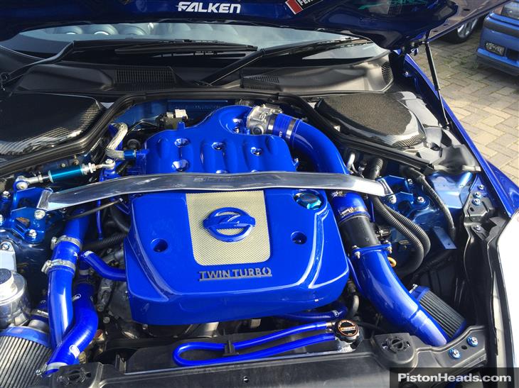

Keyser Posted November 24, 2014 Share Posted November 24, 2014 Along Ref 3 - The Haltech - I had the Haltech piggy back on my SC Zed - if the stock ECU throws a CEL the Haltech won't stop it, I used to get the lamda sensor warning due to the SC and De- Cats I had an uprev license put on the stock ECU this allowed us to disable the warnings and remove the 155mph speed limiter. Hope it helps Quote Link to comment Share on other sites More sharing options...

brians25 Posted November 24, 2014 Author Share Posted November 24, 2014 excellent, the uprev licence sounds like a thought as i currently have a bluetooth obd2 adapter plugged in running Torque on my mobile to reset the code when it comes up, its always the same code, powertrain to rich due to the mapping of the car having the twins on it. and probably the decat. Thanks again for all the help , much appreciated guys. Quote Link to comment Share on other sites More sharing options...

brians25 Posted November 24, 2014 Author Share Posted November 24, 2014 Yeah the turbos are a lovely addition, i was looking for a turbo one for some time, and went for this one as soon as i saw it, the dished rims are like new and totally set the car off in the flesh, Also with low and high boost settings you can pootle around with 343 bhp until you need more and press the high boost along with the loud pedal. I would recommend the turbo setup to anyone looking for more grunt, i have driven a few without the twins and its quite a different feeling. Quote Link to comment Share on other sites More sharing options...
