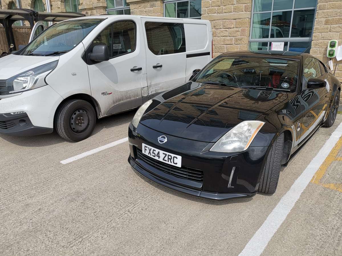

In not so good news this week (yesterday) , my zed got bumped by a contractor's van whilst I wan at work in works carpark. Lucky he did the honourable thing by not running away and went to reception to look for me. Exchanged details and I've started the insurance process. I tempted to sort it out outside of insurance but the guy insisted to claim it via insurance. My concern is insurance company writing my car off due to repair cost more than certain percentage of my zed's book value. Evaluation engineer is coming over next week Tuesday to assess the damage. Hopefully not a write off. I'll very likely to buy it back of they write it off.
He (white van :bang::surrender:) parked next to me, drove out of the spot and hit my front right. I assumed he wasn't looking and aware my zed is next to his! I parked there before he does hence no excuse of not noticing me :scare: anyway, damage is done and he's very apologetic. My wheels actually moved as a result of this impact (I had my wheels straight, parallel to rear wheels when i left the car, image below shows the movement). Checked all the mechanism n tracking this morning at L&G and been given the all good, phew.... I also have to postpone my time at bodyshop as I've booked my zed in for rear and front driver side rust on the arches sorted.

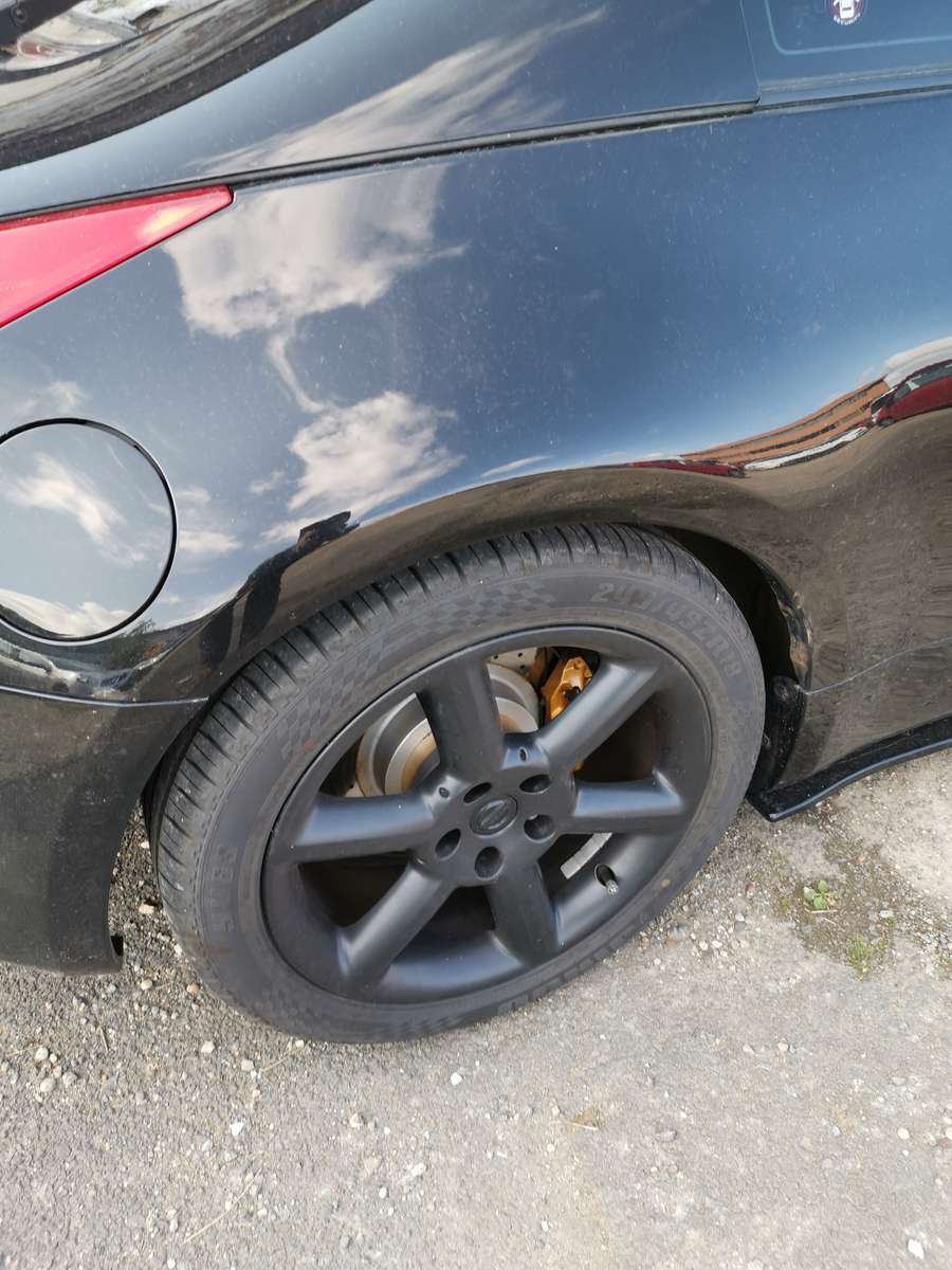

Sorry to see this veeg. On the plus side you’ll get the front wing sorted on the insurance ! I’d want a complete new wing to totally prevent the return of any rust.
Yep, if they can get a new wing. Else when they fix that, they'll need to sort out the rust too as the accident damage is just around 4cm away.

In another news, my rear driver arch is now sorted, no more rust and full of wax B)

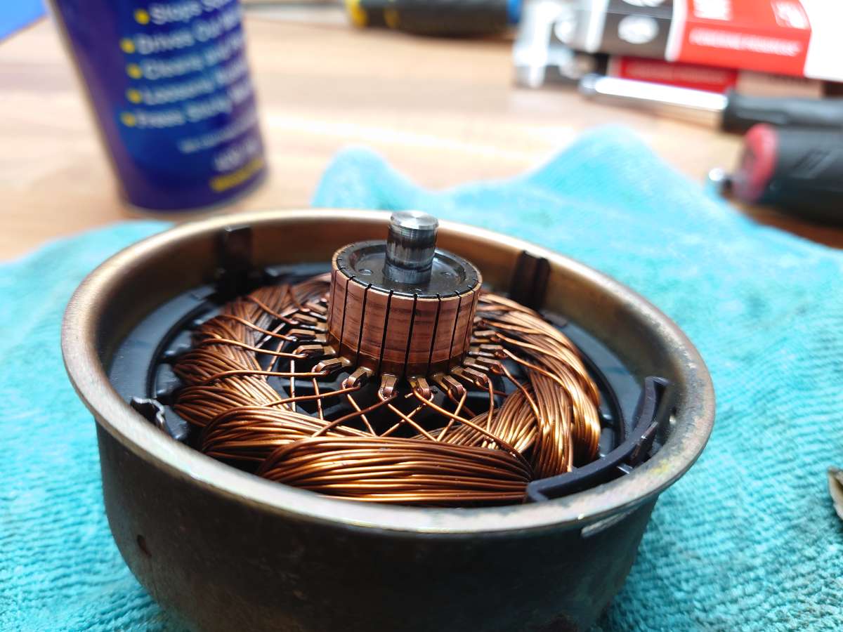

Upon opening up the motor, I found all them 'carbon tabs' (not sure what's the actual name' are sticked within the slider. I'm not a motor expert but just some knowledge of how motor works. The spring should be pushing the 'tabs' onto the rotor. I have to push them out with a little screwdriver. I noticed the carbon tabs have split in the middle hence I guess why it is not clearing the housing and allowing the spring to push them.
Lucky them tabs are pretty easy to sand, just a quick two to three passes with the sand paper gives it enough clearance. Did the same on all 4 tabs, some contact cleaner to clean it up. Next I clean the rotor, full of carbon deposit on it, just some sand paper and again contact cleaner at the end.
A bit of hammer action to seal the motor assembly back. Reassembled them on the the cage and back into the zed for a test. Again, I'm using the auto test to check them fans........😎 Success, both fans working great, both Hi and Lo fans are working.
