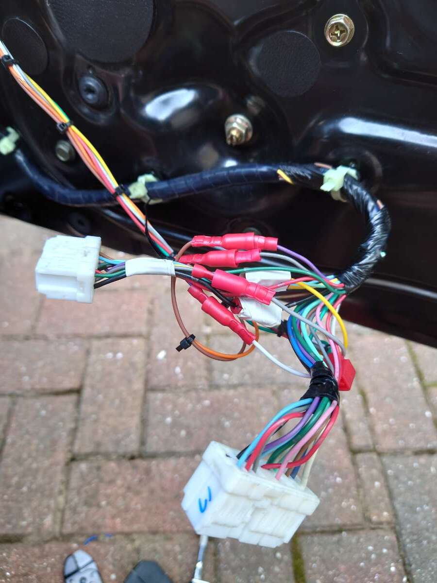

veeg33 Posted August 25, 2021 Author Share Posted August 25, 2021 After 4 yrs or so sat in the garage cupboard, I've finally printed out the installation instructions. Took 20mins or so to install, but 30mins to figure out what's going. Everything works great when I first tested it, both connectors plugged in without door card assembled. Removed both connectors to put the door card back on, assemble everything back on.....you guessed it 🤦🏻♂️ everything stopped working. Could not figure out what's going on. Thought the fuse has blown, checked and it wasn't. Removed the fuse and replace again, the module works again. Hence decided to hook the door card back on loosely, plug in both connectors, remove and replace the fuse.....test and it works again. Moved the door card to assemble everything again....🤦🏻♂️ Doesn't work again. Removed everything to check all connections, found one of power cable came of the Scotchlok 🤦🏻♂️ repaired it, repeat the same assembly method again but being extra careful not to pull any cables put. Success! Loved the auto fold when I lock the car, but the only down side is I have to wait for the mirrors to fully open first when I turn key to 'On' position before cranking up the engine, else the mirror will stop unfolding and will have to manually press the window button to unfold it completely. I went cable tie happy ensuring everything is tidy. Quote Link to comment Share on other sites More sharing options...

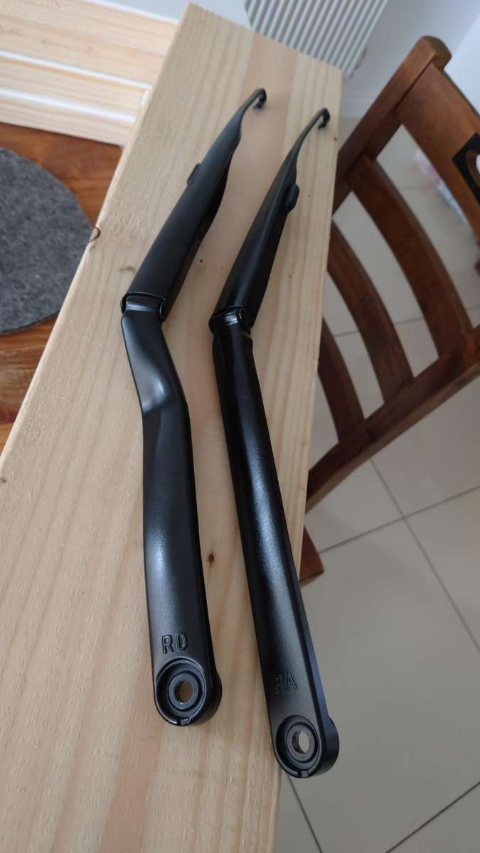

veeg33 Posted June 3, 2022 Author Share Posted June 3, 2022 Finally found some time to sort out the wiper arms, thanks to the Queen. Arms removal was pretty easy and straight forward, took me 5mins or less to remove both. Took them water nozzles out, masking tape on the main hole and spring. Sand it down and peel off as much original paint as I can. Wash with soapy water, and dry before 3 coats of primer and 4 coats of satin black paint. Let it completely dry for 24hrs before going back on the zed. Added grease to the shaft as well whilst they are out to make it easier to remove in future. Turn out pretty good. 3 Quote Link to comment Share on other sites More sharing options...
davey_83 Posted June 4, 2022 Share Posted June 4, 2022 Much better, nice job sorted!!! 1 Quote Link to comment Share on other sites More sharing options...

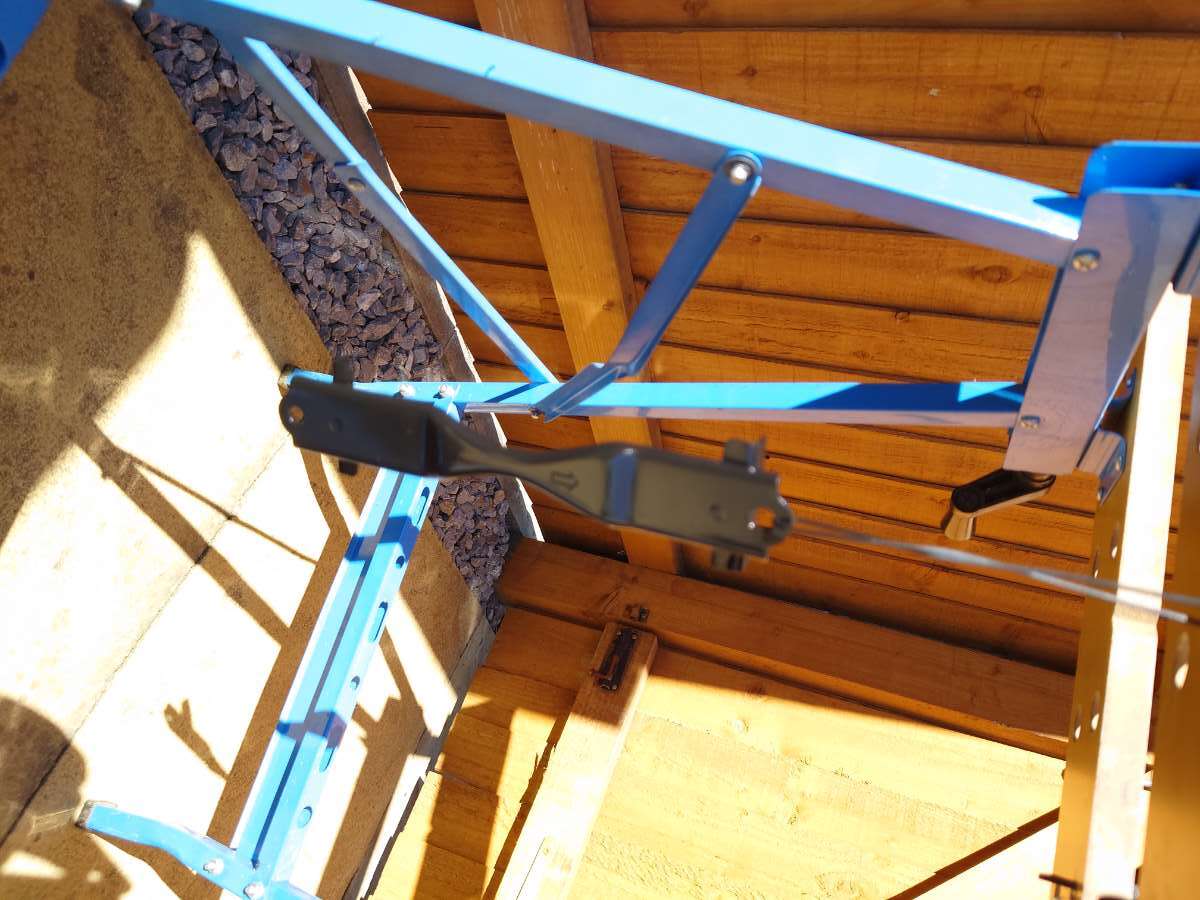

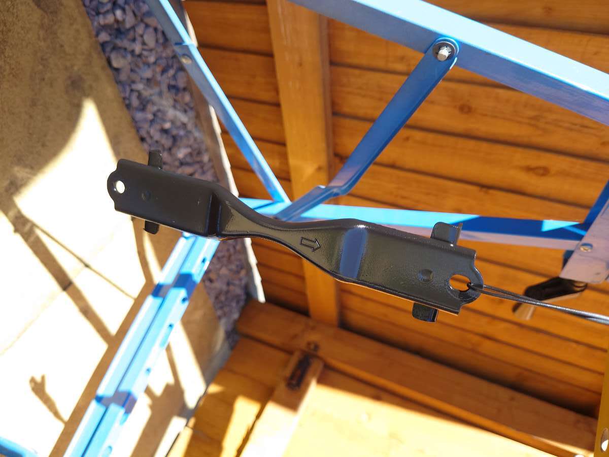

veeg33 Posted August 2, 2022 Author Share Posted August 2, 2022 Whilst I change a new battery, why not refurb the battery brace as well since I have spare primer and black spray paint left from wiper job. Quote Link to comment Share on other sites More sharing options...
