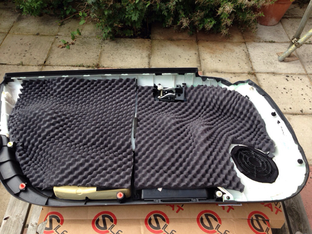

Huge improvements made. Only focused on the doors this weekend. Applied a complete covering of silent coat absorber 35 to the door cards with cut outs for the door handle mechanism and speaker area. This has massively reduced mid and bass resonance in the door and it's now almost entirely eliminated, certainly no need to anything further. If you choose to do this don't forget to make some holes for the screws holding the door card to the door, the plastic trim plugs and the cabling for window controls. I also applied a patch of Dodo Liner Closed Cell Foam 6x8 inches behind the speaker on the Dynamat coated outer door skin for good measure.

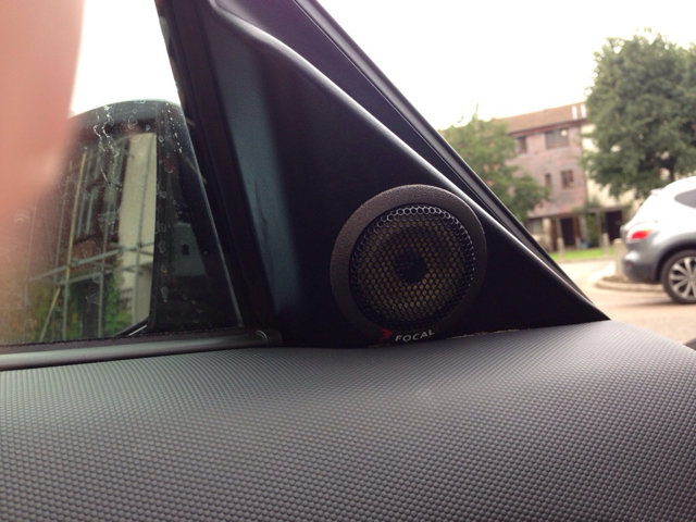

I also cut 45mm holes in the door sails so I could mount the tweeter properly. Did this using a 44mm ringsaw bit and a bit of dremmel to expand the hole slightly, checking with the tweeter as I went so as to make a good fit. The tweeters just pushed into the hole with a bit of force and certainly don't need any kind of fixing to hold in place.
Imaging and high frequencies now hugely improved. Very satisfying! I'm now getting the quality I had hoped for when forking out for the original installation. Finally getting to appreciate how good the Focal 165 KRs are. Only thing missing now is real bass....
