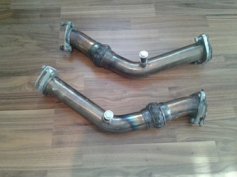

jocke-j Posted September 17, 2014 Author Share Posted September 17, 2014 Collection of parts for 2015: Oilcooler, decats, supercharger Okay guys and girls. i will add some more parts i have collected to be fitted to the car. Oilcooler: First of, after reading about the Vq35de engine and my own experience from the Nurburgring the stock oilcapacity and cooling of the oil is poor during sporty driving. So i have invested in an Stillen oil cooler kit for the 350z, its include everything needed to be mounting it on the 350z. the oilcooler is an Setrab oilcooler. I might have to modify the kit somewhat due to going to run a front mounted intercooler but more about that later on. Decats: I like the stock exhaust but when going supercharged and maybe running abit on the rich-side with fuel for safety this will be bad for the Catalytic converters so will just have them on MOT-Days, and i have bought some used Japspeed decats with Cel-fix included that i will use. The plus side is that i have read people gain around 8-10whp with this mod alone. Supercharger: I have bought a used procharger kit. Have some diffrent pulley sizes but will go with stock 7psi boost setting, Im not looking for crazy power just around +100whp, as the zed should have been built from the first place. but when everything is mounted i will dyno the car for a more exact hp-figure. Will not be using the stock fuelkit that came with the procharger kit, due to it not beeing able to change timing = knocking = possible engine failure. I will go down a diffrent path but more about that later. I still have some more things to get until the parts for the modlist for 2015 is finnished. thats all for this time. Please leave comment, its motivates me to post more 1 Quote Link to comment Share on other sites More sharing options...

jocke-j Posted September 19, 2014 Author Share Posted September 19, 2014 (edited) GMBallastic: That is so true. my first plan was to wait and fit everything during the early month of 2015, but might put the decats on next weekend. so i can go out and drive in the tunnels. Someone know of any good mounting guide/how too to fit decats? Edited September 19, 2014 by jocke-j Quote Link to comment Share on other sites More sharing options...
GMballistic Posted September 19, 2014 Share Posted September 19, 2014 GMBallastic: That is so true. my first plan was to wait and fit everything during the early month of 2015, but might put the decats on next weekend. so i can go out and drive in the tunnels. Someone know of any good mounting guide/how too to fit decats? Found this one for you; http://www.350z-uk.com/topic/150-diy-kinetix-hi-flow-cats-diy-install-guide/ It's actually for fitting HFC's but same procedure pretty much. Good luck. Quote Link to comment Share on other sites More sharing options...
