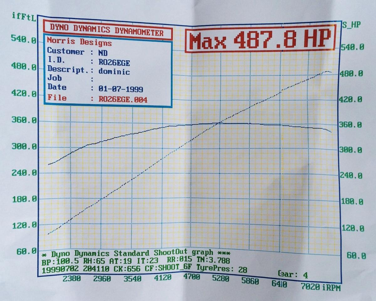

dajw Posted August 4, 2014 Author Share Posted August 4, 2014 Dose the car still feel controllable or is it just wild I'm seriously keen on this It is as controllable as the normal car. That's one of the reasons I chose my kit, you want crazy power, drop two cogs! You want to potter about, drive normally. Love it! Look at the power and torque (attached). Torque rises slowly then flat from about 4.5k, Power is a lovely straight line. This is slightly different from the 'normal' tune that you buy direct from Stillen. That's a turnkey install based around the 8 lb pulley. My tune is specific to the 9lb pulley on V-Power. Talk to Simon at Norris Designs for info. I'm pretty sure you could get the Stillen kit + 9lb pulley. I went for a decat but this would be very similar with a Berk HFC from what I understand. Quote Link to comment Share on other sites More sharing options...

Suits Posted August 5, 2014 Share Posted August 5, 2014 Hey man, top car you got here, those graph curves are awesomely smooth, great peak torque too . How do you find your oil temps now that you're boosted, I may have missed it but did you get an oil cooler ?? Quote Link to comment Share on other sites More sharing options...
