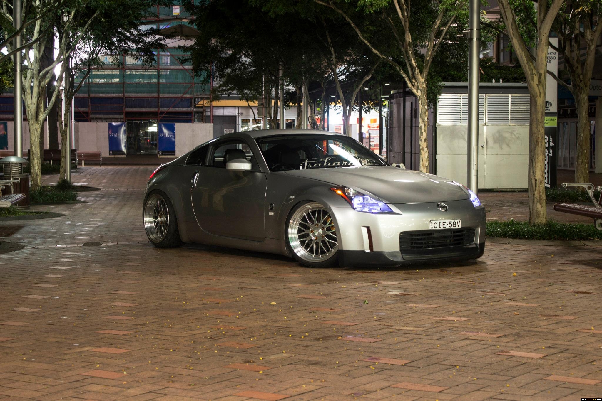

docwra Posted July 24, 2014 Share Posted July 24, 2014 15mm is a roll and a slight flare, or if youre on coilovers another degree of camber and a bit of stretch. See, this man has a 9.5 ET0 which is clearing his Brembos, hes running a 225 tyre at 2 degs camber up front on a rolled/slight pulled arch. Even as a massive wheel whore, downgrading brakes to fit wheels is not an option. The other option is a wider front fender, youd only need a +15 but I cant find any in the UK - Knight Racer used to do them though ......... Quote Link to comment Share on other sites More sharing options...
StevoD Posted July 24, 2014 Share Posted July 24, 2014 15mm is a roll and a slight flare, or if youre on coilovers another degree of camber and a bit of stretch. See, this man has a 9.5 ET0 which is clearing his Brembos, hes running a 225 tyre at 2 degs camber up front on a rolled/slight pulled arch. Even as a massive wheel whore, downgrading brakes to fit wheels is not an option. The other option is a wider front fender, youd only need a +15 but I cant find any in the UK - Knight Racer used to do them though ......... Id rather stick a toilet brush up my arse than use knight racer, would be a better experience 2 Quote Link to comment Share on other sites More sharing options...
