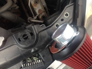

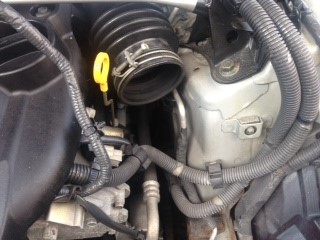

kevinmwatters Posted July 11, 2014 Share Posted July 11, 2014 Hi all, I recently purchased a "universal fitting" apexi cone filter c/w adaptors etc. I had a go at fitting last night, and ran into some problems. Essentially, the metal adaptor that comes with the cone head itself doesnt match the fitting to the existing intake; Stripped the original OEM filter and box out Heres where the problem starts. The filter comes with this metal piece that bolts directly onto the cone. However, its slightly too wide to fit into the platic intake that houses the sensor, and is too short to fit directly into the rubber end of the intake pipe; Theres a fairly high chance I am being an absolute idiot here, but any and all advice and help would be appreciated. Cheers, Kev Quote Link to comment Share on other sites More sharing options...

kevinmwatters Posted July 11, 2014 Author Share Posted July 11, 2014 I've got an Apexi for the Z, it just has a big aluminium block about 10mm thick which you bolt the filter to The filter bolts directly to the aluminium block no bother, but then the aluminium block doesn't fit in anywhere? Quote Link to comment Share on other sites More sharing options...

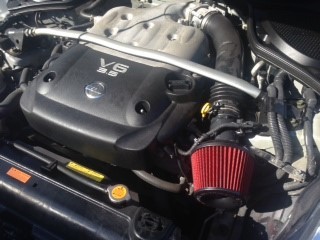

AliveBoy Posted July 11, 2014 Share Posted July 11, 2014 Mine looks a bit like this, just without the heat shield Quote Link to comment Share on other sites More sharing options...

kevinmwatters Posted July 11, 2014 Author Share Posted July 11, 2014 Ahh I see. Mine on the other hand looks like this; Im assuming I need to get an alu piece like yours that actually lines up the bolt hole on both the filter and the MAF housing? Quote Link to comment Share on other sites More sharing options...

AliveBoy Posted July 11, 2014 Share Posted July 11, 2014 yeah, mine is literally a block, no fancy stuff I can give measurements if you know someone who can copy it Quote Link to comment Share on other sites More sharing options...
StevoD Posted July 11, 2014 Share Posted July 11, 2014 Ahh I see. Mine on the other hand looks like this; Im assuming I need to get an alu piece like yours that actually lines up the bolt hole on both the filter and the MAF housing? yea thats for use like on husky GT4 were the MAF unit isnt a part of the pipework more a sensor thats pushed into it Quote Link to comment Share on other sites More sharing options...

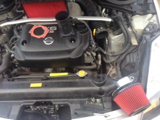

kevinmwatters Posted July 14, 2014 Author Share Posted July 14, 2014 Well wasnt easy, but got it fitted with some adaptations and a bit of will-power Temp measure until the RAM and induction kit arrives. Quote Link to comment Share on other sites More sharing options...
