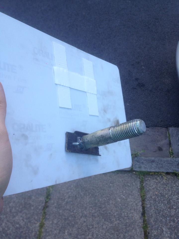

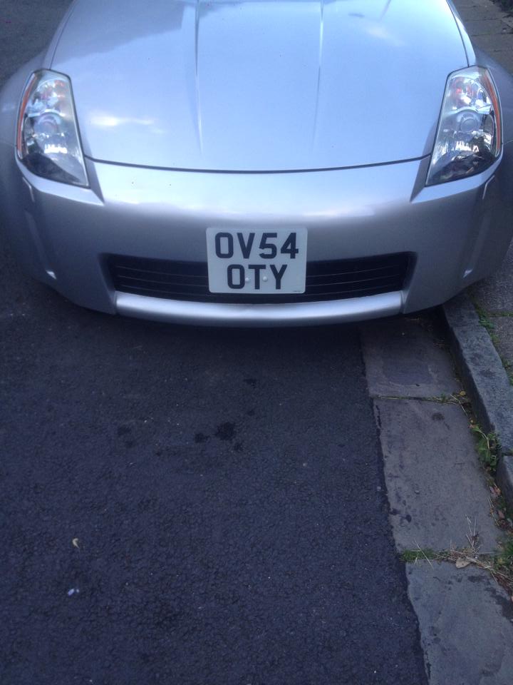

JoshC Posted July 9, 2014 Share Posted July 9, 2014 Don';t know if this has been done before but posted another thread a while back about how to fix a square plate to the front of my Z after I had the badge and number plate holes smoohted out. Didn't want to use the stickers or drill into fresh paint so was ging to use a bracket to come under the front of the bumper but paid a vsit to my mates garage and came up with a much simpler solution. We took the towing eye from the boot, cut off the actual ring on the end and welded a small metal plate to it. Then screwed the number plate into the end of the towing eye/mounting plate and screwed it into the towing eye hole. The beuaty of it is, you can't see where it's mounted and it can easily been taken off any time and the little slot out of the grill reaplced to have a compleetely smooth front end again As you can see it's a rough job and the holes screws could have been lined up better if you have OCD but needed a quick solution and this took 10 minutes! (also added number plate stickers to just the plate to stop it scratching the bumper as it's a very flush fit.) And of course have got hold of a new towing eye from a scrappies! Quote Link to comment Share on other sites More sharing options...
