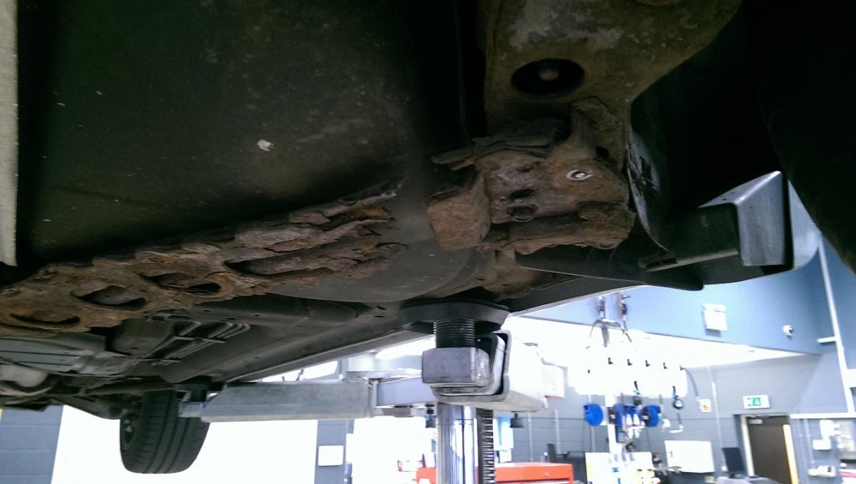

hyeung Posted July 7, 2014 Share Posted July 7, 2014 Just had some work done on the car, and was advised of some badly corroded areas. Firstly the Stay Assy Tunnel (Stay assy tunnel 74870 cd200) as shown below. Looks like one section is completely missing due to the level of corrosion. Can someone advise what exactly is the purpose of this particular part? And if this is a common issue is there's any cheaper suitable replacements available in comparision to Nissan parts? I assume labour wise, the fix is very easy? The other area that i've been advised on is a heat insulator (Heat insulator 74761 cd000). Assume this is an insulator for the exhaust system? Sitting just above the exhaust box? Any info would be appreciated. Cheers, Hung Quote Link to comment Share on other sites More sharing options...
BulletMagnet Posted July 7, 2014 Share Posted July 7, 2014 That's the W-brace, prolly best to try and see if ZMANALEX has a 2nd hand one Quote Link to comment Share on other sites More sharing options...
The Trouser Posted July 7, 2014 Share Posted July 7, 2014 (edited) I had my W-Brace replaced a few months ago - £248 done at the local Nissan dealer. I was told that its job is to stiffen up the chassis and its not an MOT fail if it isn't fitted. Edited July 7, 2014 by The Trouser Quote Link to comment Share on other sites More sharing options...
AliveBoy Posted July 7, 2014 Share Posted July 7, 2014 I haven't been running one for a year or so, I've had no adverse affects Quote Link to comment Share on other sites More sharing options...
-Bradders- Posted July 7, 2014 Share Posted July 7, 2014 Mines just as bad, i was just going to purchase a second hand one and Hammerite it before fitting. Quote Link to comment Share on other sites More sharing options...

PageyUK Posted July 7, 2014 Share Posted July 7, 2014 Blimey, that's some serious corrosion!! Quote Link to comment Share on other sites More sharing options...
AliveBoy Posted July 7, 2014 Share Posted July 7, 2014 Blimey, that's some serious corrosion!! I don't know if they aren't treated right from the factory or what the issue is, but they seem to really suffer from rust. Mine had rusted through on both ends, yet the rest of the car is pretty much rust free! It's really weird! Quote Link to comment Share on other sites More sharing options...
The Trouser Posted July 7, 2014 Share Posted July 7, 2014 Blimey, that's some serious corrosion!! I don't know if they aren't treated right from the factory or what the issue is, but they seem to really suffer from rust. Mine had rusted through on both ends, yet the rest of the car is pretty much rust free! It's really weird! I was told that it is one of only two non-aluminium parts under the car - mine had corroded so badly that the tech said he could push his finger through it. Quote Link to comment Share on other sites More sharing options...
andybp Posted July 7, 2014 Share Posted July 7, 2014 Just had some work done on the car, and was advised of some badly corroded areas. Firstly the Stay Assy Tunnel (Stay assy tunnel 74870 cd200) as shown below. Looks like one section is completely missing due to the level of corrosion. Can someone advise what exactly is the purpose of this particular part? And if this is a common issue is there's any cheaper suitable replacements available in comparision to Nissan parts? I assume labour wise, the fix is very easy? The other area that i've been advised on is a heat insulator (Heat insulator 74761 cd000). Assume this is an insulator for the exhaust system? Sitting just above the exhaust box? Any info would be appreciated. Cheers, Hung whats the corrosion on ? this is the heat shield and it's ally is it the shield or surrounding area ,could of gone where the mounting studs for the shield are Quote Link to comment Share on other sites More sharing options...
notfub Posted July 7, 2014 Share Posted July 7, 2014 (edited) I had a similar problem (see here http://www.350z-uk.c...-brace-options/) I managed to bag a couple of non rusty but 2nd hand W Braces from a supplier in California. I have one spare that I will shortly be listing in the for sale section. Edited July 8, 2014 by notfub Quote Link to comment Share on other sites More sharing options...
