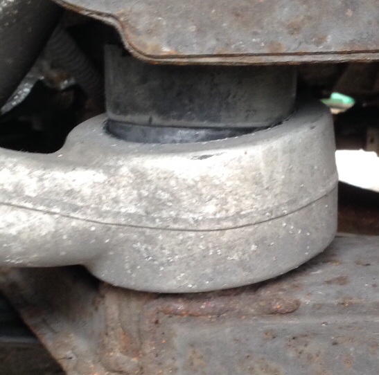

R1TCH1E Posted May 16, 2014 Share Posted May 16, 2014 Look at the compression arms if they have dropped down then the bush has collapsed. Common issue. Sent from my iPhone using Tapatalk Im getting the same knocking sound from the front passenger side. When you say check to see if the arm has dropped down if so then the bush has collapsed, im guessing you mean dropped down at the bush end? Should you be able to see the bush? Sorry for the dumb question but im new to checking for failed bushes lol. Also if i was to replace the whole banana arm is this to correct part i need? http://www.ebay.co.uk/itm/NISSAN-350-Z-350-Z-FRONT-LOWER-REAR-CONTROL-WISHBONE-ARM-LEFT-HAND-SIDE-N-S-/371063876420?pt=UK_CarsParts_Vehicles_CarParts_SM&hash=item5665216b44 If so is this all i need as it seems quite cheap compared to the prices i have heard they sell for. Cheers Quote Link to comment Share on other sites More sharing options...
SHEZZA Posted May 16, 2014 Share Posted May 16, 2014 (edited) This is what my failed compression arm bush looked like having dropped down That is the correct part to replace the whole banana arm though it is not a genuine nissan part unlike the ones from traders on here Edited May 16, 2014 by SHEZZA Quote Link to comment Share on other sites More sharing options...

R1TCH1E Posted May 16, 2014 Share Posted May 16, 2014 Lol trying to view it but struggling. When i zoom in it goes abit blurry haha. Thanks anyway pal. Quote Link to comment Share on other sites More sharing options...
SHEZZA Posted May 16, 2014 Share Posted May 16, 2014 Lol trying to view it but struggling. When i zoom in it goes abit blurry haha. Thanks anyway pal. Try again dude I've just changed it Quote Link to comment Share on other sites More sharing options...

R1TCH1E Posted May 16, 2014 Share Posted May 16, 2014 Lol trying to view it but struggling. When i zoom in it goes abit blurry haha. Thanks anyway pal. Try again dude I've just changed it Ideal mate. I will investigate mine tommorow to see if it looks anything like that. Cheers pal. Quote Link to comment Share on other sites More sharing options...

SHEZZA Posted May 16, 2014 Share Posted May 16, 2014 Worth checking the anti roll bar links first I'd say as not too dear a fix, before going with the banana arm. Thats what was causing the rattling noise on mine over rough surfaces a low speeds, aswell as the failed banana arm bush. Quote Link to comment Share on other sites More sharing options...
