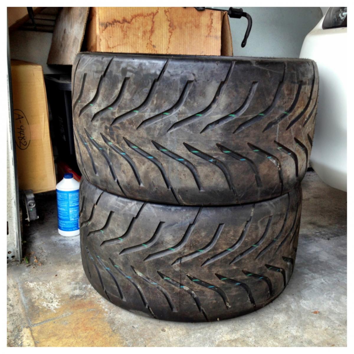

djtimo Posted December 10, 2015 Author Share Posted December 10, 2015 Is it wrong to get exited over ordering some new fat R888 rubber for the back? LOL.. 1 Quote Link to comment Share on other sites More sharing options...
Grundy Posted December 10, 2015 Share Posted December 10, 2015 Is it wrong to get exited over ordering some new fat R888 rubber for the back? LOL.. Don't worry, when my arches come I can't wait for bigger rubber 1 Quote Link to comment Share on other sites More sharing options...
djtimo Posted December 10, 2015 Author Share Posted December 10, 2015 Is it wrong to get exited over ordering some new fat R888 rubber for the back? LOL.. Don't worry, when my arches come I can't wait for bigger rubber What arches mate?? I keep looking at the carbon doluck ones... Quote Link to comment Share on other sites More sharing options...
Grundy Posted December 10, 2015 Share Posted December 10, 2015 Is it wrong to get exited over ordering some new fat R888 rubber for the back? LOL.. Don't worry, when my arches come I can't wait for bigger rubber What arches mate?? I keep looking at the carbon doluck ones... JDM flares I think, as If I got the Star dust ones I'd need new wider wheels. With these I can lose the camber, raise it a little and get bigger tyres. 1 Quote Link to comment Share on other sites More sharing options...
