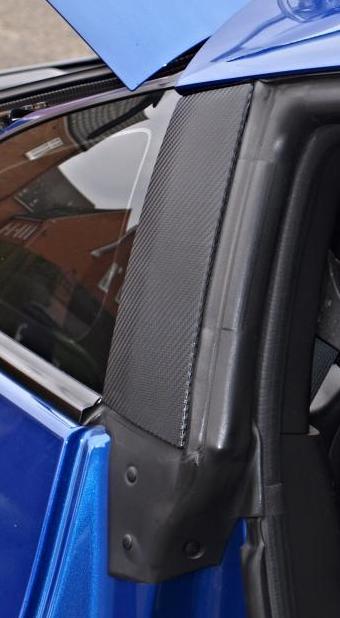

monkeybrain1234 Posted April 9, 2014 Share Posted April 9, 2014 (edited) Hi All I have searched quite a bit but cannot seem to find a guide or tips on wrapping the B-pillars with carbon like in the picture. Really like it but how easy is it to take the parts off? Thanks for all your help Edited April 9, 2014 by monkeybrain1234 Quote Link to comment Share on other sites More sharing options...

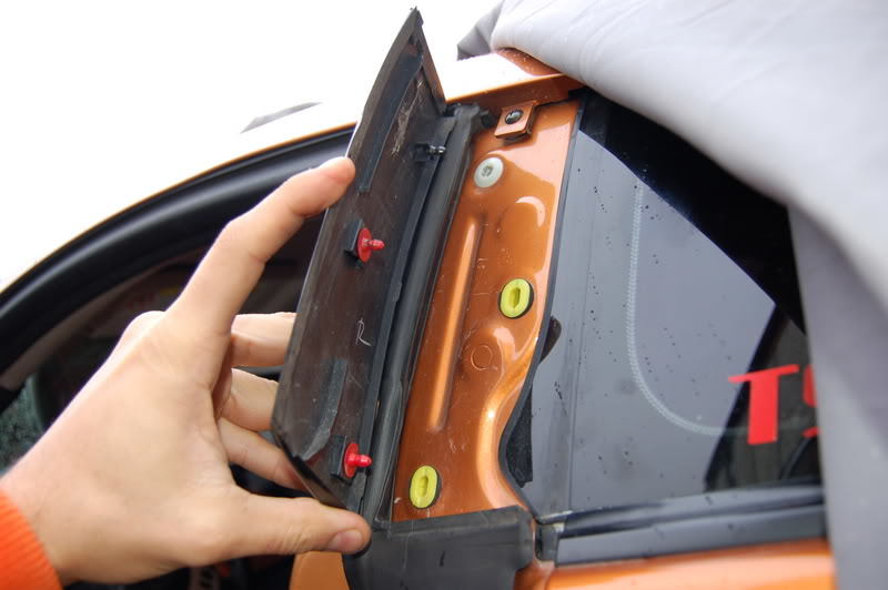

KosmiK Posted April 10, 2014 Share Posted April 10, 2014 I wrapped mine on Tuesday as it happens, used the attached picture as a guide, and used an old credit card to help prise them off. 1 Quote Link to comment Share on other sites More sharing options...
monkeybrain1234 Posted April 11, 2014 Author Share Posted April 11, 2014 Kosmik, thanks that's a perfect picture so I know where the poppers are. Excellent. Will get some wrap and give it a go. Did you have any any issues? Quote Link to comment Share on other sites More sharing options...
ZEUS Posted April 11, 2014 Share Posted April 11, 2014 Warm them up with a hair dryer first, they pop out easier and less chance of snapping a lug off Quote Link to comment Share on other sites More sharing options...

monkeybrain1234 Posted May 1, 2014 Author Share Posted May 1, 2014 Done this finally. Was really quite simple. Used Hexis 4D carbon wrap, although the final result was good, I did think the new 4D wrap would have more depth/gloss to the wrap. Possibly the 3M has more of gloss look. But now it is on the car I have to be honest it looks good. Taking the covers off I found okay to do, I used a credit card to loosen the panel a bit, after it was warmed up by the sun, then just held it from the bottom and the the whole panel just popped off easily. Cleaned it up and then set about wrapping it. Used the hair dryer to fold the edges and do the corners, but really was nothing difficult to doing this. Very easy. Think it looks good. Question now is, should I do the roof too??!?!? 1 Quote Link to comment Share on other sites More sharing options...
