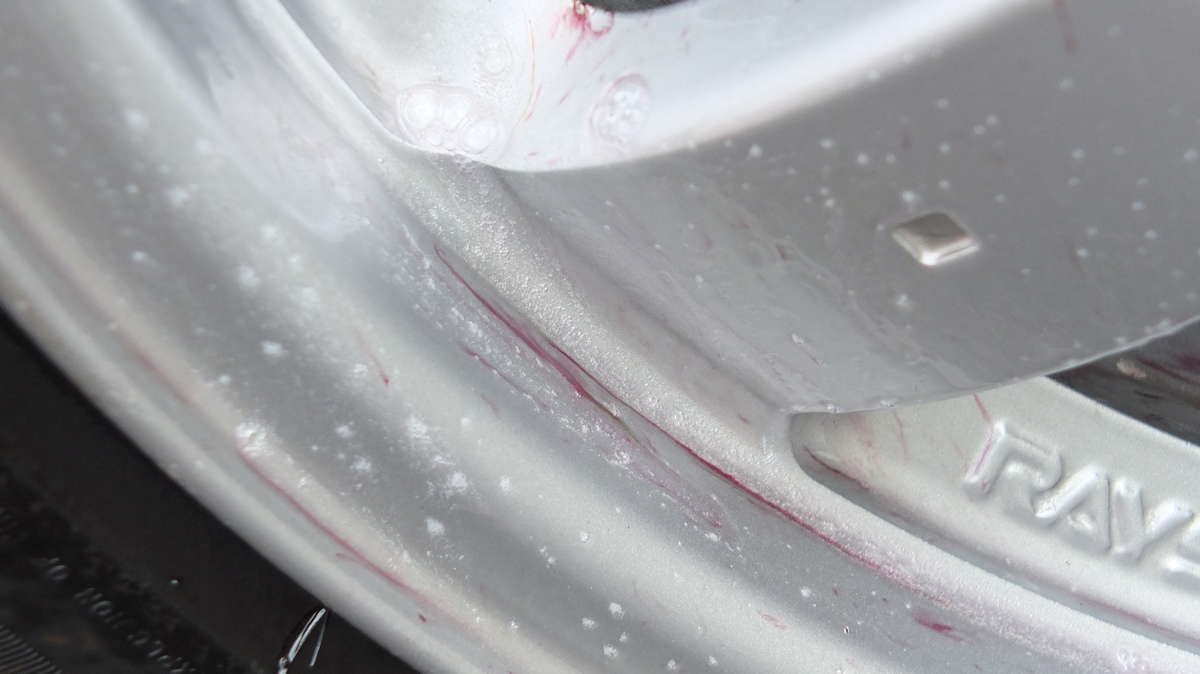

First up, Poorboys Iron Remover. Applied in the first minute did this;
Collage_Fotor.jpg.693cdaa6e698d12b2cd86c041c6c004f.jpgS0097555.JPG.010a139c5f4892651b9f464bea4eee86.JPGS0117559.JPG.c47cddda2663cd74540795013ed636c8.JPGS0147565.JPG.82689e40db0d5da2d66696942991a794.JPG
Meanwhile on a different wheel Bilt Hamber Korrosol did this within the 1st minute;
Collage_Fotor1.jpg.a9f47d94c8f3d9beb6a3a5f26d076aaf.jpgS0167570.JPG.c22ae8695e97636c18fac2ea9c10a6c9.JPGS0217580.JPG.da101af63ec500246e8ce9c1b463b82f.JPG
Both were then left to dwell for about 8-10 minutes, by which time Poorboys Iron Remover did it's best reconstruction of the Massacre of RAYSalonica (honestly, the best I could come up with. Sod off!);
Collage_Fotor2.jpg.3a1973a5109f752d8c4b017daa6acf4b.jpgS0247586.JPG.153edf800745e96b85a9fe56ea49c679.JPGS0257588.JPG.efa98cf5a7be3ad13eca6f016885a9ea.JPGS0267589.JPG.18e3c7765670d9cf684e1ff6206bd024.JPG
Meanwhile Korrosol had done this;
Collage_Fotor3.jpg.6fa9221092bc875c541e3ec7a1147ac7.jpgS0327601.JPG.d18b6b29ce46b90d143ec609dfdeddf4.JPGS0337603.JPG.8174fcb823378169de6d2871b8e4e37e.JPG
They were both then rinsed off, given a few minutes to dry a little and then our contestants swapped wheels.
Korrosol did this in the first minute on the wheel previously treated with Poorboys;
Collage_Fotor4.jpg.22abc43e2b80a7c013287ec30440b932.jpgS0397616.JPG.5e08df097d58a1c200a9db943bff17ce.JPGS0407619.JPG.a9449fd887f4fe3a9629b19d7b63370d.JPG
Meanwhile Poorboys did this in the first minute on the wheel previously treated with Korrosol;
After 8-10 minutes, Korrosol had done this;
S0517641.JPG.4dd7802aeee0a90299eb6e44a967f41d.JPGS0527644.JPG.33cf43c49f85b9a0f6346662a43ac6df.JPGS0537647.JPG.a9a67acba66d09b320df44013253b301.JPGS0547649.JPG.0bf07cf48516e829170622adc11b68f6.JPGS0587658.JPG.878abcd791ef74d2b429fa3fb0edae61.JPG
And Poorboys had done this;
S0607661.JPG.ea821039c5c5e887883bf37b0a33c0e2.JPGS0617663.JPG.7a78226ebc41b56ff0feb51f202bb763.JPGS0627665.JPG.4b122e2ac04f99c0eee797d5f28573fb.JPGS0637667.JPG.5d6e9e29013410190423e45b53f00a13.JPGS0647669.JPG.5d6961af3e6b984f2917d57050251fd3.JPG
Aside from the odd small spot here and there, most of that is being picked up from the brake disc and those 'orrible wheel weights. So the win definitely goes to Bilt Hamber and there are no last minute changes to the finalists.
Poorboys Iron Remover is pretty good though, as Poorboys products tend to be. It doesn't appear to be readily available in the UK just yet though which is a shame really. Like most fallout removers, when you open the bottle indoors, you get the typical rotting corpse stench however when actually using it there's a more detergenty scent to it - it's not a sweet scent like Korrosol, but it's not the typical horrendous stench either, so it's more pleasant to use than most. It seems to work quite quickly but is a thinner liquid than the almost-gel-like-Revolt, as such was starting to dry out after 10 minutes whilst Korrosol was still working away after the same amount of time.
I can't comment on the standard Poorboys spray head that is supposed to come with every liquid Poorboys product as ECP ripped me off (I'm not bitter about that at all...), so instead I used an Atomizer Chemical Resistant spray head - the nozzle of which works in the same way as the standard Poorboys spray heads (no idea if Iron Remover gets a special spray head or not because... well, you know why!) so I can only presume it's comparable. Essentially, the spray pattern is adjustable; by turning the nozzle you can go from stream to spray at infinite increments. I opted to go more spray than stream and tried to get as close to the Korrosol spray pattern as possible to make it as fair a test as possible.
In summary, it may not be quite as good as Korrosol but I think it'd give some of the more boutique brands a good run for their money. In typical Poorboys style the packaging is adequate and the price is (was!) aimed at the cheaper end of the market - although ECP have put the price up since I ordered it and it's now twice the price I paid (with a small discount) and more expensive than most other offerings. Presumably this will be due to importing it from the US, but either way it's just another reason I won't be ordering from ECP again time soon. It remains to be seen if any other UK stockists pick this up and what sort of price range it'll end up in if they do.

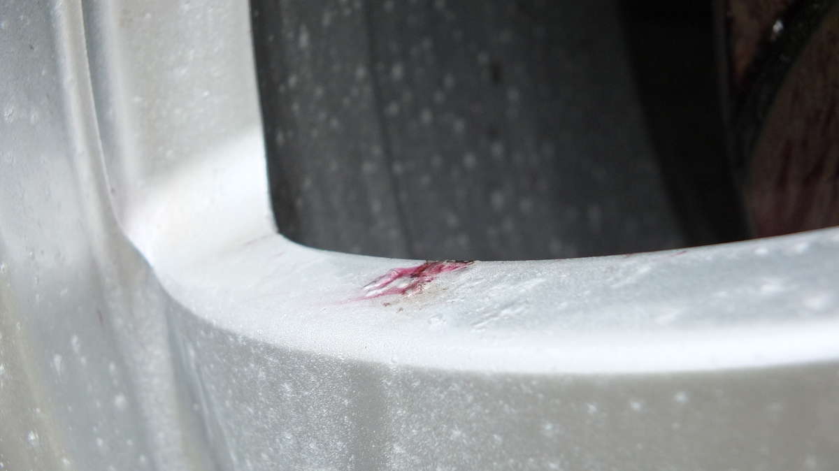

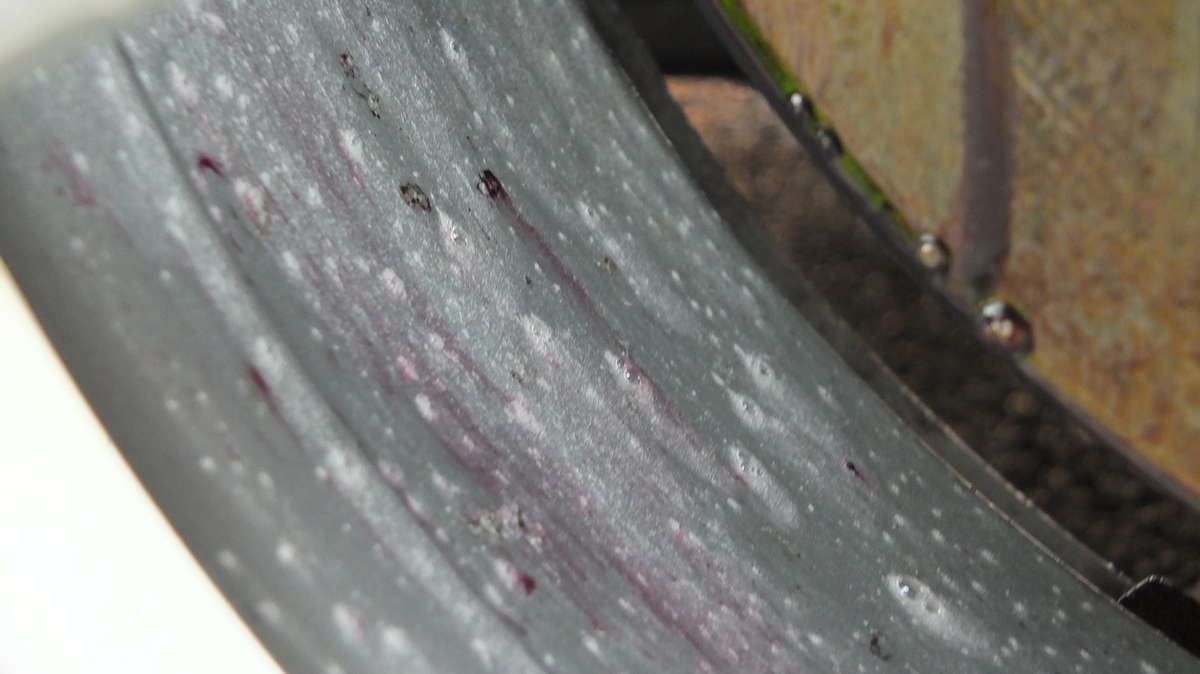

So Product A was applied to Wheel 1. Within seconds it had done this;
S0677675.JPG.4744ae3d42209df63d3103871acefd82.JPGS0687677.JPG.e1744f847d659b8946f405fae6de886a.JPGS0697680.JPG.e785b59de558d2df72cfa4c0cc136dbc.JPGS0707681.JPG.3a58a31423d820543411ee26ce45390f.JPGS0747689.JPG.1e4903eb095ae5231cd3c24b30daa94a.JPGS0757691.JPG.51e827ca88c81611be87ccfaacedc843.JPGS0767693.JPG.0f02c8e267babc9720ef4d000ed6f8a7.JPGS0777695.JPG.6c438fabbdaf7a3596ad4b95e243d9d7.JPG
Meanwhile Product B was applied to Wheel 2, which immediately did this;
S0797699.JPG.65b0c5bb9246cc5d0b42a48d20ddecdf.JPGS0807703.JPG.cf18d2e8ace9aa17e91b6ed404add2d1.JPGS0817704.JPG.7171af407ac6001ec56c284988788138.JPGS0827707.JPG.b55f4f168b900642e5c7980bd79dd728.JPGS0837709.JPG.91df05e5b6d4338a25fdb889b023db1e.JPGS0847712.JPG.c2b906a875f9af486ea74dfbc36363aa.JPGS0857714.JPG.6a3ece41e862772e5fbdb2fe4d2d5381.JPGS0897722.JPG.57f6fcb156a3eaeb317378105ba65048.JPG
Product A on Wheel 1 after ~10 minutes looked like this;
S0917726.JPG.c223f67c71c192d4fc4cf64dfca523c5.JPGS0927729.JPG.e0ecedd84364587b9eadfc8374106014.JPGS0937730.JPG.467f82f121414aa9eb65db0ec9d56204.JPGS0947732.JPG.84b021fe4f54b45c09bc53ddb274530a.JPGS0957734.JPG.26f63cc263f75cb7b15e84df89640432.JPGS0987741.JPG.21576df34c39b403e28e5fe1b59db7f9.JPG
Product B on Wheel 2 after ~10 minutes looked like this;
S0058010.JPG.9baca7eaa20507436d8bbd255d84fb25.JPGS0068011.JPG.4f993ced8d66852545acbb9d1885e366.JPGS0078013.JPG.57ae5186001ba9808cf0928f1577d378.JPGS0088016.JPG.d970e78ac115a8b862cfe3be0067e1b9.JPGS0118022.JPG.5b1bcad3c4e11b2c8c03ca174434afd2.JPG
Fair to say all four wheels needed decontaminating this time round then!
Rinsing happened, then a short break for drip drying followed by;
Product A on Wheel 2 immediately looked like this.
S0158031.JPG.aeb9618112d36afaa79977478bc0ad78.JPGS0168033.JPG.9fefe73c99d0f150d962dd82e68d83c2.JPGS0178035.JPG.95ced70cef087e6e0b63d57876c1741b.JPGS0188037.JPG.17654c4209ecb6ce31e131b161d561cd.JPGS0198040.JPG.08544947c153cc116e404b160c46c713.JPGS0208045.JPG.67935e94d68121c7cb16fc69cb7be0f1.JPGS0218046.JPG.86665461a064cc3a431d8509c1f99d96.JPGS0228049.JPG.d7623e6b9bc107885b64bc814504d4db.JPG
At which point I was ready to announce Product A the winner - not a huge amount being picked up but there are clearly some spots there that Product B has missed. But to cement that victory, it's only fair to check on Product B. So I did that.
Product B on Wheel 1 immediately did this;
S0248052.JPG.9b3867a0443849f20f5e7ef785c2951a.JPGS0268056.JPG.2a5474721dc64129a6ad93429e316065.JPGS0278059.JPG.c9cbf744d413cbb2826e2a05c2ac3e58.JPG
Oh... there's more than a few spots. I'd go as far to say a few small patches there.
So there we have it, Product B is the winner. But which one was Product B I hear you ask?
Well, to complete the test prior to the big reveal, this is what both looked like after 10 minutes;
Product A on Wheel 2;
S0298064.JPG.fd9b2e9b27a27945c6202461cf1bd29f.JPGS0308066.JPG.ad5215c75141afa3de9ddc3ce4822898.JPGS0318068.JPG.541f059068b43a3f2cd52afe33b9ff82.JPGS0328071.JPG.07bd3af4dd0b4c71f23d169bb9ca5c56.JPGS0338072.JPG.130d4d8a89dc8d4f510a5530373005b7.JPGS0348076.JPG.dda656c35220088a6c14e4d6f60db3a4.JPGS0358078.JPG.11ea31dd710e2a5838080d68a6cef10e.JPG
Compared to Product B on Wheel 1 after 10 minutes;
S0408087.JPG.10beb8a72d556f63306daad06d51b0a5.JPGS0418089.JPG.3166a98c30b6648bbb36ecb536865423.JPGS0428092.JPG.fd2b4530fccc18f983d71903d1867e48.JPG
And whilst I was taking those photos, Product A was still working away (this is after 13-14 minutes on Wheel 2);
S0458101.JPG.d1c734cbceba4e08d3c94b1e6dcad35a.JPGS0468102.JPG.7da0bf39e0ebcf645ed837c4c9dc2c1b.JPGS0478107.JPG.8b1bec8c67fc8dcfabbd77251aaaa612.JPGS0498110.JPG.0a4778d0d4b178ae4a3ed26f59c171eb.JPGS0518115.JPG.5a667bdde0ad3777dfe017338894b711.JPG
So whilst Product B picked up more immediately, it was then done. Meanwhile Product A found less immediately but then spent the next 10+ minutes finding more and more.
For me, a conclusive win for Product A, but you guys can make your own mind up.

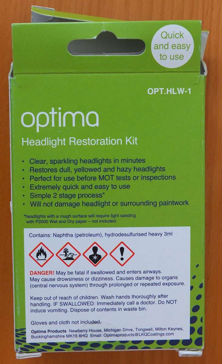

These eventually arrived from ECP. In this condition. :dry: Fortunately all the contents were still present so it was okay.
For those interested in what these actually contain, this is the extent of that detail;
So death. And this.
The test is simple but two fold; firstly, how well it clears up hazy headlights compared to actually polishing (more accurately, whether it's worth going to the extra effort to polish). Secondly how well it protects compared to nothing, GTechniq C5 and Gyeon Mohs. Because I have a little bit of both of those left over and no idea what else to do with those amounts! Surprisingly they're both still liquid after whenever the last time I used them was (they shouldn't be, they're both considerably older than their prescribed shelf life once opened!).
The contents are 2x Step 1 Cleaning wipe, 1x Step 2 Protection wipe, 3x identical instruction sheets.

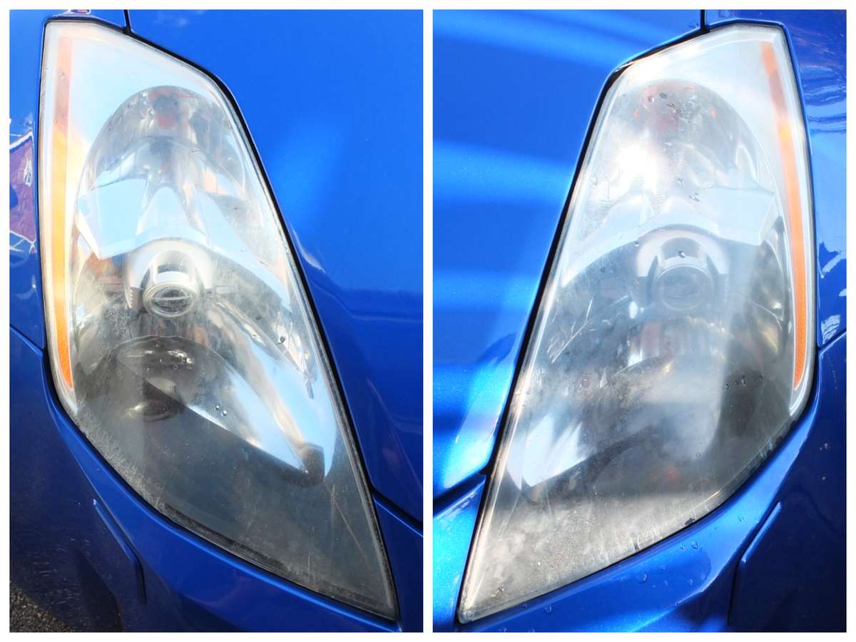

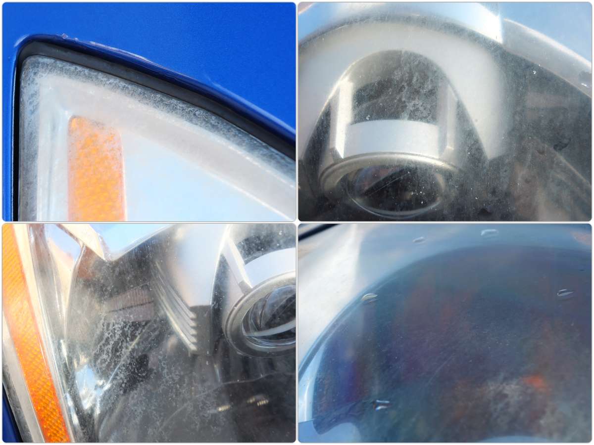

Part One then, clearing up hazy headlights.
Starting with this;
Collage_Fotor.jpg.2cc4992304ce730179fa988b3786ed53.jpgCollage_Fotor2.jpg.ead3f1ee26fc5e7d9ad6d2dc590abdf9.jpgCollage_Fotor3.jpg.ce5a2c20af35e4eb10f0abeead4f27e4.jpg
S0128143.JPG.8e91dd4ad9314d6de9e296742a67f838.JPGS0218163.JPG.c16a90e78dbe6f784d175ca2f9a71019.JPG

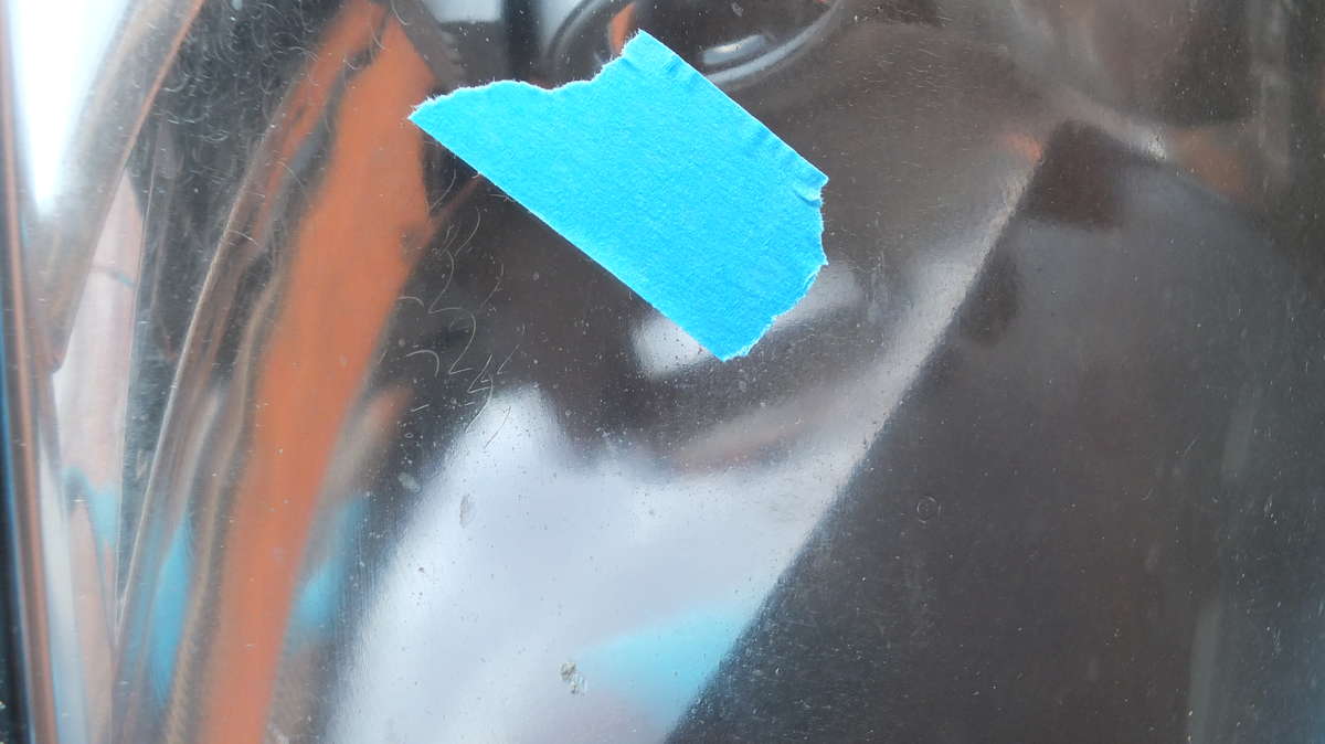

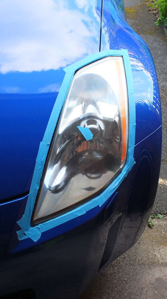

I then taped up - the bit on the headlight lens was just to help focus the camera on the surface of the lens, it was removed before polishing/wiping began!
On the above picture, I will be polishing the left headlight (driver's side) and wiping the right (passenger side) headlight. So some before pictures.
The passenger side headlight, to be wiped;
S0268172.JPG.2ff140b4a819cc0bf3c02c63e900fb03.JPGS0288177.JPG.4333ac7864b0880028cb0781931c7306.JPGS0298181.JPG.586d4f57fc5f29e55788f6930eabe211.JPG
And the driver's side, to be polished;
S0318185.JPG.e9fc7b070125077462e8ec3506f65cbc.JPGS0328187.JPG.db5e16857e88b711c818c29230ae54a3.JPGS0338189.JPG.aeac35b6a0cbed3d3a294ee672876de4.JPGS0358194.JPG.b8a989e4c0601e64acb468ddf6e7f15c.JPG

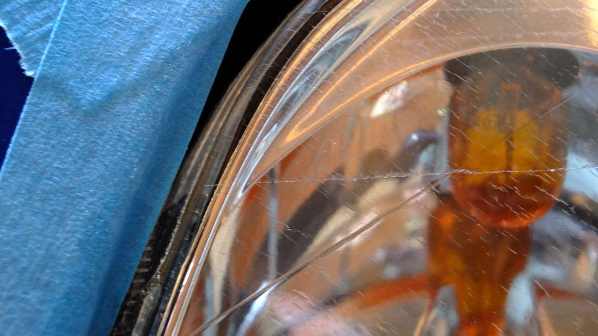

I then donned my gloves (because death in wipe form) and spent 30 seconds or so thoroughly wiping the passenger side headlight. After drying with a cloth, it looked like this;
S0408205.JPG.8bee2ca7acae913d30e22390df875e8c.JPGS0418207.JPG.732d19df9e7f1eca1428dda12ee8dd09.JPGS0438211.JPG.bf6a8db0b37bc34a5784bd1a24d134a8.JPG
I then spent about 30 seconds or so polishing the driver's side headlight with Scholl S20 Blue on a tangerine Lake Country Constant Pressure spot pad with the DAS-6 on speed 5 with no extra pressure (just the weight of the machine). After buffing the polish (I didn't do an IPA wipedown because... well, frankly I forgot. Oops.) it looked like this;
S0448213.JPG.dfb0972d36c35b95c18f7e697169e77b.JPGS0458215.JPG.5d7425139ef97dffd596455de7ca1660.JPGS0468217.JPG.80b4f064f5f200a25cf1932c62766acb.JPGS0478219.JPG.273ece4d1e2f361f91ee98c6df3257bd.JPGS0488221.JPG.7f99ade12170d0dd835381f266e3d5f9.JPGS0498223.JPG.c9291634d76255f89fafcef4f97161e9.JPGS0528230.JPG.cad600a805899d0dce93cc1c4dbc7feb.JPG
Much better than the wipe! Which still looked like this;
S0568240.JPG.a0ede506659c0b9c60339b43ae24f3a8.JPGS0578243.JPG.d81a5b143e2cfacd689df6335e42dc80.JPGS0588245.JPG.5d3c19b89624dffb65a3073dd9c8b151.JPGS0598247.JPG.1cdd4771b8c091672dd0bf19bd4d6003.JPGS0618251.JPG.17ef378bf9262bfb59485e7c2dc1f794.JPG

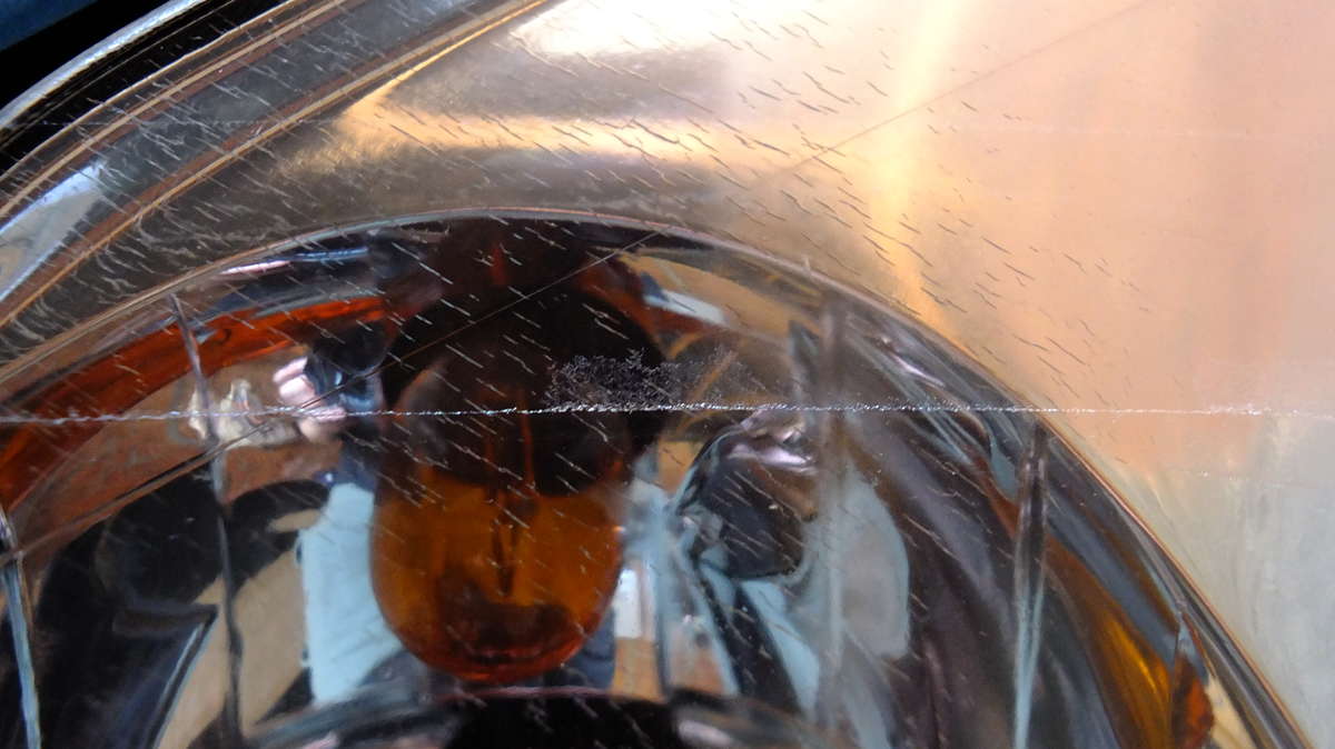

I then decided it'd be a good reference point to have a small polished section on the wiped headlight, so I taped up more;
And spent 12 seconds (literally, 12 seconds) polishing just the top left corner - I intentionally chose an area that will be the most exposed to direct sunlight by the way.
Which produced this difference (which is even more evident in person);
S0678265.JPG.8620c6585976f873aadbdb70f3df4010.JPGS0688266.JPG.ed3c5aa910c7b918300975a851603494.JPGS0718277.JPG.115b18adac17338504e4173de12502de.JPG

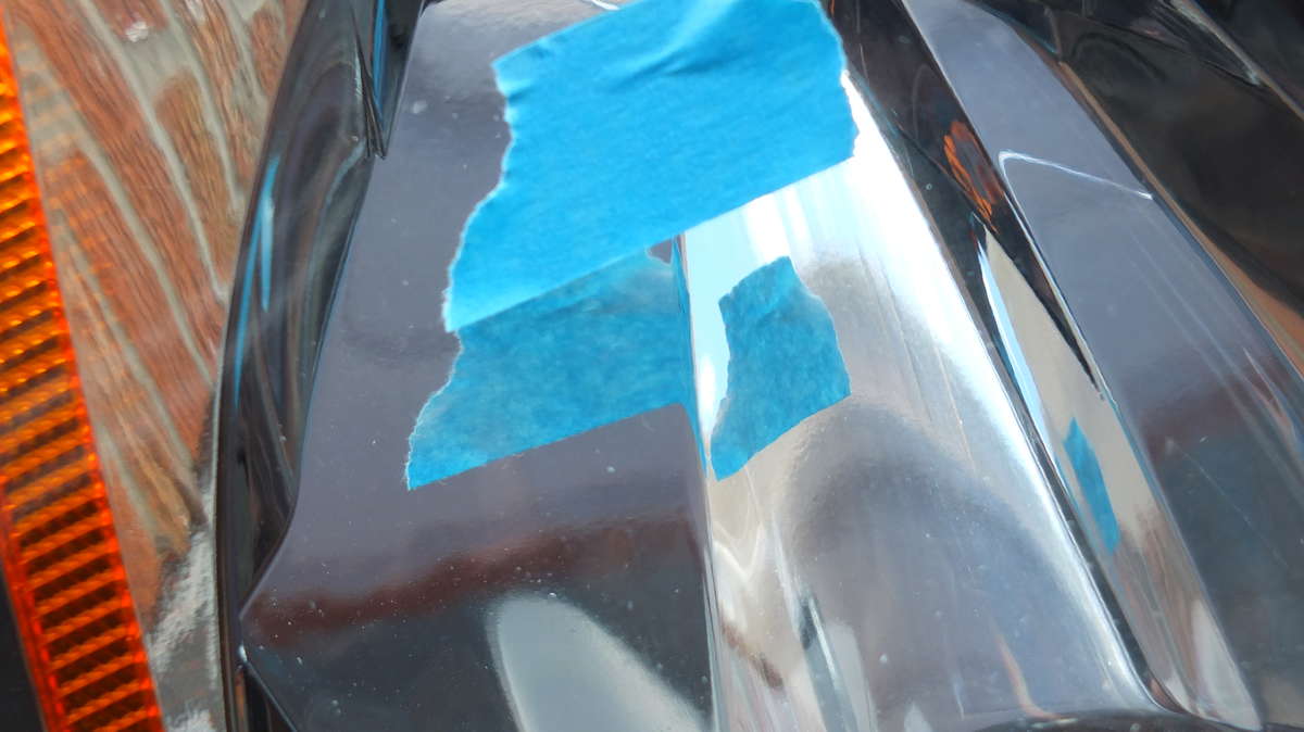

I then sectioned off a bit at the top for Part 2 of the test, so that I can have a section with no protection on, a section with the wipe protection on and a section with a coating (Mohs in this case) all on one headlight, side by side... by side. Mohs will take the top section, the tape line will remain unprotected with the wipes taking the rest of the headlight. After taping up again I used the second Step 1 Wipe on the bottom section again to eliminate the polish affecting the Step 2 Wipe at all.

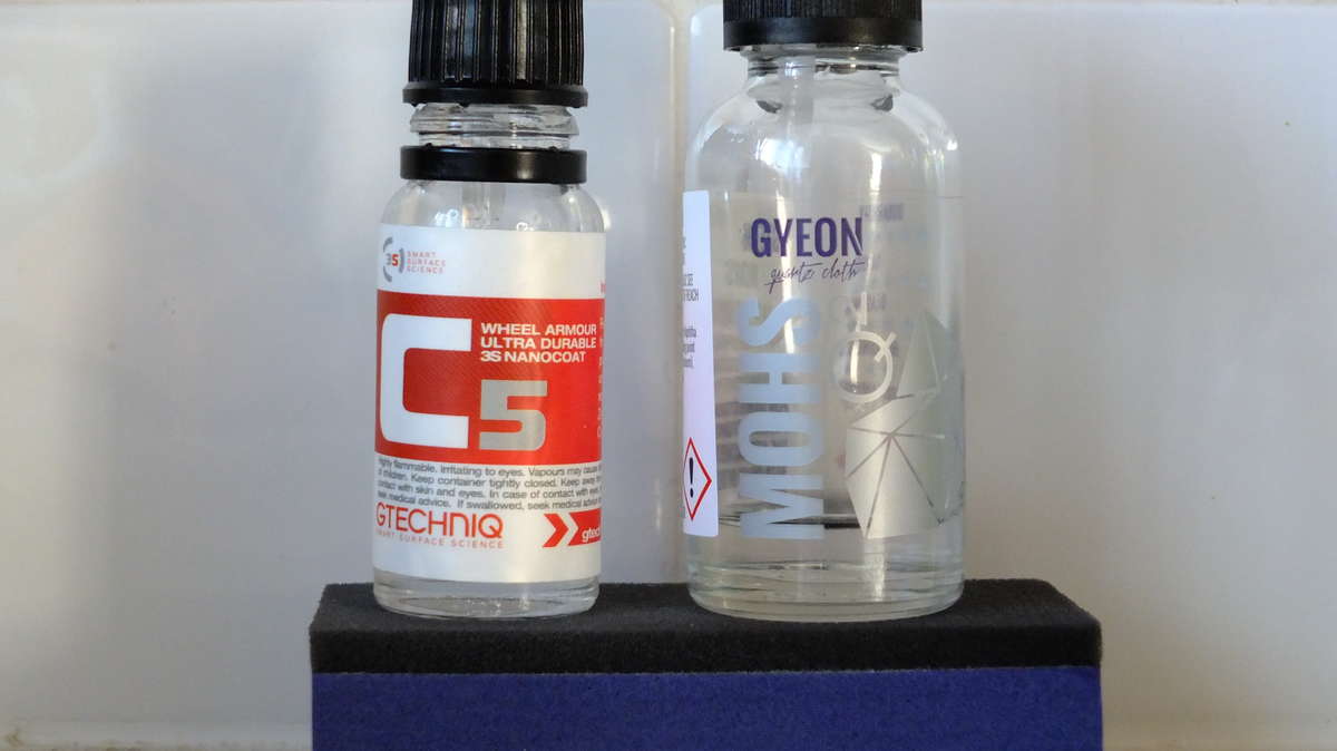

Meanwhile I taped up the driver's headlight so I can have C5 and Mohs sitting side by side - C5 on the left as you look at it, Mohs will be on the right. Due to curing times (the wipes need 4 hours to cure with no contact, C5 and Mohs will both need similar curing times) I've only applied C5 so far, with Mohs going on both headlights tomorrow - on the driver's headlight I will move the tape so that C5 & Mohs are sitting side by side with no gap).
S0768289.JPG.8fa72d891099ee3448266283f292c3b3.JPGS0778293.JPG.96428da213a168df156083f75c8fbca0.JPG
Now I did notice that the polish line was much less noticeable immediately after applying the Step 2 wipe on the passenger side, this could be because the surface was still wet, it could be because the Step 2 Wipe is actually the one that does all the work. I'll confirm and get photos tomorrow when it's cured, but as mentioned it needs 4 hours with no contact so I will allow it to cure before sticking a bit of tape to it to get photos.
First impressions of the wipes; Step 1 Wipe smells a bit detergenty and didn't seem to do a great deal so I suspect this is merely a cleanse wipe to prepare the surface for the Step 2 Wipe. The Step 2 Wipe smelt very white spirity but until it's cured I've got no comment on that yet. Personally I'm still sceptical, and it really isn't any quicker than polishing. In fact, aside from slightly less set up time, it's not even any less effort than polishing and the above demonstrates that unless the Step 2 Wipe works miracles it's nowhere near good enough to satisfy me... although I appreciate I may be somewhat more demanding than other people on this front.
Further update on the tidying up on hazy headlights to come tomorrow.
So Dan, pending overnight miracles, polish them mate!

Pretty sure it's just coincidence; it's named after Friedrich Mohs who developed the Mohs scale of mineral hardness - considering Gyeon's pride at it being the hardest coating on the market with 9h hardness.
It's also actually called Mohs Q2, so whilst Mohs can be read as Show on the bottle it doesn't make any sense with the Q2, so I doubt it's intentional at all.

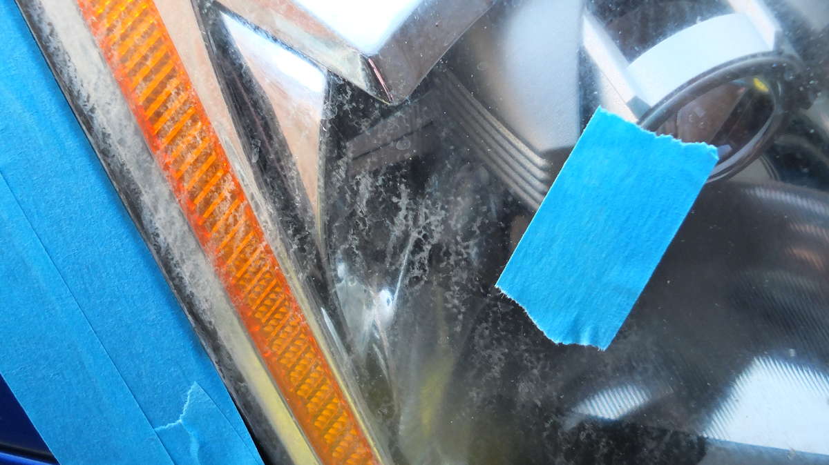

Erm... Miracles may have happened... ish!
So, after curing overnight, the wipes have actually impressed me after all. It's evident that Wipe 1 is essentially little to nothing more than an IPA wipe and does nothing but prep the surface for the coating. Which does all the work. All of it.
Okay, so it's not as good as polishing, but it's 90% there once the coating is cured. I'd liken it to light swirling on paintwork - 98% of the world wouldn't notice but for that 2% it's enough to be imperfect. If you're looking for a quick fix and you're not striving for perfection, the wipes will do a reasonable job. The caveat being that the coating wipe requires no moisture or humidity to work well - to the extent that the "no contact whilst curing" rule is because of the moisture in your skin! So for best results it needs a manageable environment for the curing period; i.e. indoor application only.
It was difficult to capture on camera because of the lighting - in the sun was too bright, in the shade I couldn't pick up the correct angle to show the difference. It's noticeable in person, but I refer back to the light swirling analogy.
Bottom right corner is the unpolished section and that's not a shadow on the lens;
Roughly in the middle - more evident on the right side;
And this shows the hazing that's still present on the bottom section which wasn't polished. The polished section is towards the top.
And you can just see a difference here if you're looking for it;
It's an improvement over how it started, but it's not perfect. And in that last picture you can also see where the tape line was for the coating wipe. I'm now more confident that it's added some protection given the physical evidence I now have, although durability is TBC.
Some finished photos then - Mohs has been applied, but is still curing at the moment.
S0068307.JPG.6f488df0eebccdbc3ea901c65fe77d80.JPGS0088312.JPG.8645afa6a0a9281f4523c171d43a836a.JPGS0118322.JPG.338a5a3f431909f7ddaab65d31309c87.JPGS0138326.JPG.d2c1b00c421d824b8d4dddda5794aa4c.JPGS0208346.JPG.2cf213f36e2a8746b67d4216ca914edb.JPGS0218347.JPG.9d841f73a87b44bcc7626ab0d37f8947.JPGS0228360.JPG.577c296ab25af5b052bdc8e5c395d53d.JPG
And the overall finished product;
Meanwhile on the other headlight, the one that was polished, there's a definite tape line where the two coatings meet so it should be fairly easy to keep track of what's working and what isn't;
S0148329.JPG.b65508f54d6403b54001ca8c602bf666.JPGS0168333.JPG.333053d578c688bb261a39b40821069d.JPG
I'll leave it to you to decide if it's worth the extra 10% for polishing or not.
Durability/UV protection will be updated as & when I remember to.
