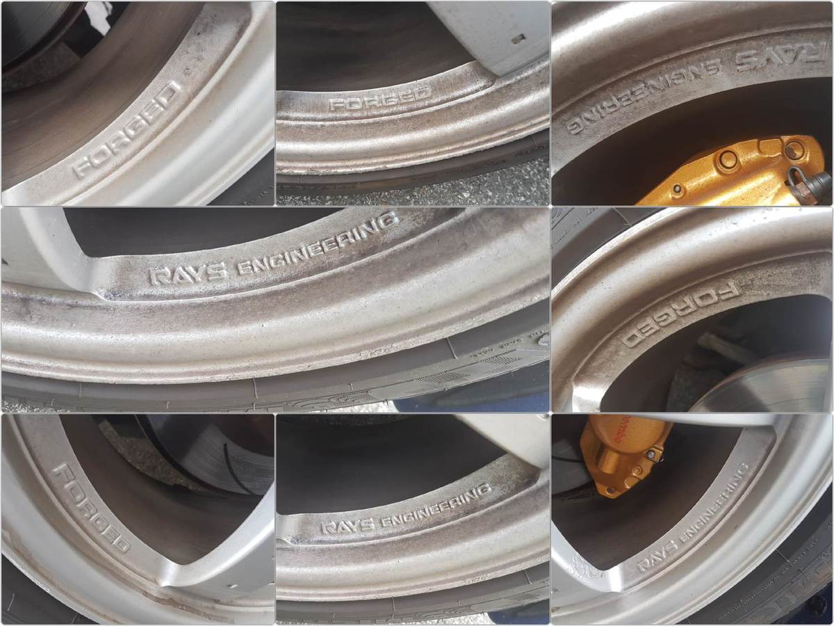

Six months of filth on the wheels looked like this;
Foam happened, then a shampoo wash using Wheel Woolies; the usual routine. Then the fallout removers.

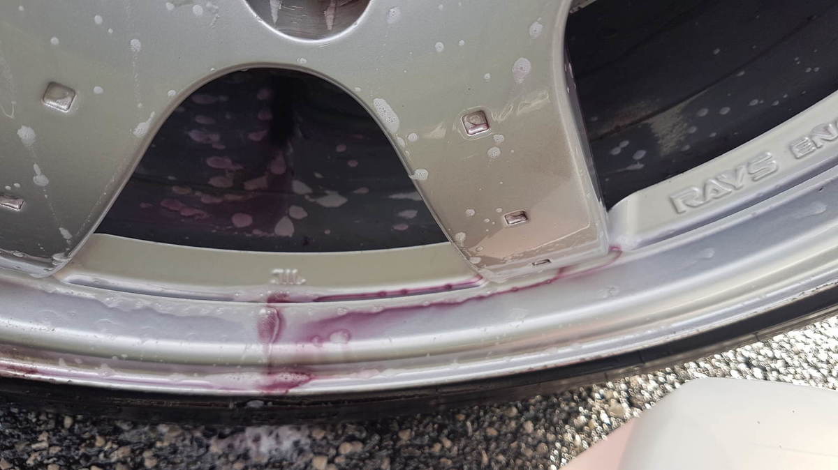

Today saw Bilt Hamber Korrosol go up against Auto Finesse Iron Out.
Korrosol did this;
Meanwhile Iron Out did this;
Rinsing happened. Then they swapped wheels.

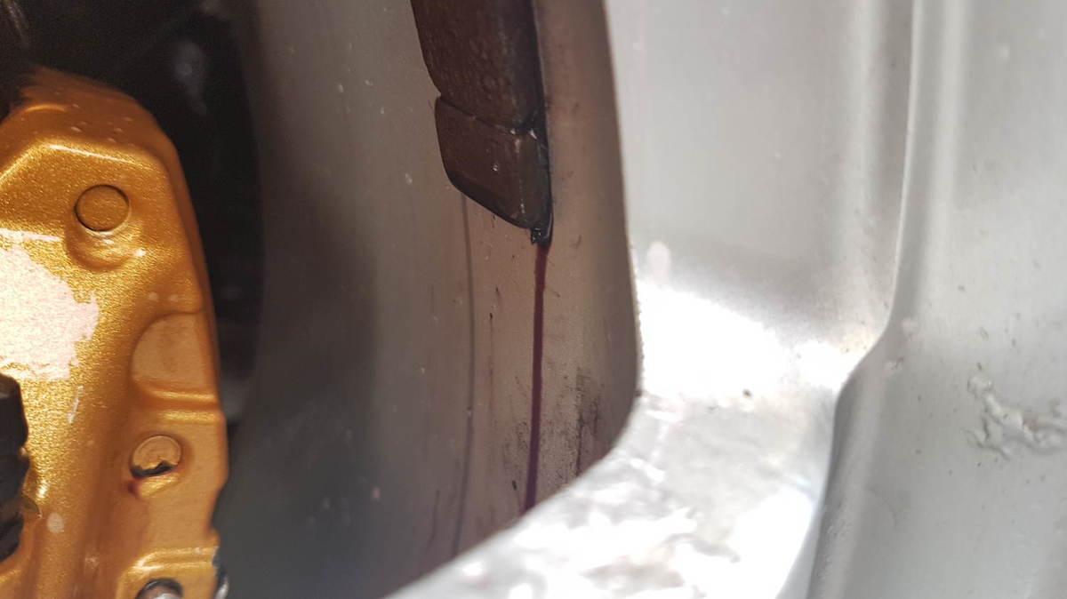

Korrosol then did this immediately;
Iron Out then immediately did this;
Most of this was traced back to the wheel weight, but there are other areas reacting both in the picture above and that below.
Elsewhere it picked up a few bits here and there;

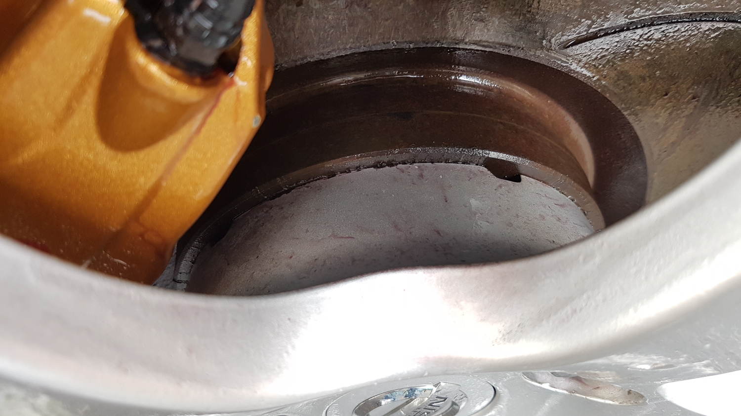

They were both left to dwell for a few minutes, after which Korrosol had done this;
In the same time, Iron Out picked up this;
That was all.
As should be expected at this stage, the performance of the remaining fallout removers are quite close. I do think it's fair to say that Bilt Hamber Korrosol out performs Auto Finesse Iron Out here, albeit not by a huge amount. I'd quite happily recommend AF Iron Out but considering Korrosol is cheaper (£13/litre compared to £20/litre for AF Iron Out), equally as available (Polished Bliss) and (marginally) better, I'm not quite sure why you wouldn't go for Korrosol instead.

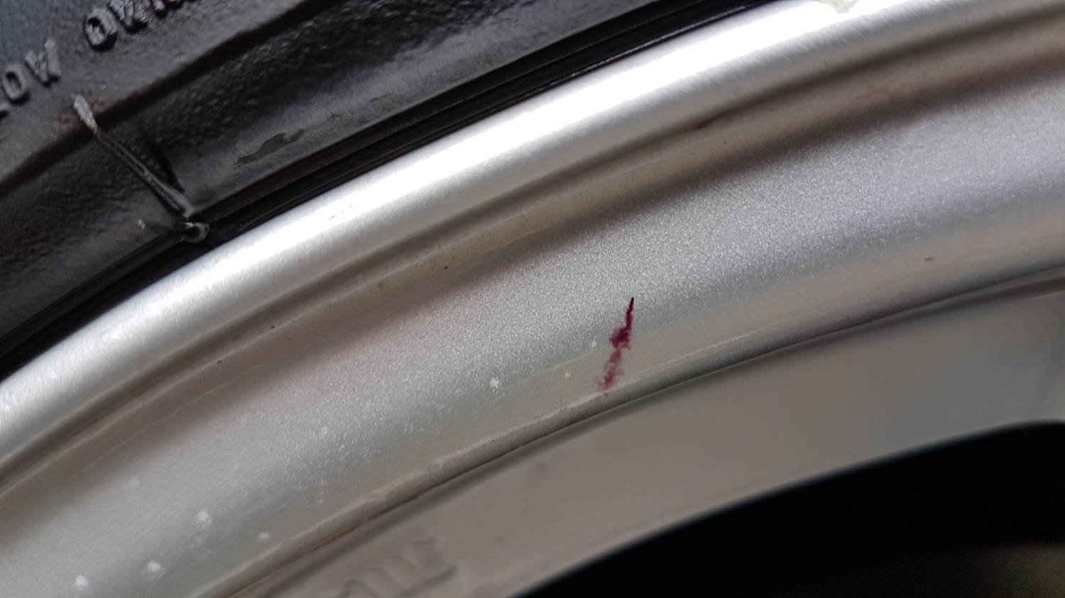

First up, Purple Haze almost immediately did this;
Ignore the amount coming from the weights, there's also plenty of other reaction going on around it too.

Purple Haze immediately did this;
After a few minutes, it had done this;
So it's picked up a few bits that Revolt didn't first time round.
Revolt then went and did this immediately;
And after a few more minutes, it had done this;
So there you have it. Revolt picked up a fair bit more than Purple Haze in round two, so takes the win on this one.
