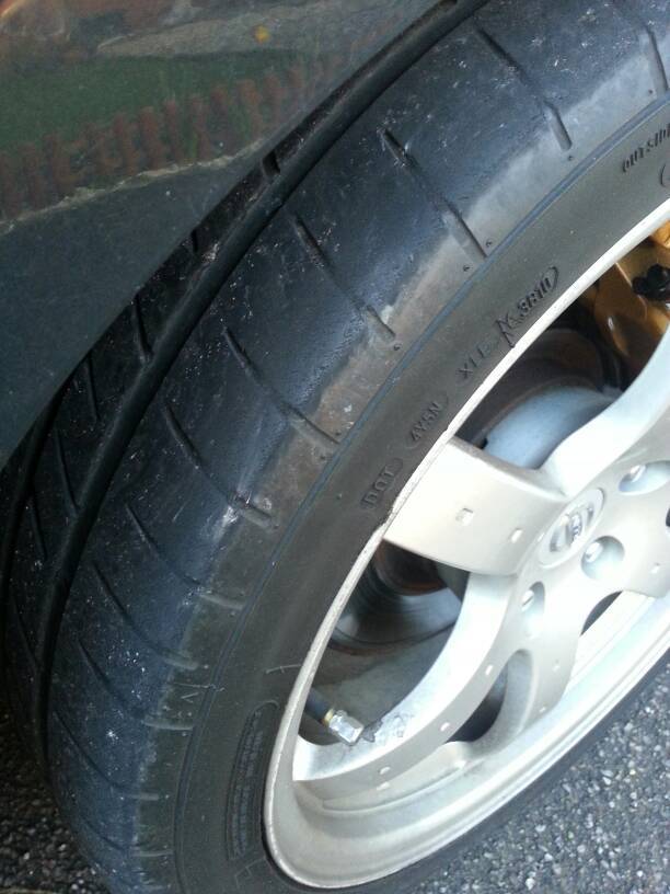

Darren350 Posted February 26, 2014 Share Posted February 26, 2014 Heavens, what the hell have I done, lol Today is my day off work, so after driving a van limited to 54MPH all week I decided to take the car for quite a spirited little run and have probably clocked about 20 miles. Not exactly the run of a lifetime but still... Anyway, all day I've been smelling something burning, and it seems to be from the front right tyre which A) Stinks and Has severe rubbing and outer wear showing! So, what have I done? A search has come up with baffling results as I'm quite a thicky lol What needs replacing, when, how much etc etc... advice required and appreciated peeps! Thank you for your help in advance! Sent from my GT-I9300 using Tapatalk Link to comment Share on other sites More sharing options...

Darren350 Posted February 26, 2014 Author Share Posted February 26, 2014 Hey guys, can't post a pic sadly as don't know how to via the Tapatalk app. Anyone know how??? Basically the outer edge of the tyre has white bits like severe rubbing, it also stank when I got the car back home, and it also has cracking. The rear tyres are absolutely fine. Sent from my GT-I9300 using Tapatalk Link to comment Share on other sites More sharing options...

Darren350 Posted February 26, 2014 Author Share Posted February 26, 2014 As you can see it is pretty scuffed looking and STINKS from inside the car. The tyre smelt ad well. Sent from my GT-I9300 using Tapatalk Link to comment Share on other sites More sharing options...
Keyser Posted February 26, 2014 Share Posted February 26, 2014 You sure it's rubber that you can smell? I mean that looks like the tracking needs doing or you just came in from a few laps of the track but that doesn't look like it's melting, maybe clutch or a sticky brake making the smell? 1 Link to comment Share on other sites More sharing options...
Ebized Posted February 26, 2014 Share Posted February 26, 2014 As Keyser says ^^^^ are you sure it is rubber you are smelling and the not the clutch, as that pic is not revealing anything to suggest the tyre is rubbing etc and seen a lot worse after track sessions? Link to comment Share on other sites More sharing options...
