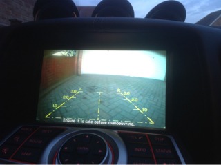

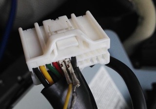

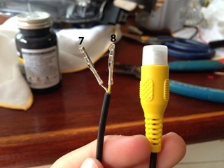

Davectr Posted February 5, 2014 Share Posted February 5, 2014 I fit one recently to my 2010 roadster, reasonably easy to do. I just bought an ebay camera (£15) and used the method of adding new pins to the video cable and inserting them into the multiplug on the back of the Nav screen. Job done ðŸ‘. I'm sure there are much better cameras out there, but for the price it'll do what I need it for Quote Link to comment Share on other sites More sharing options...
