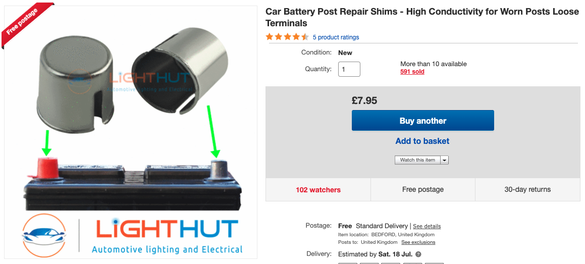

Rajtastic Posted July 13, 2020 Share Posted July 13, 2020 Hi guys, Just a note - in case your terminals don't fit anymore (mine fell out on track ) then you can buy these lovely little battery shims (made of lead) which you can crumple into the terminal posts (just open up the terminal cable eyes as wide as you can and then tighten with a rachet wrench until it clamps around it tightly and the lead will compress into a tight fit): Then you'll get a nice snug fit like this: Beast of a battery! 1 Quote Link to comment Share on other sites More sharing options...
