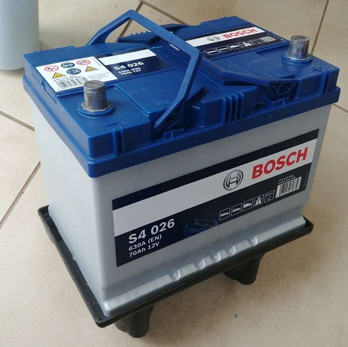

cob1980 Posted April 24, 2019 Share Posted April 24, 2019 Just thought I'd expand on this old post if anyone is interested. The Bosch S5 008 (AH 77 CCA 780) recommended above is the biggest capacity you'll find but it doesn't fit the tray. Won't move about much but still, if you want next best thing.... Bosch S4 026 It fits the tray nicely, capacity wise isn't too much less, and if you have a blue Z then it's win win! AH 70 CCA 630 Quote Link to comment Share on other sites More sharing options...
