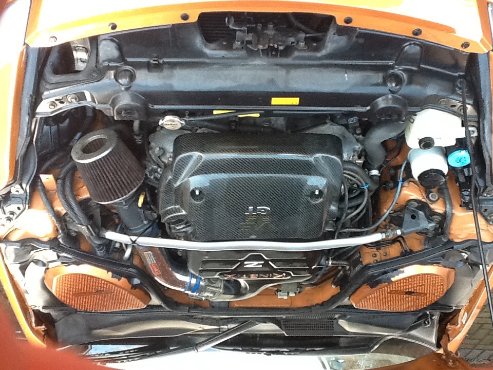

Ewen@Clark Motorsport Posted January 19, 2014 Share Posted January 19, 2014 Can you take an under bonnet picture and post it up? Quote Link to comment Share on other sites More sharing options...
Arran Posted January 19, 2014 Share Posted January 19, 2014 You'll have an aftermarket kit on already, id get rid of it and buy a standard airbox and use a HKS panel filter Reason for using HKS is its a dry filter so will only need cleaning and not re oiling which could potentially damage the mass air flow sensor. 2 Quote Link to comment Share on other sites More sharing options...

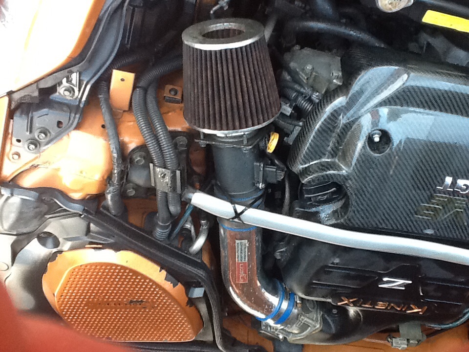

Red_Nic Posted January 19, 2014 Author Share Posted January 19, 2014 (edited) Sounds like you already have an aftermarket induction kit fitted Can you take an under bonnet picture and post it up? Oh! Let me start again and give u photos. I got really confused! I have an aftermarket air filter system by Injen. I want a replacement for the red cone air filter on the end. Can someone give me options and links to buy a replacement one. Edited January 19, 2014 by Red_Nic Quote Link to comment Share on other sites More sharing options...

GMballistic Posted January 19, 2014 Share Posted January 19, 2014 Oh! Let me start again and give u photos. I got really confused! I have an aftermarket air filter system by Injen. I want a replacement for the red cone air filter on the end. Can someone give me options and links to buy a replacement one. This look's to me like the kit you have fitted; http://www.tarmacsportz.co.uk/GB/350z_03-06_Injen_Cold_Air_Intake/350z-SP1986P_.aspx Tarmac Sportz are a trader on here so you could always send him a PM to see if he has any replacement cone filters for this particular kit. You could just buy a K&N cone filter or similar to fit it but I wouldn't want to link you to a cone filter as there are so many different sizes that it would no doubt be the wrong one without knowing the fitment size. 1 Quote Link to comment Share on other sites More sharing options...

Arran Posted February 16, 2014 Share Posted February 16, 2014 The stock airbox setup (albeit the revup version) is known to be the best for power due to the design and ability to keep heat soak at bay, the aftermarket unit you have on has no heat shield so will draw a lot of hot air in from the engine bay. The HKS is a dry filter meaning in contains no oil like its rivals k&n etc so won't cause any possible issues with the mass air flow sensor being contaminated with oil, usually happens when the filters are cleaned and too much oil is put on. Hope that helps 1 Quote Link to comment Share on other sites More sharing options...
Grundy Posted February 17, 2014 Share Posted February 17, 2014 You'll have an aftermarket kit on already, id get rid of it and buy a standard airbox and use a HKS panel filter Reason for using HKS is its a dry filter so will only need cleaning and not re oiling which could potentially damage the mass air flow sensor. Could u explain why u would recommend taking an aftermarket kit off and making it standard again? Surely aftermarket kits are better in general? Is your reason just the dry filter explanation above? Thanks The main reason people go for after market Air Filters/Induction kits is just down to the sound, Increase in 'roar' when the throttle is fully open. You will never feel the performance benefit of these, you will only see maybe 2-4 BHP difference on paper AFTER a re-map. As other people have said, the stock air box is just designed and setup right to get the true benefit from air flow. Quote Link to comment Share on other sites More sharing options...
Payco Posted February 17, 2014 Share Posted February 17, 2014 Wont a JWT popcharger fit straight on there as a replacement ?. Looks like a very similar fit to me. Payco Quote Link to comment Share on other sites More sharing options...
N12omc Posted February 17, 2014 Share Posted February 17, 2014 I always use Pipercorss replacement panel filters and stock air boxes with good flow from genuine outside air rather than warm/hot air from the engine bay. Like HKS they are not repliatnt on oil so help avoid nasty additions to the system, but also help maximise flow at the right revs (3-4000). Quote Link to comment Share on other sites More sharing options...
