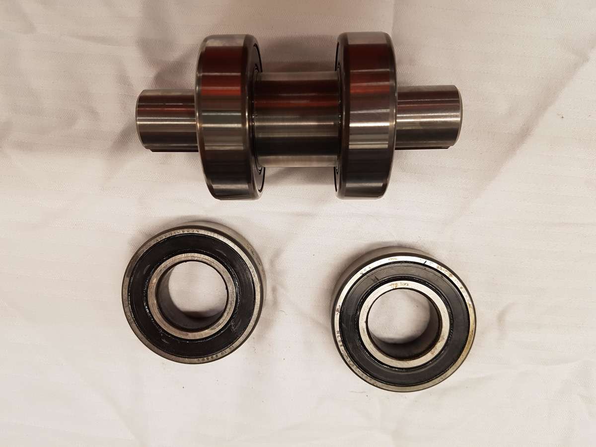

scobie140 Posted March 22, 2018 Author Share Posted March 22, 2018 (edited) Pressed the bearings out today. There was a fair bit of grease had escaped from the seals. The bearings have been changed at some point as they are now Skf. Looks like the correct spec, only thing that could be different is the internal clearances from OEM as its a C3 bearing that was fitted ( 6205 2RSH C3 GJN ). I see no reason to change from this so will replace with the same. The tensioner pulley bearings felt a bit tired as well so stripped them out, thankfully they were held in by a cir clip unlike the drive belt pulleys. These were clearly the original cheapo oem bearings as they had no markings on them. These will be upgraded to Skf as well 6003 2RSH GJN. I'll leave these at standard clearance for now and see how they get on Edited March 23, 2018 by scobie140 Quote Link to comment Share on other sites More sharing options...

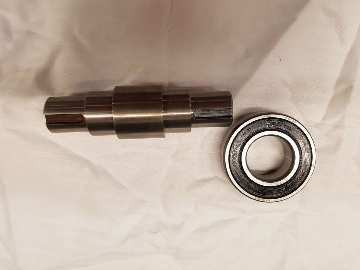

scobie140 Posted April 17, 2018 Author Share Posted April 17, 2018 (edited) New bearings arrived Shaft stripped and cleaned up New bearings fitted. All rebuilt and fitted. The bracket now transfers the noise of the supercharger straight into the chassis and into the cabin Looking for advice from other with a similar set up via the thread below. Left it running on the drive for 20min then drove it to work. Was good to have its first drive since November, never pushed it really just taking it easy and re acquainting myself with all the weird noises that the vortech brings with it. Felt a bit sluggish, could be cause its running on fumes that has been in the tank for 5 month, possible boost leak from having the pipework off recently. The belt was starting to slip a little I think on the way home so will tighten that at some point soon. I'm not overly worried just now and won't push it until Chris has had a play with her to see if she needs any adjustment since the last tune. Busy period at work for the next month but once my order from opie oils arrives I'll get her serviced then booked in with Chris at dyna tune to give her the once over & then get booked in to get the alignment sorted. Edited April 17, 2018 by scobie140 1 Quote Link to comment Share on other sites More sharing options...

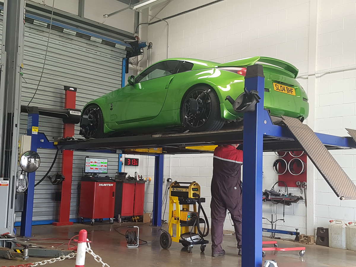

scobie140 Posted June 26, 2018 Author Share Posted June 26, 2018 A wee clean Then off to pro grip to get the alignment sorted. Only drove in traffic since its been done so not felt the benefits yet but turn in feels better already. Happy now that there is no more outstanding jobs on the car to do other than the idler pulley but that is a 5 min job i've just not got round to yet. Time to save up the pennies to get stone chips & arch rust sorted now 2 Quote Link to comment Share on other sites More sharing options...

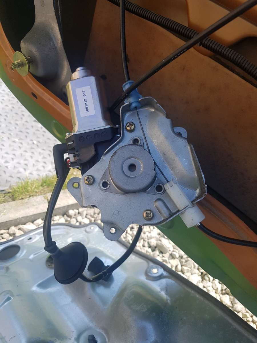

scobie140 Posted May 16, 2021 Author Share Posted May 16, 2021 Finally remembered to change the passenger window motor, a nice day for it. Old one Just need to find time and more good weather to give her a good clean up for fresh pics and get her up for sale. Its been 10 years and is still great fun to drive but it's time for a new project I think, need to scratch that V8 itch. 2 Quote Link to comment Share on other sites More sharing options...
