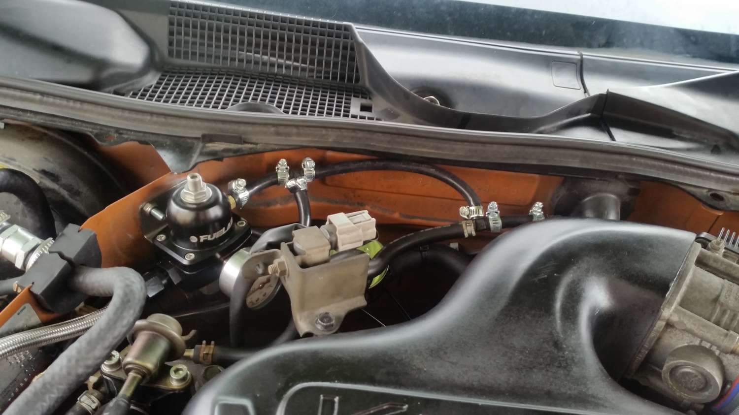

Massive thanks to all the help in this thread http://www.350z-uk.com/topic/114218-fuel-regulator-set-up/page__st__20

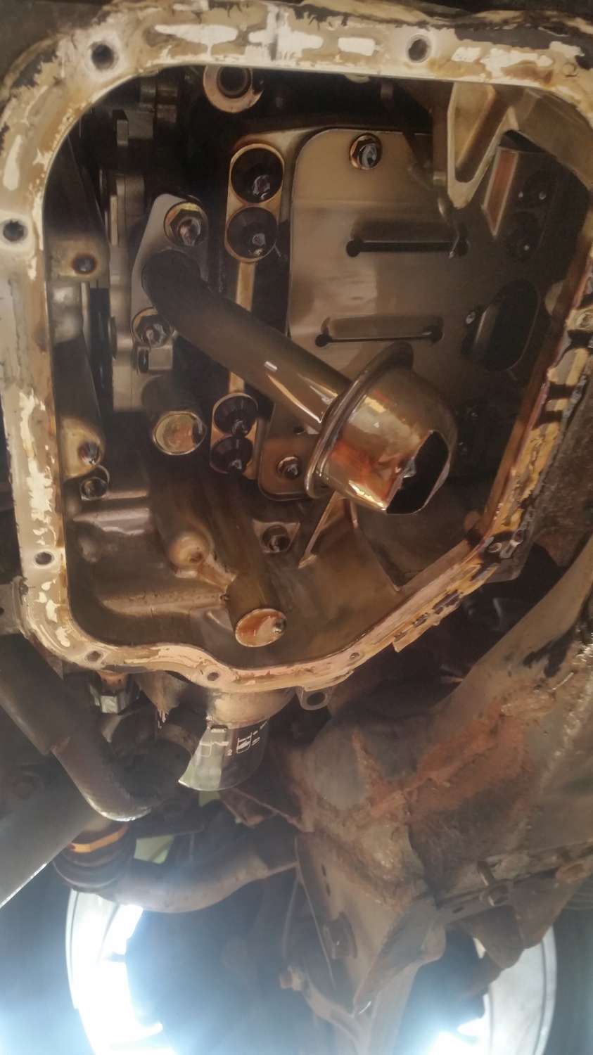

Removed the sump
All cleaned up

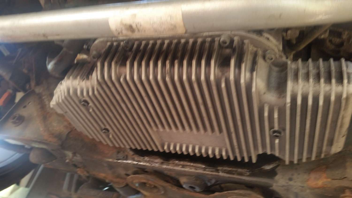

New bigger sump fitted
Sandwich plate for oil cooler and hoses fitted, I've still to fit new oil filter and oil but it's not arrived yet so just stuck the old one to keep the system free from contaminants and bagged the ends of the oil hoses with rubber gloves and tucked them out the way.

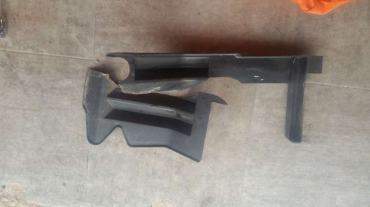

And lastly managed to snap this while getting out from under the car, so will be looking for a replacement soon.

Finish of the fuel system and get the regulator mounted and pipe work all tidied up. Put the ignition to on and check for leaks

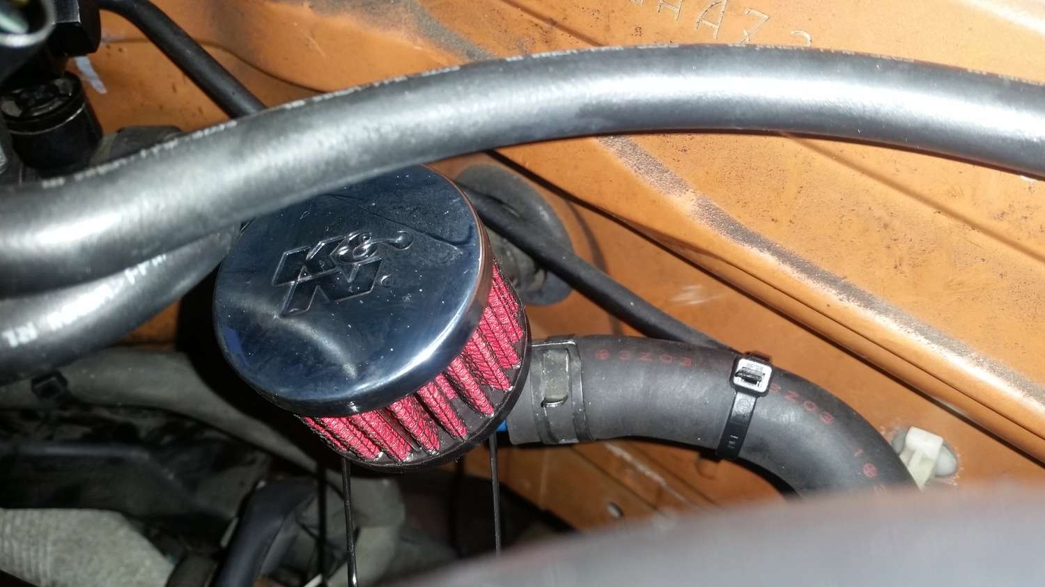

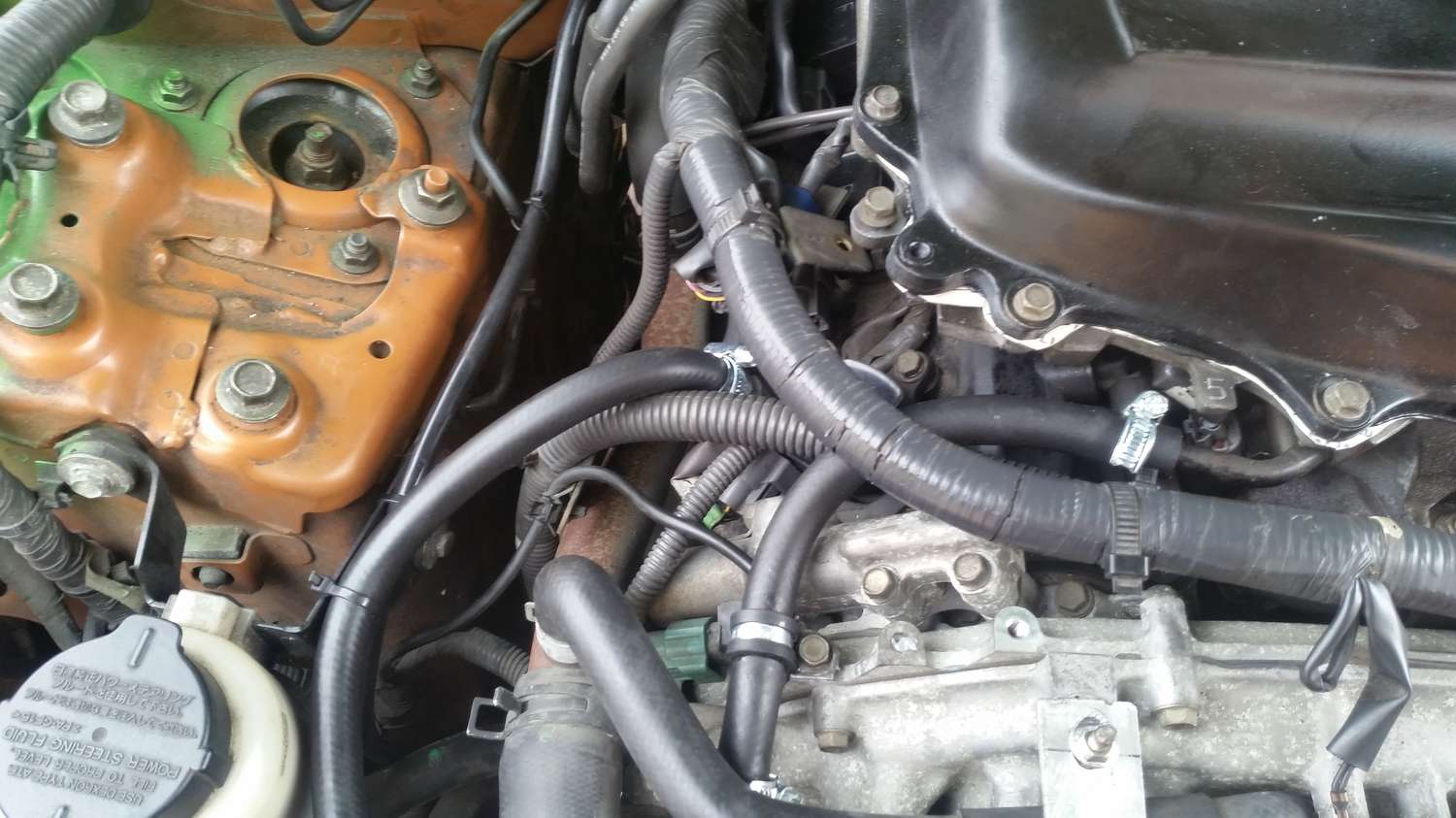

K&N filter for the passenger side PCV
Roughly fitted for now

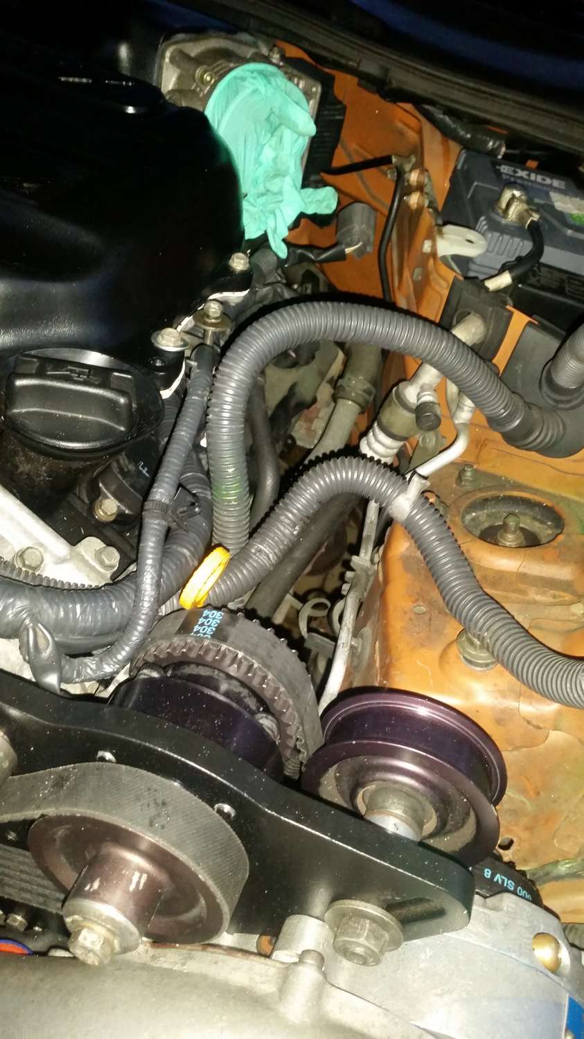

Had to remove a few pulleys to get the charger in position, only to get hampered with more wiring getting in the way!
Some time in the oven and the pulleys slipped back on no problem.
Chucked a a spare used belt on for now just till its been ran as there is already a few clearance issues.

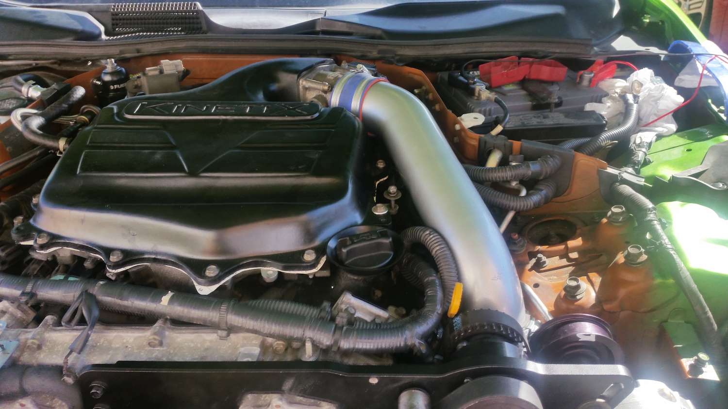

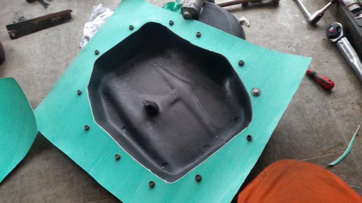

I got a break from the rain so decided to get the upper plenum stuck on. Had to make a new gasket as the last one came off in bits.
Fitted, still need to tidy up the outer edge of the gasket
Not ideal this but you can see the gauge fine.

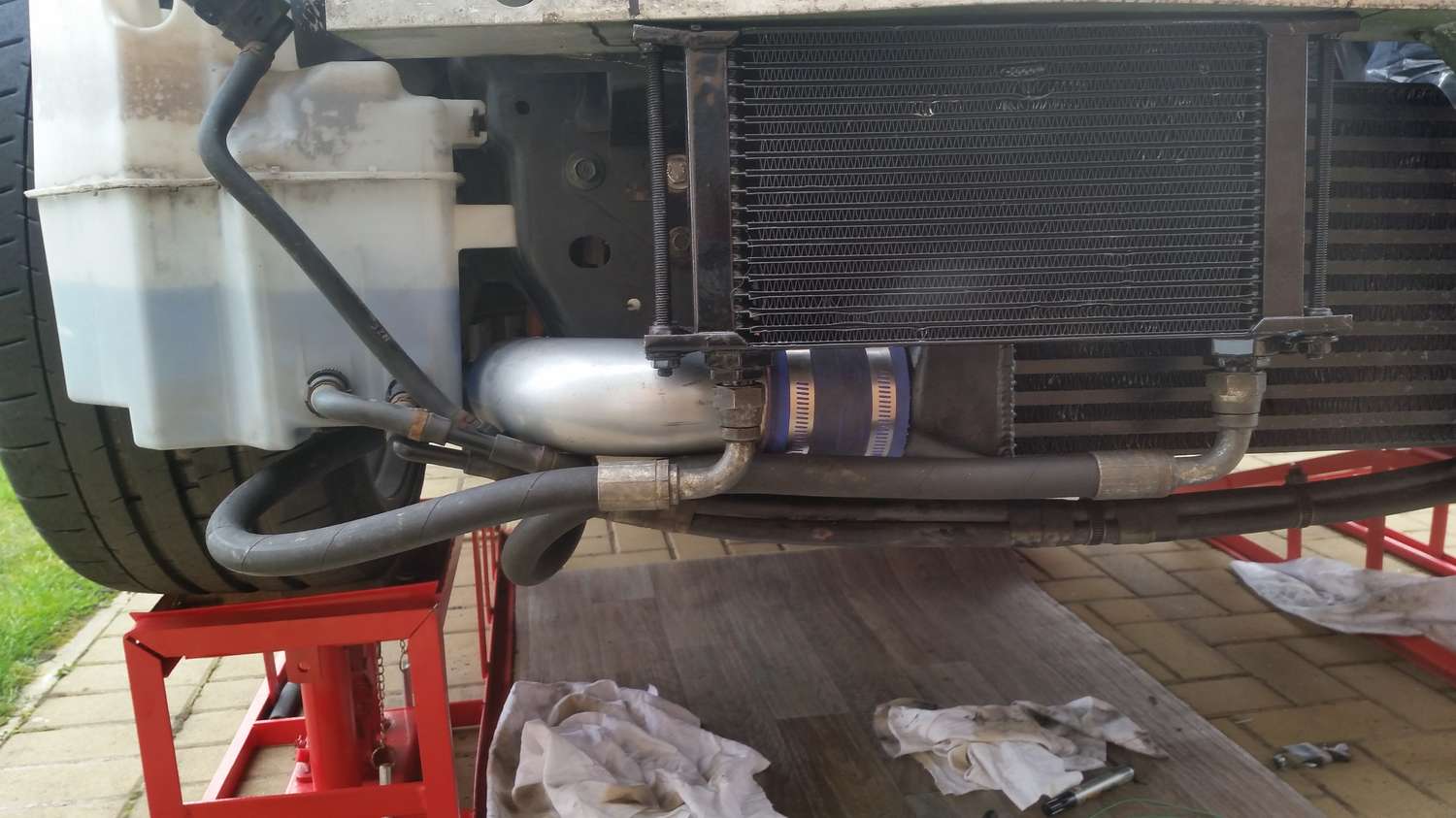

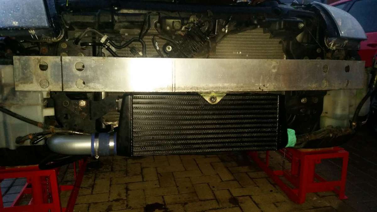

Fitted the inter cooler and the first two pipes.

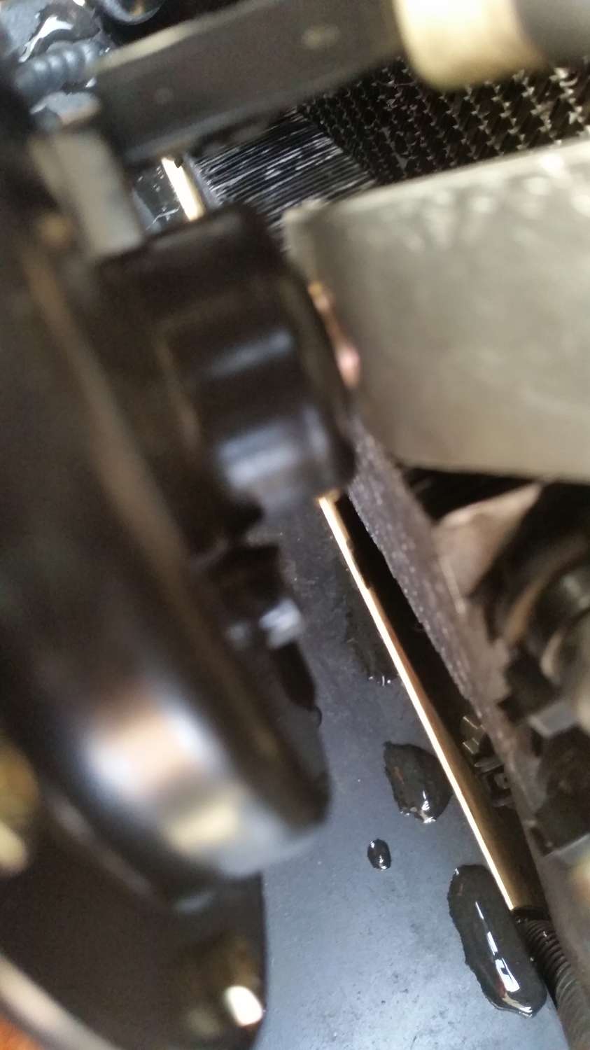

Need to take the bend off and put the washer pipes under it.
Inter cooler will need moved back a about 5mm to allow the oil cooler to fit in my pre guesstimated position that I drilled out before the inter cooler arrived. I'll also need to make up some sort of bracket for the power steering cooler.

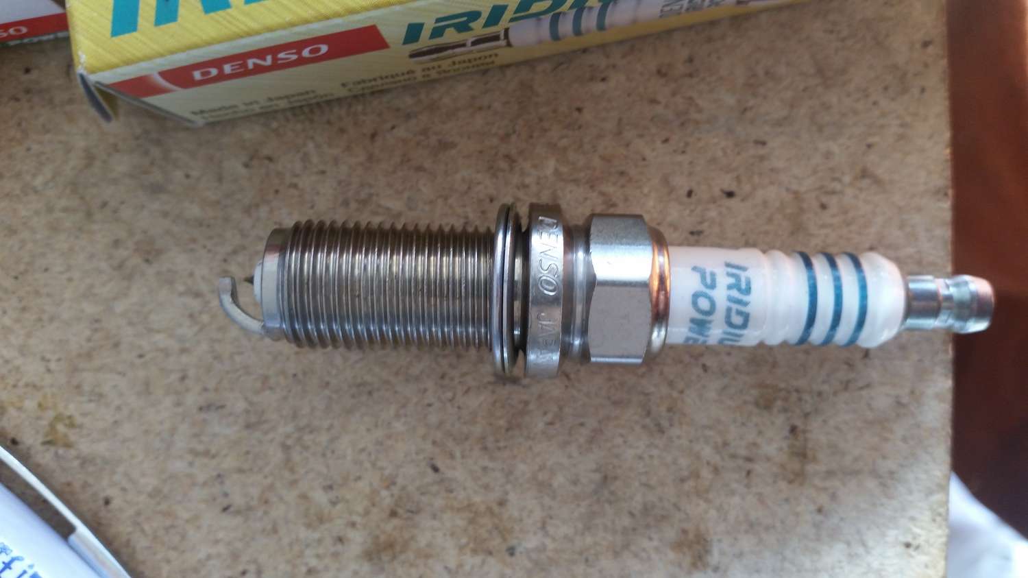

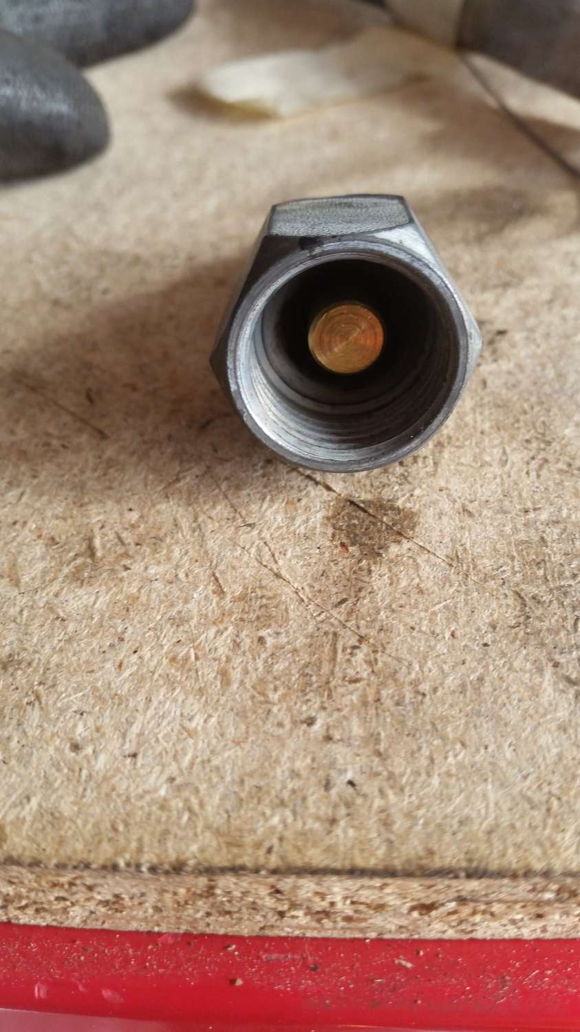

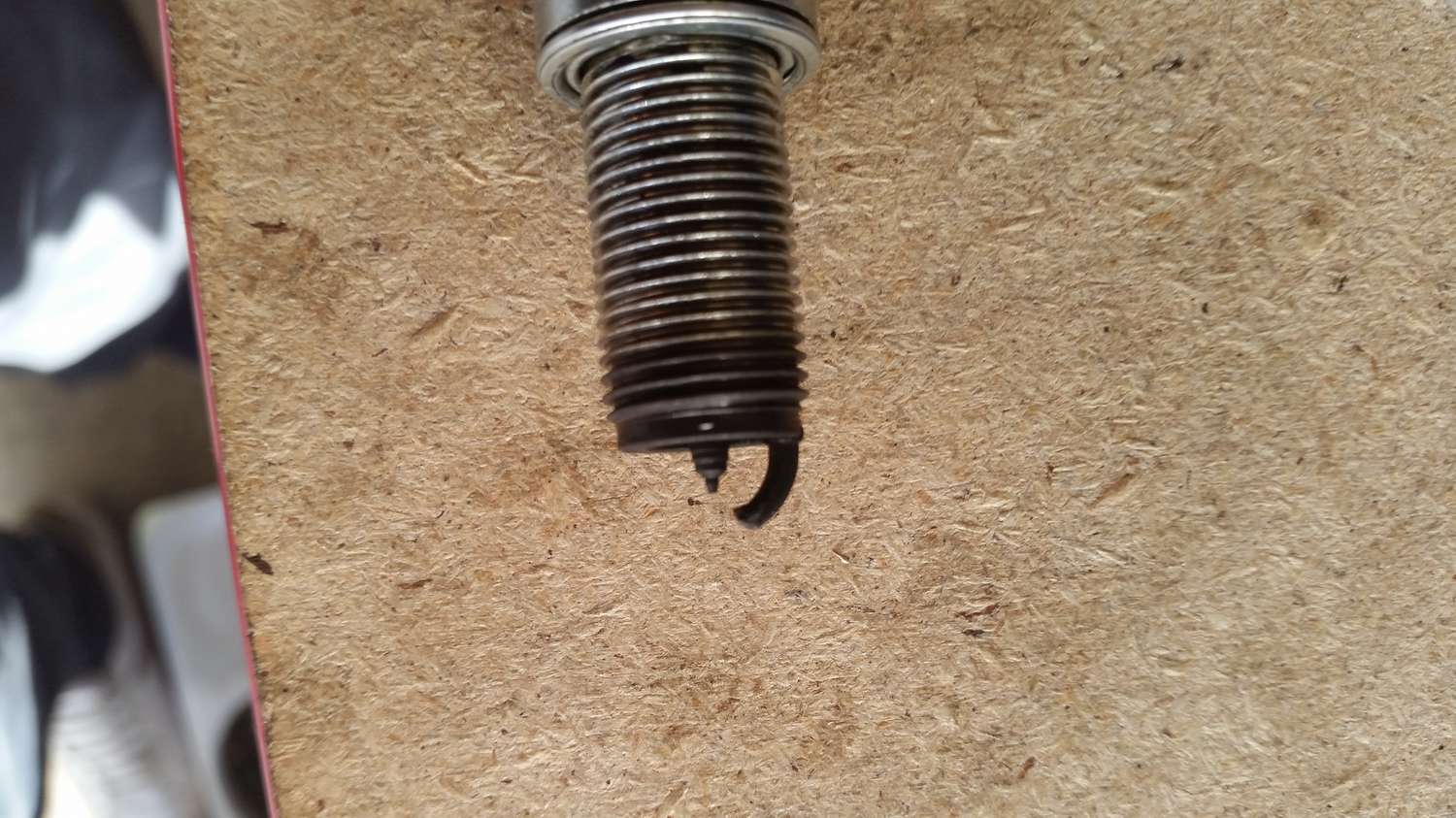

Set about changing the plugs to the 1 step colder when disaster struck and the magnet in my spark plug socket gave up resulting in a dropped and broken plug
So ordered some new ones. Struggled to get NGK from the uk without paying over the odds so went for the equivalent denso plugs

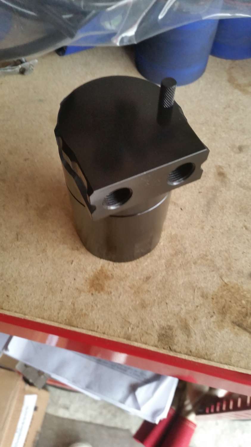

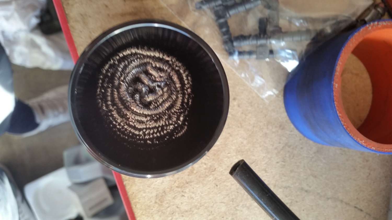

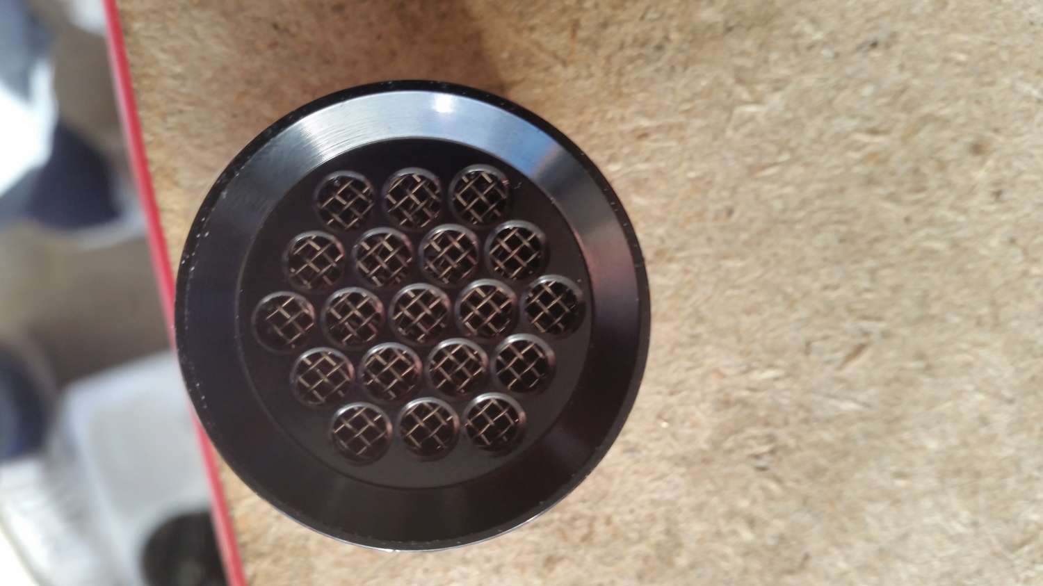

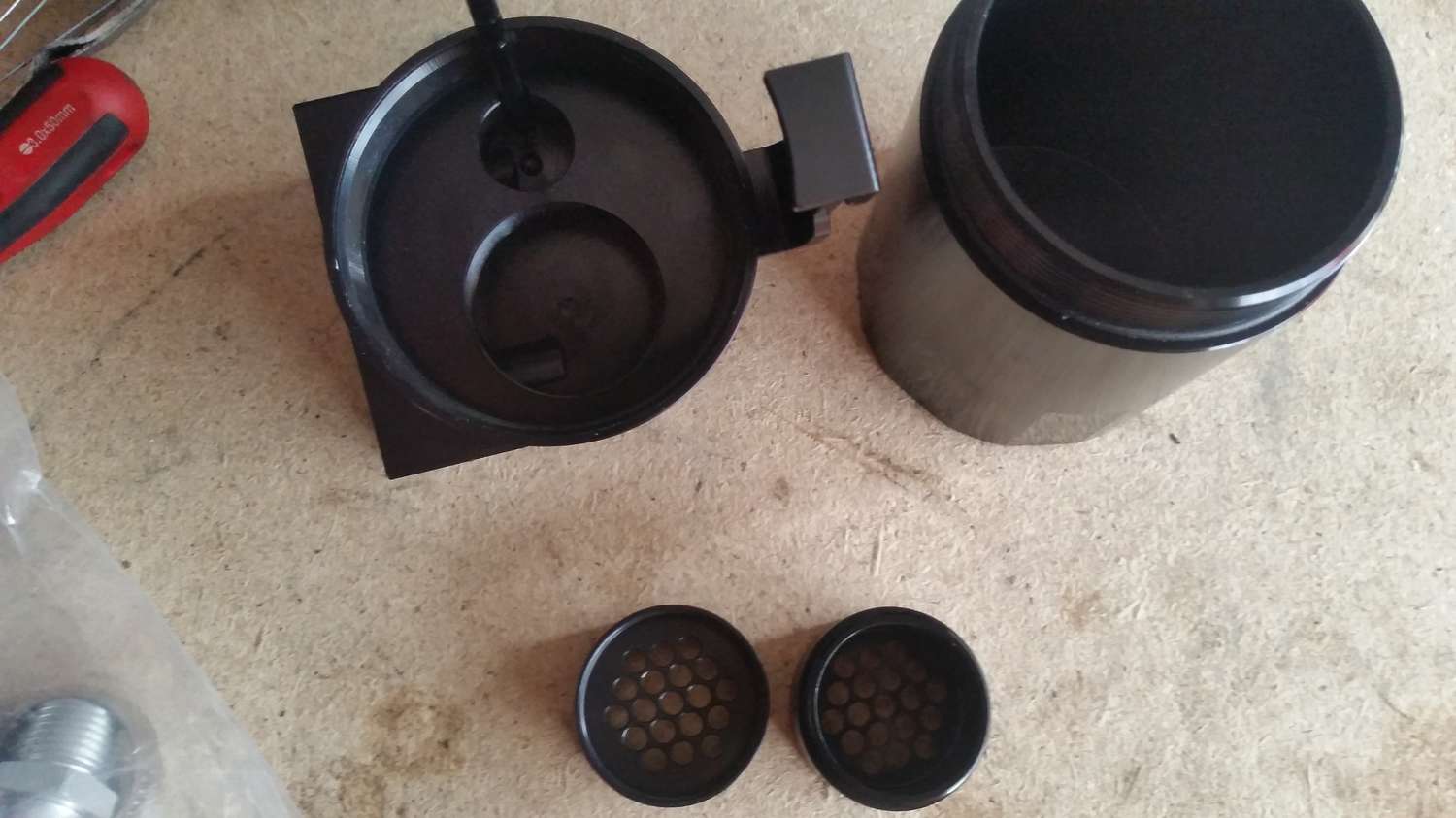

Catch can turned up, Small but should be fine. Not much in the way of a inbuilt baffle system but i've modified it slighlty
Stuck in some filter mesh into both sides of the little screw off diffuser to help give more surface area for the oil to condense on.
And of course a stainless woolly ball

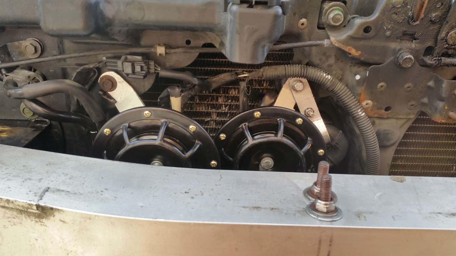

New horns fitted and a rough bracket made up for the power steering cooler rather than holding it in place with cable ties.
Its hard to make out but trying to show that the bracket is keeping the cooler clear from the intercooler.

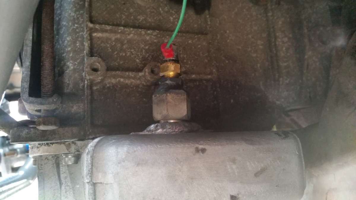

Bought a Oil temp gauge but wasn't sure where to fit it, luckily the sump had a large AN fitting plug welded on to it so drilled this out to accommodate the sensor. Pulled in a favor to get a 1/8th NPT fitting welded onto the drilled plug. This sits in the sump so will give me an indication of sump oil temp. Just got to figure out how to wire it up now.
We have NGK 1 step colder plugs in stock, as well as all the plenum gaskets if you still need them.
Cheers i'll keep that in mind for when they need renewed or if the denso's throw up any tuning issues :thumbs:

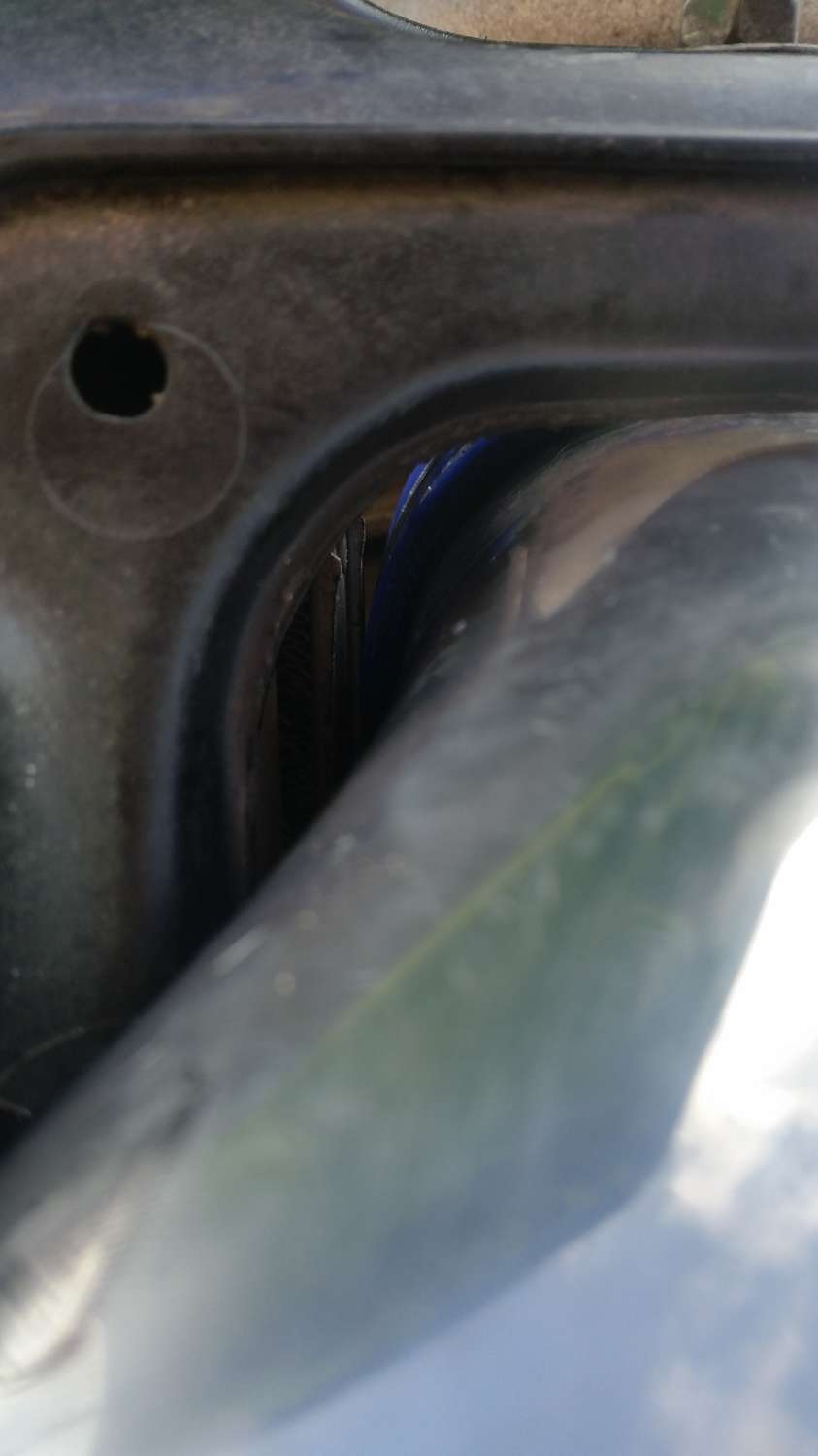

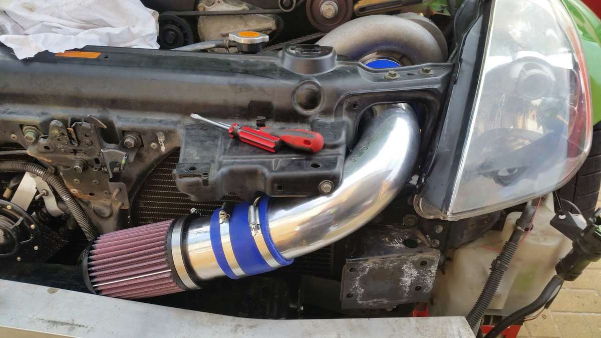

Again not much progress due to work but got a few hours on it over the week. Got the intake fitted and finished so happy its another job ticked off.

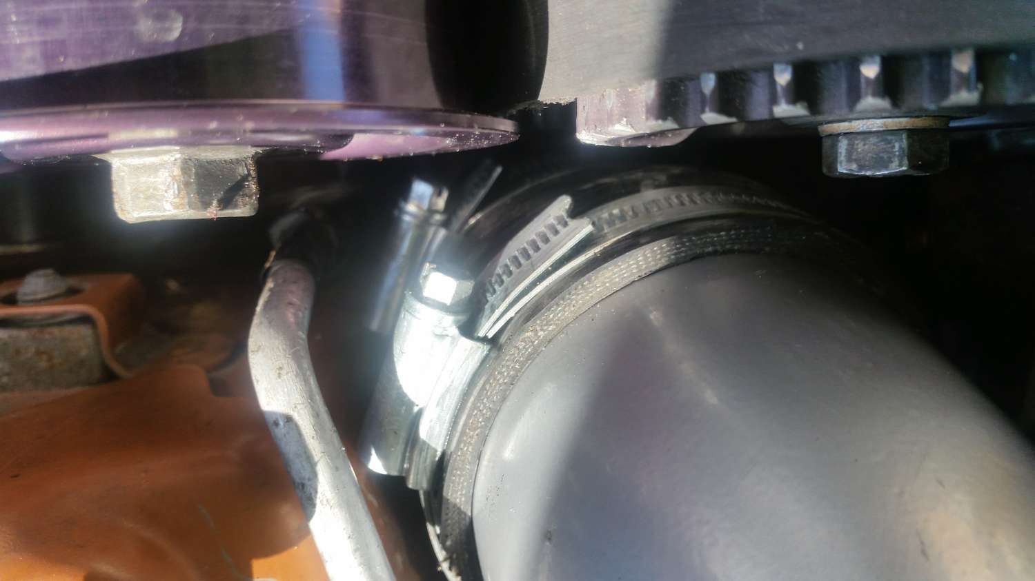

This was meant to show that it had a few mm clearance but my camera skills clearly failed :lol:
20170313_111019.thumb.jpg.0e5d21561d40788744927ea38622feff.jpg20170313_111043.thumb.jpg.ffc2e8b9266c9d70725fd61b4f9a55ba.jpg
This took a good bit of playing around with to get the right angle cut on the supercharger end so it would sit square
I opted for a solid 90deg elbow to remove any worry of hose collapsing, its all good now but was a total ball ache and a lot of trimming plastic to allow it to fit

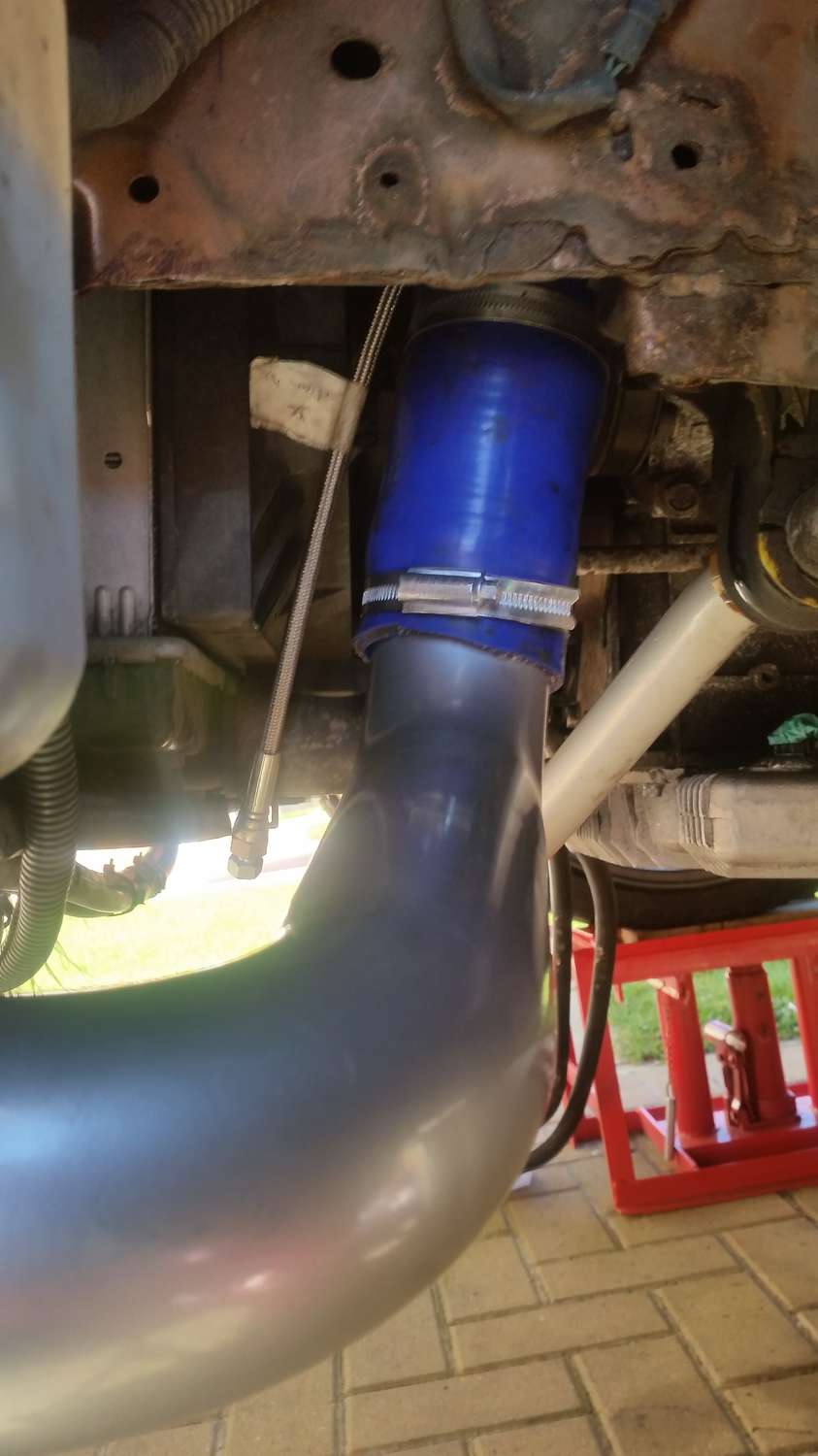

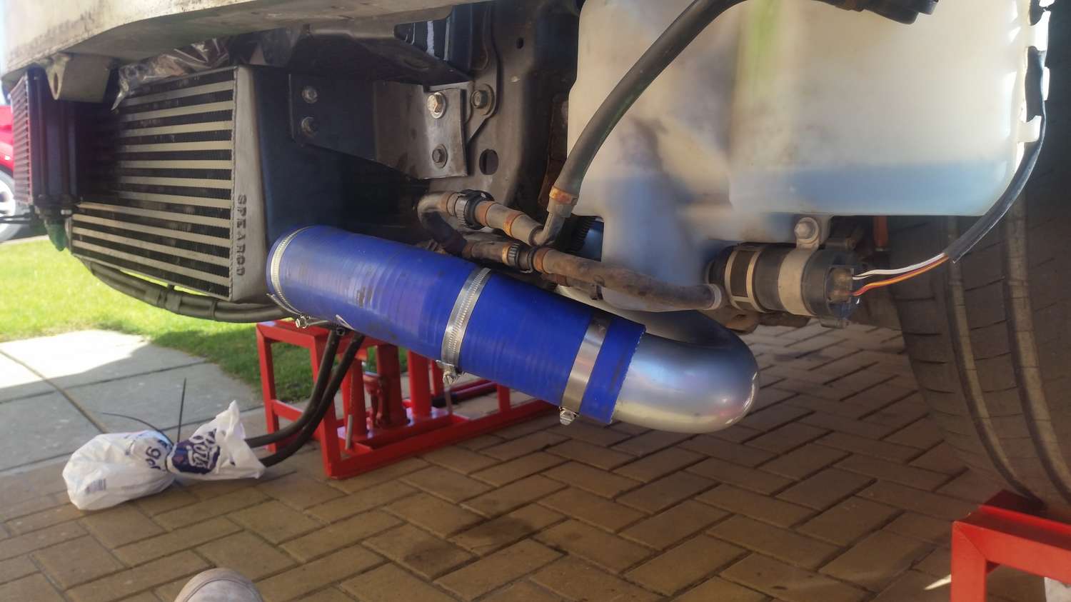

Slight concern about the bottom pipe sitting low

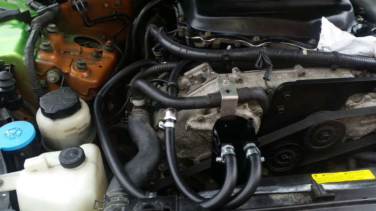

Had a bit of a mare with my catch can as my original location which was perfect is going to be fowled by the BOV :bangin:
Finally found somewhere to stick it but i'll need to make another bracket to turn it 90deg as I think the hoses will fowl the bonnet. I did look for 90deg fitting but can't find any metric parallel threaded fittings with hose connectors, all the fittings I can find are bspp or bsp but i'm 95% sure its a metric thread. No biggie i'll just make a new bracket and turn the can.

Sensor fitted
Wire fed into cabin, bit messy but should seal fine. Still to wire the gauge up at a later date
PCV set up 95% complete, Just need to make a new bracket and turn it 90deg
Boost line set up for fuel regulator, BOV etc
Wrestled the oil cooler lines into place changed oil filter & filled engine with 5L of oil for now. Next oil change i'm going to get new hoses made up as these aren't flexible enough but they will do for the time being.

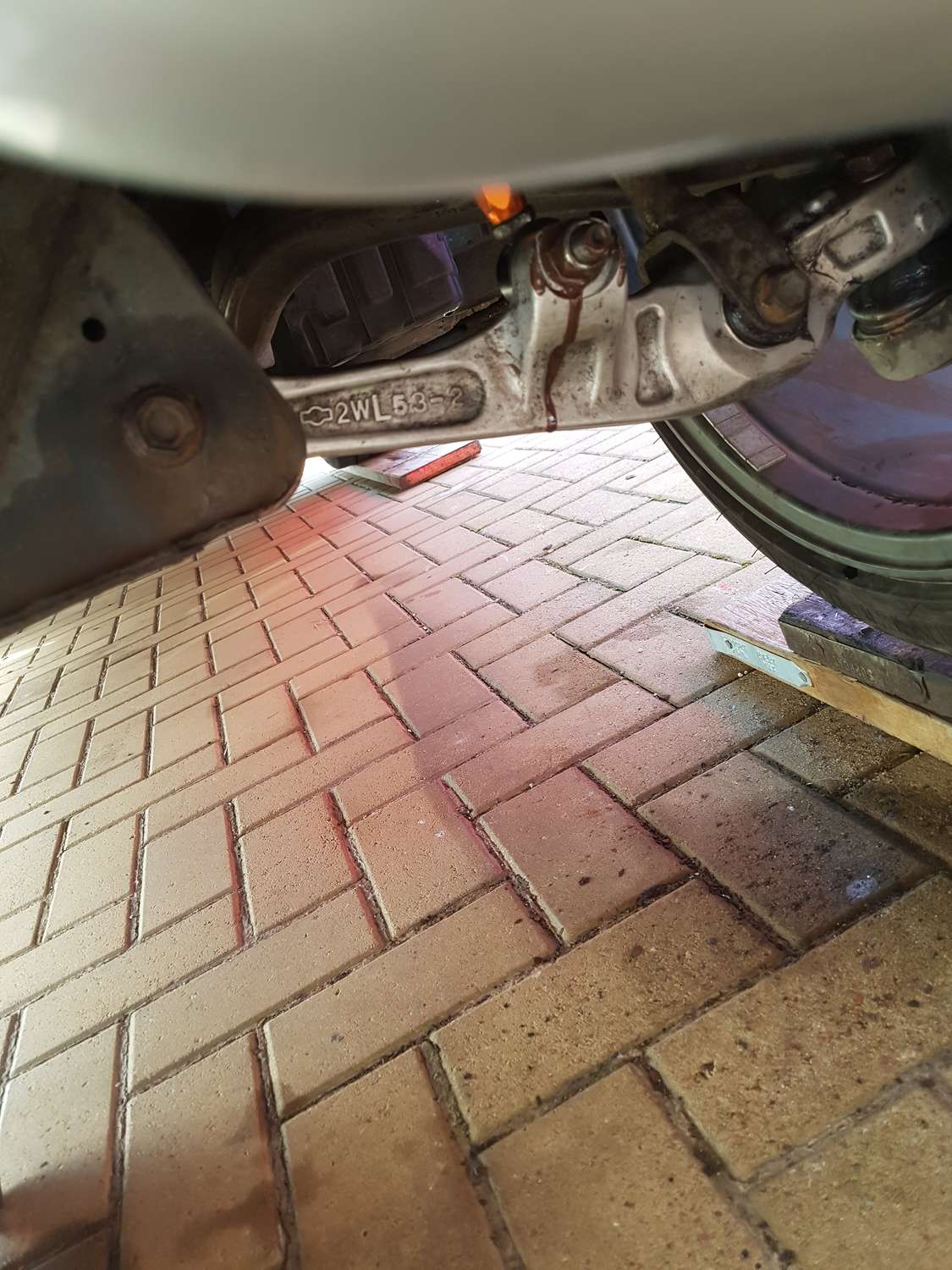

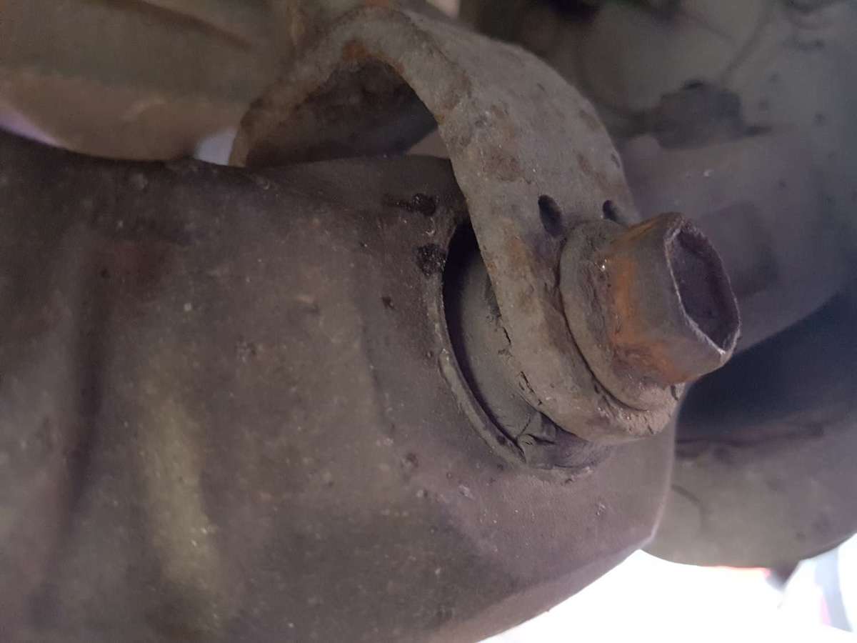

Been too busy to work on the car but its managed to spring a leak from the sump. I'm pretty sure its from the blanking plate as I made he rookie mistake of not removing it as it felt tight, Although after going round re-torquing it all after the leak was discovered it feels like one of the bolts is stripped. So i'll whip it off and either drill and tap it or helicoil it if there's not enough meat to go up a size. A silly oversight but nothing major, glad it showed up now though rather than possibly catching me out later on.

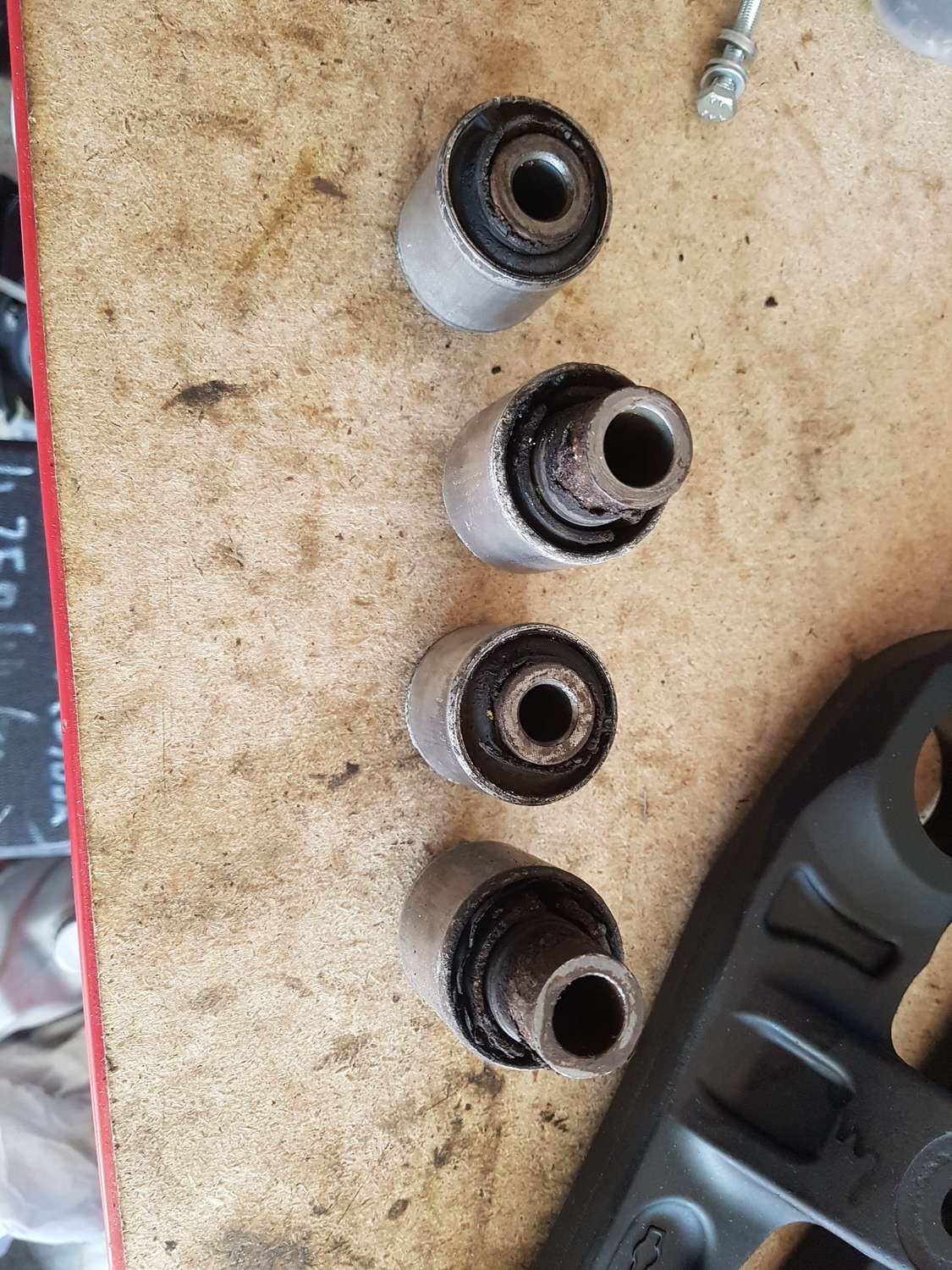

Spotted these bushes looked past it while i've had the car on the ramps.
20170403_161754.thumb.jpg.4b61f67727b6d0c547412cae351a1381.jpg20170403_161812.thumb.jpg.61ffee130cef5e33755d6a4463494b29.jpg
So soaking all the bolts in plus gas, managed to get the two shock's bolts out copperslipped and re torqued so far, I'll have another go at the others when i've more time.

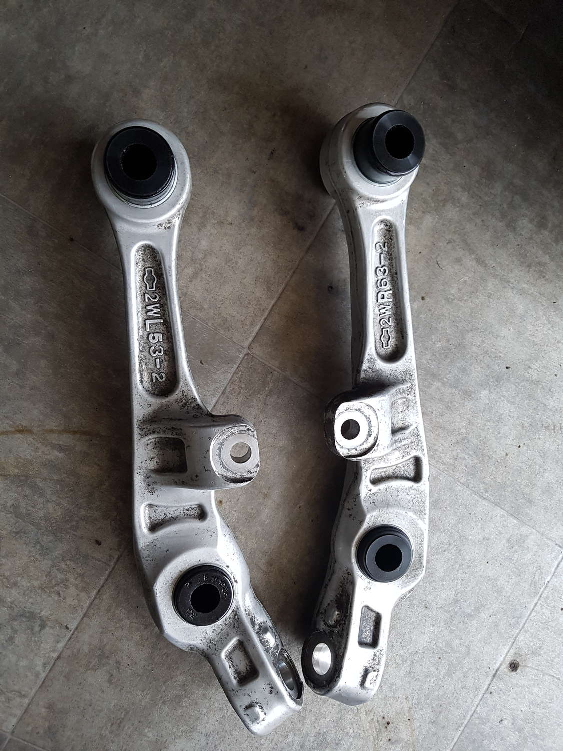

Jon at emperor tuning sorted me out with a good second set of arms and clark motorsport sorted me out with new whiteline poly bushes, So I have these prepped and ready for when the car comes back from being tuned.
Old bushes pushed out easy and new ones went in after heating the arms and freezing the bushes plus a good bit of encouragement from the press.

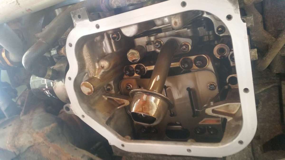

Sump removed, thread was stripped and bolt was held in with loctite or something to appear tight. Drilled and tapped to the next size up and re-fitted the sump. No more oil leak :D

Old arms out
20170412_200739.thumb.jpg.408bb296398fd9e3dbc49c4470b7a5bb.jpg20170412_200749.thumb.jpg.5bfc803d2cea5da89f2c147de09d283d.jpg
Old bushes pressed out, fair to say they've seen better days. Hopefully that's all that will be needed for her mot
Cleaned up the old arms in the blaster and gave them a quick coat of matte black
Turns out the two sets are different part numbers if you look closely at the numbers on the arms in the pictures. Only difference I can see is that the ones I've fitted now have less of a recess for the ball joint nut which doesn't allow the split pin to be fitted so i'll take these off and thread lock into place next time i'm under the car.

Went to wash the car today and noticed a oil stain on the drive, quick look and it would seem that pesky oil leak is back on the sump :bang: so will have a look at this again!
Need to remove the passenger side washer bottle and sort the intercooler pipework now I'v got an mot.
