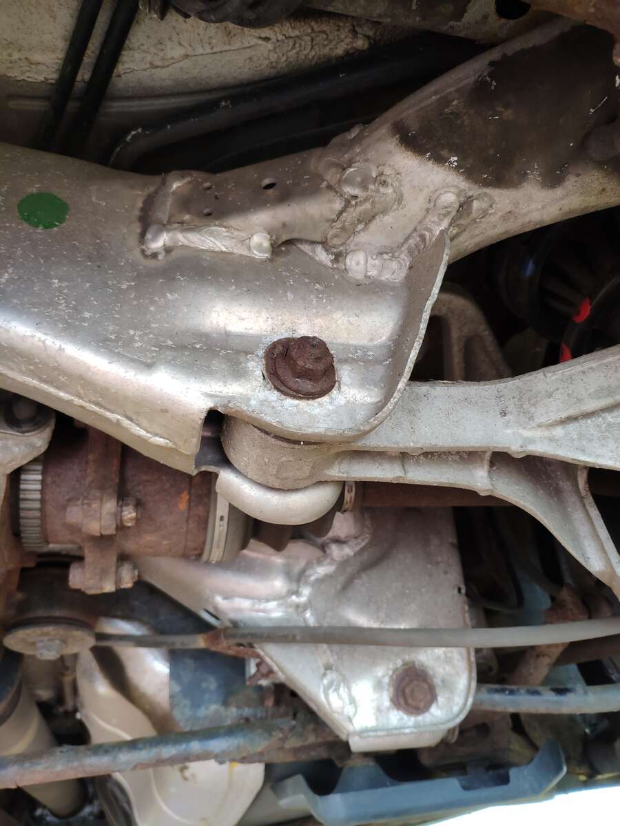

350zeta Posted July 29, 2020 Share Posted July 29, 2020 Hi All, I know this post is quite old but I've recently bought a 350z and took it to fit new tyres and alignment. They aligned the front ones but they couldn't do the rear ones due to similar issues as mentioned above. I've tried asking nissan dealership for camber/toe bolts and they are quoting me £160 for 4 bolts , this can't be right as they were not sure about which bolts are needed and I don't feel confident either as they don't accept returns. Do you guys have any advice? Is there a cheaper option? Also just to be sure, see attached underneath picture of my car where these bolts are located according to garage. Thank you Quote Link to comment Share on other sites More sharing options...
ZMANALEX Posted July 30, 2020 Share Posted July 30, 2020 I have these bolt kits in stock and they are good to go same/next day. On the rear there are 2 for the camber adjustment and 2 for the toe adjustment. Best to replace the 4 of them. Just drop me a PM if I can help further. Alex. Quote Link to comment Share on other sites More sharing options...
mr v6 Posted July 30, 2020 Share Posted July 30, 2020 I had mine done almost 2 years ago at Drury Lane Service Station in Failsworth. They had what looked like a welder, but was actually some sort of induction thing that heated the area up around the bolts & they just came loose. Worth looking them up, they know their stuff. Quote Link to comment Share on other sites More sharing options...
350zeta Posted July 31, 2020 Share Posted July 31, 2020 On 30/07/2020 at 17:36, mr v6 said: I had mine done almost 2 years ago at Drury Lane Service Station in Failsworth. They had what looked like a welder, but was actually some sort of induction thing that heated the area up around the bolts & they just came loose. Worth looking them up, they know their stuff. That's great shout I will take a look as I'm not too far. Thanks for your help! Quote Link to comment Share on other sites More sharing options...

mr v6 Posted August 1, 2020 Share Posted August 1, 2020 I knew I had the pic somewhere: 1 Quote Link to comment Share on other sites More sharing options...
350zeta Posted August 2, 2020 Share Posted August 2, 2020 16 hours ago, mr v6 said: I knew I had the pic somewhere: amazing, I will take this to the garage and see if they can do something similar and use the same bolts! Thank you Quote Link to comment Share on other sites More sharing options...
