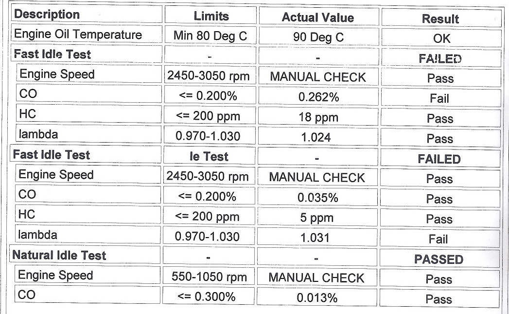

inspiral Posted December 10, 2013 Share Posted December 10, 2013 (edited) Hi AllFirstly apologies for posting this here instead of the Technical forum but my car is a daily driver so felt the extra attention traffic here would get me back on the road quicker. Mods feel free to move if you feel this is the correct thing to do.My 04 350z is standard except for a Japspeed cat back exhaust and it's just failed the MOT emissions test. I've got the previous years results and it passed well within all the appropriate limits. The has always been serviced as per the recommended schedule and runs well on the road. It has 77k on the clock.Can I have your thoughts please on how to address the following test results.Thanks very much for your time. Edited December 10, 2013 by inspiral Quote Link to comment Share on other sites More sharing options...

Grundy Posted December 10, 2013 Share Posted December 10, 2013 If I'm right in thinking, that only failed by a small margin. How far was the drive to the MOT station? and How long had the car been running before the MOT? Quote Link to comment Share on other sites More sharing options...
inspiral Posted December 10, 2013 Author Share Posted December 10, 2013 (edited) Sounds like one or both of them may have failed. Did the MOT place not offer any sort of advice? ./snip/. If you were near Leeds I'd happily lend you mine. Only having done 77k I hope the Cats haven't expired. Thanks for the offer, shame you're not local. If I'm right in thinking, that only failed by a small margin. How far was the drive to the MOT station? and How long had the car been running before the MOT? This is the flaw in my plan, I'm only 5 mins from the station and I took it straight there first think. The tester let her idle up to temp, I didn't feel that was right at the time but didn't say anything.The best they could do advice he was to try an injector cleaner. Which incidentally he said would also make me more attractive to the opposite sex Edited December 10, 2013 by inspiral Quote Link to comment Share on other sites More sharing options...

Grundy Posted December 10, 2013 Share Posted December 10, 2013 Sounds like one or both of them may have failed. Did the MOT place not offer any sort of advice? ./snip/. If you were near Leeds I'd happily lend you mine. Only having done 77k I hope the Cats haven't expired. Thanks for the offer, shame you're not local. If I'm right in thinking, that only failed by a small margin. How far was the drive to the MOT station? and How long had the car been running before the MOT? This is the flaw in my plan, I'm only 5 mins from the station and I took it straight there first think. The tester let her idle up to temp, I didn't feel that was right at the time but didn't say anything.The best they could do advice he was to try an injector cleaner. Which incidentally he said would also make me more attractive to the opposite sex Yeah, go for a half hour drive, put your foot down a bit here and there, get the car nice and hot, should fly through Quote Link to comment Share on other sites More sharing options...
