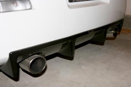

Jared350z Posted December 7, 2013 Share Posted December 7, 2013 Hello fellow zed heads, I recently got a rear diffuser, the one that sits just over the exhausts.( same as in the picture below) I was gonna attempt to fit it myself as it doesn't seem that hard only problem I have I'm not sure on how to bond/fix it to my bumper. If anyone can help me out I will be super grateful. Cheers Quote Link to comment Share on other sites More sharing options...
Richie-B Posted December 7, 2013 Share Posted December 7, 2013 Get yourself some tiger bond and clamps and you should be able to work it out 1 Quote Link to comment Share on other sites More sharing options...
SkylineV35 Posted December 7, 2013 Share Posted December 7, 2013 run a thick bead of bond along where it touches your bumper and then around 5mm from the edge run a thin bead along the rim of the diffuser.. fit in to place and attach clamps so that it holds it tight against the bumper... once its dried and set run a thin bead right around the lip of the diffuser so theres no little gaps or anything and looks flush... have white spirit handy in case it smudges on to the bumper... have fun =) 1 Quote Link to comment Share on other sites More sharing options...
GMballistic Posted December 7, 2013 Share Posted December 7, 2013 ^^ What he said. That's going to look very cool fitted. Quote Link to comment Share on other sites More sharing options...
Tinyflier Posted December 17, 2013 Share Posted December 17, 2013 Mine is fitted with 3M body tape around the inner perimeter and two small self tappers underneath into the bumper (where they cannot be seen). David Quote Link to comment Share on other sites More sharing options...

leonk Posted January 15, 2014 Share Posted January 15, 2014 Get yourself some of these or similar. http://cdn.toolstati...?rand=315740910 We bond stainless sheet with Sikaflex, similar to Tiger Bond and they are great for cleaning up excess adhesive and your hands if you get it on them. Also use them to de grease your parts prior to bonding. Wax polish on the bumper will impair the adhesives ability to bond. Hope this helps. 1 Quote Link to comment Share on other sites More sharing options...
