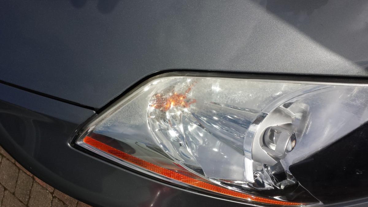

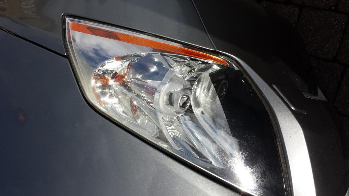

Adrian_CNC Posted August 17, 2014 Share Posted August 17, 2014 My lights are hazed pretty badly and I'm not sure whether it's condensation that dried out inside the headlamps or something else, anyone had similar stains on/in their headlights? Quote Link to comment Share on other sites More sharing options...
GMballistic Posted August 17, 2014 Share Posted August 17, 2014 My lights are hazed pretty badly and I'm not sure whether it's condensation that dried out inside the headlamps or something else, anyone had similar stains on/in their headlights? Yep that's exactly how my headlights used to look before I did my restoration on them. See below quote on how I fixed mine. Just thought I'd add to this thread now as today I used the Meguairs headlight restoration kit "plus" on my Zed. It's their new version of the kit which includes 4 grades of wet & dry on two handy little pads. Link: http://www.ebay.co.u...=p2054897.l4275 Firstly I used the kit without trying the sanding pads ~ this gave me a good finish but there was still bad fogging on the corners of my lights. So I manned up and used the sanding pads. It was worrying at first as obviously you are adding scratches at first when you use the pads. In fact after using the first grade of pad and wiping off the water you can see it totally hazes your entire light cover. I persevered with the sanding using one grade at a time, lots of water and following the instructions using one side to side, then the next up & down and so on. Once I had completed the sanding steps I then went back to using the mop and PlastX ~ this was when the magic happened and finally my headlights look "almost" as good as new again. Very happy with the results and wish I'd tried this in the first place rather than the other products I had tried which where useless. 1 Quote Link to comment Share on other sites More sharing options...
Adrian_CNC Posted August 17, 2014 Share Posted August 17, 2014 (edited) Yep that's exactly how my headlights used to look before I did my restoration on them. See below quote on how I fixed mine. Brilliant, thank you for the quick reply! I was worried it was on the inside but in that case I will get it sorted asap. Edited August 17, 2014 by Adrian_CNC Quote Link to comment Share on other sites More sharing options...
GMballistic Posted August 17, 2014 Share Posted August 17, 2014 Yep that's exactly how my headlights used to look before I did my restoration on them. See below quote on how I fixed mine. Brilliant, thank you for the quick reply! I was worried it was on the inside but in that case I will get it sorted asap. When you do it get some masking tape to go all the way around your headlights to protect the surrounding paint work from the sanding pads and mop with PlastX. Also make sure you follow the instructions about using the sanding pads to the letter and use them in the correct order. e.g. Roughest grade>smoothest grade. If you can as well buy some UV protection to go on top of the headlights afterwards to keep it from getting UV damaged again for as long as possible. Quote Link to comment Share on other sites More sharing options...
