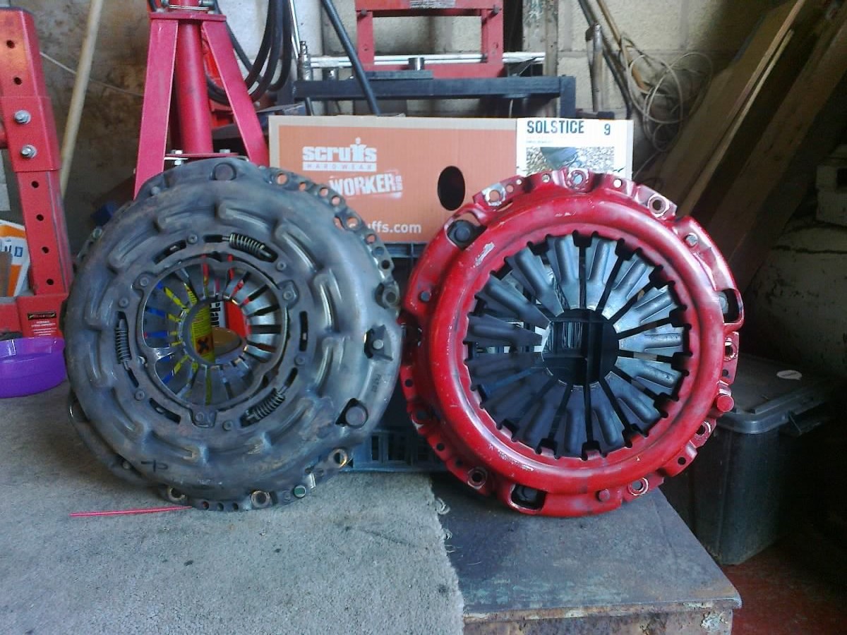

Bolt666 Posted February 27, 2014 Author Share Posted February 27, 2014 New Development - Transmission out again... Studied parts.... Called Nissan.... Now I need help! I believe the clutch is wrong - the pressure plate do not look alike. I have called Nissan and they said the part per their system on my chassis number is 30205CD021 (later reversion 30205CD00B and current 30205CD00C). I asked them to check if this matched and 03 car or a 07 car and it turns out both used different clutches..... So now I am really lost as my car seems to have its own special clutch! They have quoted almost £500 for this which seems a lot! See the image below for new vs old (new being red) Anyone know what after market clutch kit I need??? Thanks in advance! Quote Link to comment Share on other sites More sharing options...
ZMANALEX Posted February 27, 2014 Share Posted February 27, 2014 So you eventually did listen: Nissan list 4 different part numbers for applications between 2003 and Jan. 2007 for the DE. However they are all interchangable. All aftermarket clutch covers will look different from OEM so appearance is not a factor. What you will have to do is measure the height of the covers and compare. Measure from the tip of the diaphragm to the face of the friction surface. Alex. Quote Link to comment Share on other sites More sharing options...
