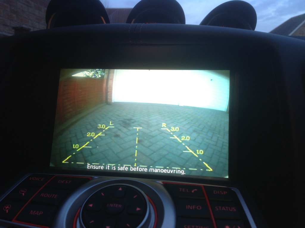

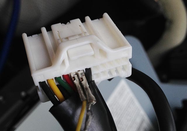

Davectr Posted January 21, 2014 Share Posted January 21, 2014 I bought a loom through a guy on another forum and a camera from eBay for £17. So all in I was under £80. The loom the guy makes is spot on and plug and play. I am sure I can speak to the guy for you if you needed one I tried following something I'd read 'somewhere' on t'interweb and bought a camera off fleabay for £15 then just added the wires to the back of the nav display and changed the settings in the secret menu, works a treat! 😄 Quote Link to comment Share on other sites More sharing options...
Davectr Posted January 21, 2014 Share Posted January 21, 2014 Is that an s-tune replica or the real deal? Will look awesome, I love the s-tune kit and I'm between that and the amuse, but finding a reasonable rep over here is tough. And yeah if you could speak to the guy that would be perfect as I'm planning to do this ASAP (I park on street and as you'll know visibility is extremely poor, but mostly its just a gadget that I really want to have ) How much work was the install, the trim I'm not too woried about as I've done several audio installs before, its taking apart the dashboard I'm worried about? The install is really quite easy, and taking the centre console/dash apart was much easier than expected. Two screws at the end nearest the back of the seats either side of the console, unclip the gear stick surround (prise up, from handbrake end first, and unclip) then remove the rest of the screws (about 8, all now visible). Pull the nav surround panel (with vents in) away from the dash starting at the bottom and working upwards Quote Link to comment Share on other sites More sharing options...
