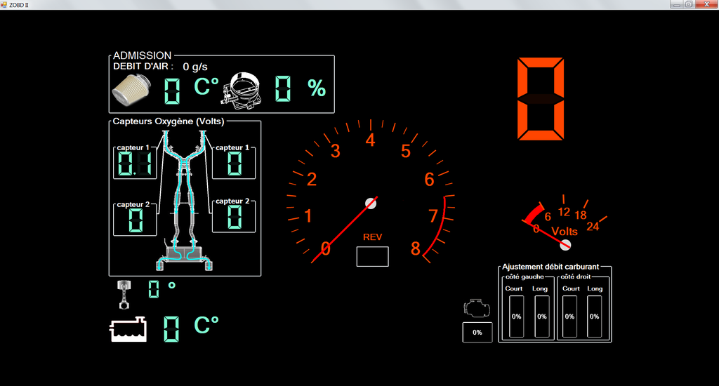

V_62 Posted August 22, 2013 Share Posted August 22, 2013 (edited) Hello everyone, bah it is good I managed to develop my own PC application that sends me information in real time. It's nickel! Advantage: free, displaying all information received by our OBD2 Port (so much more info than our counters show us), changing the application with everything imaginable ... Disadvantages: uh .... no from buying a cable connecting 20 € ELM327 USB port on the PC, and (long) term, a touch pad for the Z but in the meantime a pc only For now, I just shows the engine speed on a gauge, but the hardest part was to develop something stable and light. I started with the source code available on the net, but nothing worked properly and too much writing code. I'm out doing something to my sauce and especially light and stable so now I'm going to make myself a nice little app and also to enjoy the forum. The forward interest for me, completely empty the Z, including counters and install a touchscreen constantly connected to the ELM327 and showing me all the details in real time. Personally, I try not to have a Z that makes 600hp, 280hp, its enough for me but I love weight gain level up, even if it's not much, but for fun. Here, here. Thereafter, one can imagine anything and everything, a menu to clear faults code, another showing all information in real time, generate graphs in every possible way after a session, etc ... Your ideas are welcome. I will not develop for the iPhone and other, already because it's not my thing and visibility level and ergonomics I do not think it's super top, if you can send the information to the Z so must Meanwhile touch pads to your pc! I will update this post with new versions each time, you already rocking the first version will not hurt. That and thank you in advance for your info if you have ideas for this App. Link to cable: http://www.obdauto.f...-vgate-usb.html (they also do Bluetooth but sh * t like that long term this technology, I prefer the good old USB ) Their software provides is useful to clear the fault codes, if not for the rest, I personally did not find top ... hence the desire to make my app as well. @ + Edited August 22, 2013 by V_62 Quote Link to comment Share on other sites More sharing options...

V_62 Posted August 22, 2013 Author Share Posted August 22, 2013 (edited) How, not cool, once the subject of the post created, we cannot change it Pic of Application for the moment : Edited August 22, 2013 by V_62 Quote Link to comment Share on other sites More sharing options...
