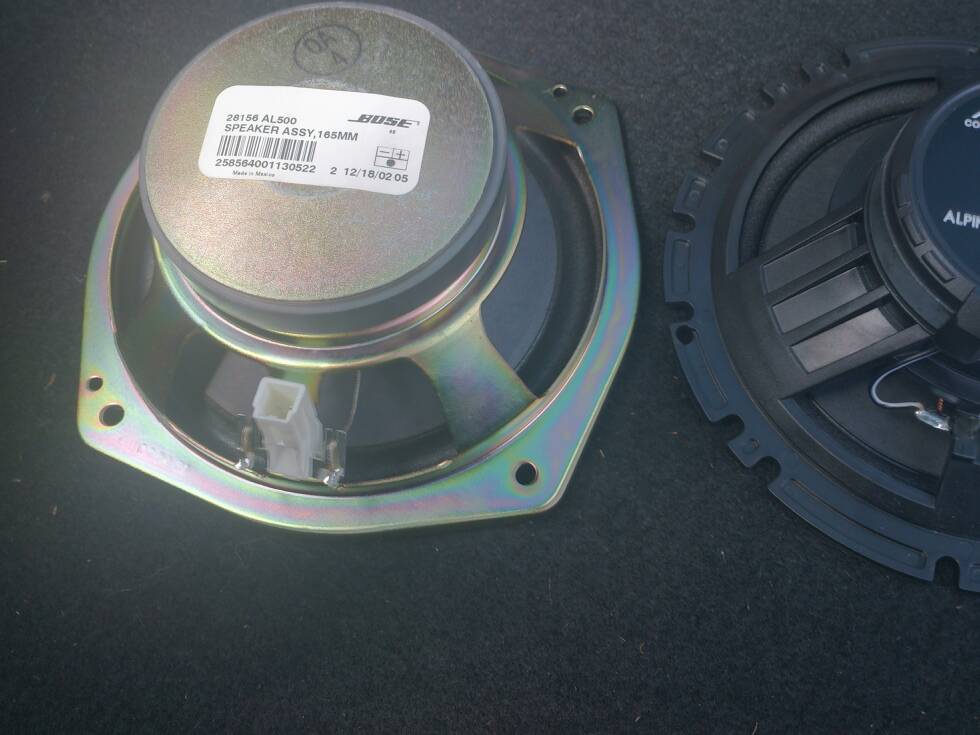

Dannyg Posted July 6, 2013 Share Posted July 6, 2013 (edited) When fitting rear speakers Edited July 6, 2013 by Dannyg Quote Link to comment Share on other sites More sharing options...
BulletMagnet Posted July 6, 2013 Share Posted July 6, 2013 I pulled new speaker wire from my aftermarket HU to the speakers and put spade connectors on the wire. I also believe that the OEM speakers are 0.5 Ohm whereas your replacements are 4 Ohm, so I'm not sure whether the Bose amp will play well with those. Quote Link to comment Share on other sites More sharing options...

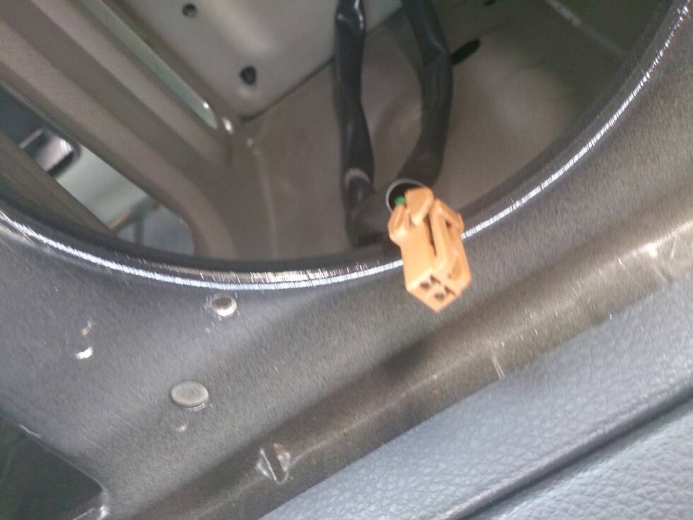

Dannyg Posted July 6, 2013 Author Share Posted July 6, 2013 (edited) Instead of running more wires can I cut the connector off of the existing one and stick some spades on? Edited July 6, 2013 by Dannyg Quote Link to comment Share on other sites More sharing options...
HollowPoint Posted July 6, 2013 Share Posted July 6, 2013 You can and that's the most common way of doing it, I usually cut plenty of spare wire for the connector though, just in case you ever want to put it back to standard for any reason. Quote Link to comment Share on other sites More sharing options...

tony.r123 Posted July 6, 2013 Share Posted July 6, 2013 Or you can get plug to spade adapters from most motorist stores. Quote Link to comment Share on other sites More sharing options...
