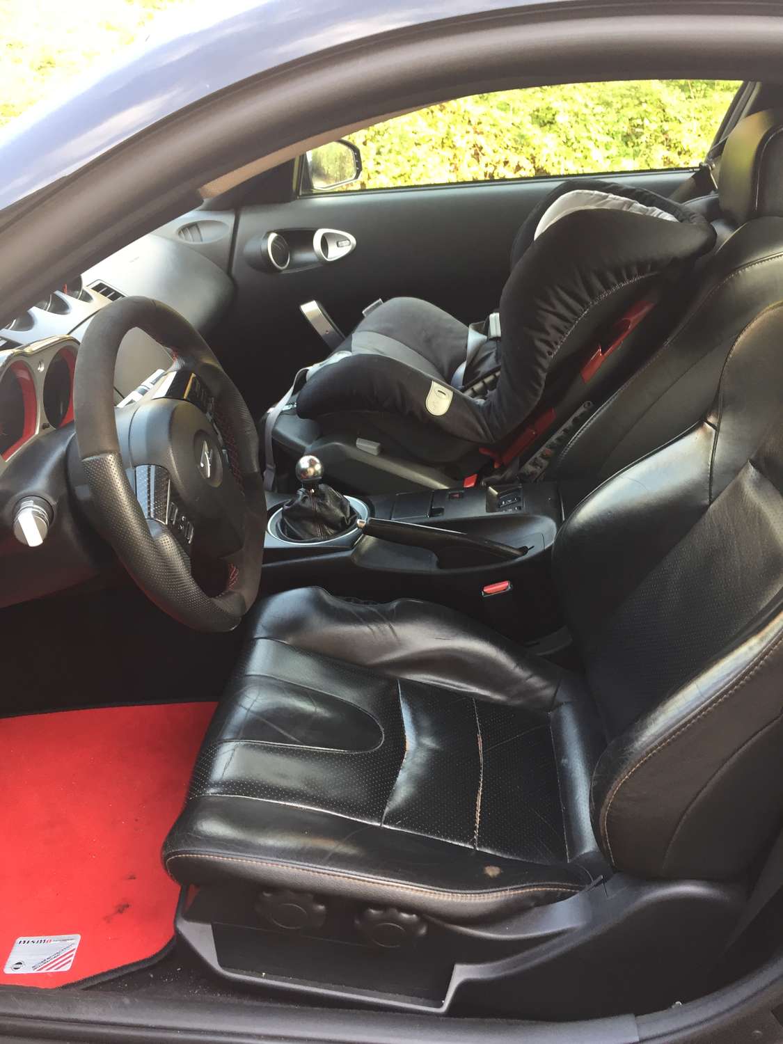

Ortega_9 Posted December 7, 2017 Share Posted December 7, 2017 I Think the airbag is only a problem on rear facing Child seats? this setup works fine for me Quote Link to comment Share on other sites More sharing options...
AMT Posted December 7, 2017 Share Posted December 7, 2017 Same sort of set up and put right back in mine. I still wouldn't want an airbag in their face as can still hurt but again can remove. I've never removed mine. Where is the fuse for the passenger airbag and what no. is it? (assuming its a numbered fuse). Quote Link to comment Share on other sites More sharing options...
Ortega_9 Posted December 8, 2017 Share Posted December 8, 2017 8 hours ago, AMT said: Same sort of set up and put right back in mine. I still wouldn't want an airbag in their face as can still hurt but again can remove. I've never removed mine. Where is the fuse for the passenger airbag and what no. is it? (assuming its a numbered fuse). I'm not sure about the fuse... does it only affect the passenger side front airbag? There is also the curtain airbag, and the one in the seat... Quote Link to comment Share on other sites More sharing options...
Toon Chris Posted December 8, 2017 Share Posted December 8, 2017 22 hours ago, Ortega_9 said: I Think the airbag is only a problem on rear facing Child seats? this setup works fine for me Good God man, never mind the child seat, your steering wheel is on the wrong side! 2 Quote Link to comment Share on other sites More sharing options...

Ortega_9 Posted December 10, 2017 Share Posted December 10, 2017 On 8/12/2017 at 17:46, Toon Chris said: Good God man, never mind the child seat, your steering wheel is on the wrong side! Quote Link to comment Share on other sites More sharing options...
