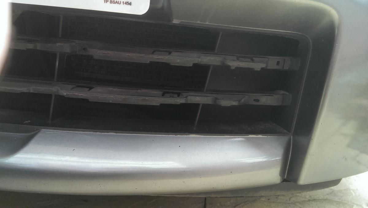

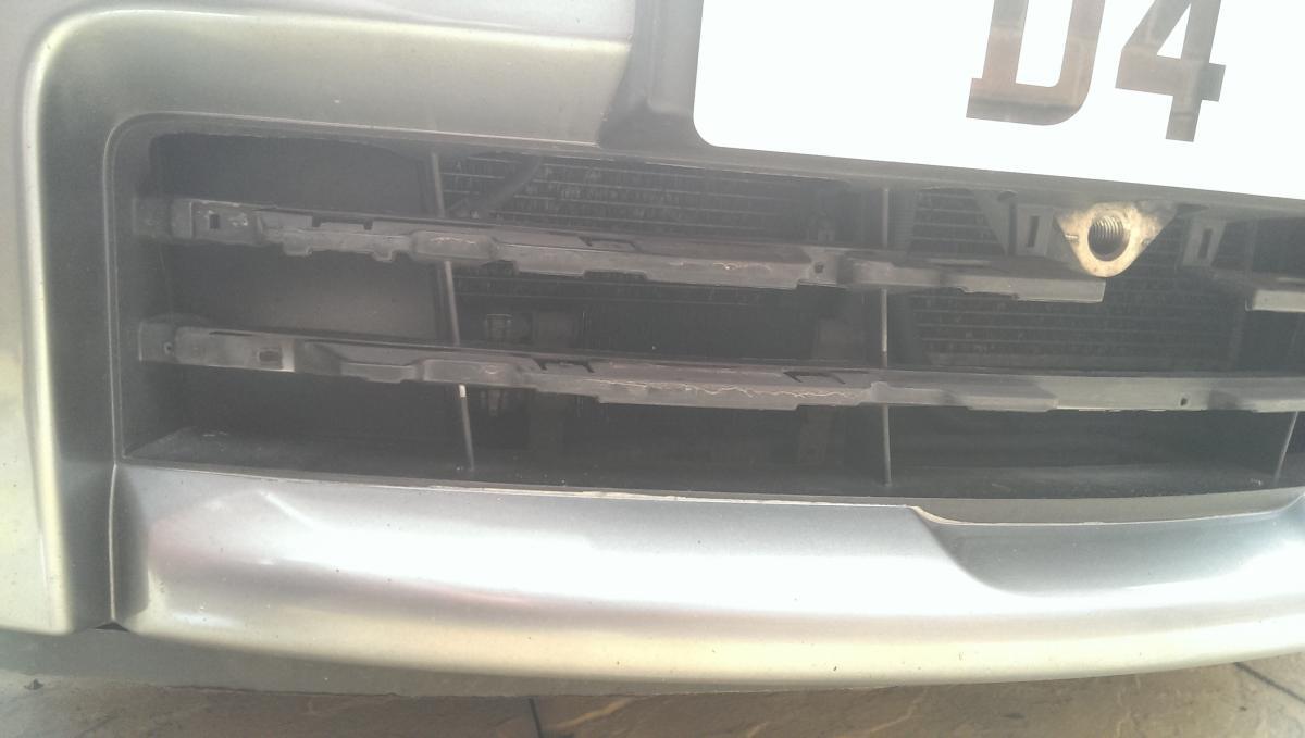

Dayy Posted June 29, 2013 Share Posted June 29, 2013 Hey guys, I bought a Zunsport Grill in Black for my car from Steve @ Redline Styling the other day. I have managed to get as far as taking those two plastic bits out from behind, and then unscrewing the slats (or whatever they are called) so it looks like in the pictures; However, now I have got to the part where I am meant to just screw the Grill on, it doesn't actually have anything to screw in to. The holes don't line up with those two plastic bars so I can't screw them in to that (We tried doing it at an angle too, but the screws dont stay in). The grill also seems like it is too tall to actually fit on properly too. Is there something that I have missed here? Some extra step I am meant to take? I can only assume that Steve has sent me the right part (Part number is ZNS 18807), so I must be doing something wrong, but for the life of me, me and my dad can't figure it out. Any help would be greatly appreciated and if you need any more info, or more pictures let me know and I shall provide. Thanks, Quote Link to comment Share on other sites More sharing options...

Tinyflier Posted June 29, 2013 Share Posted June 29, 2013 (edited) Your Zunsport grille should have a "step" in the middle at the bottom to match the recess in the bumper lip. If it doesn't you don't have the correct grille. If it does, then it should fit - mine did! I just checked my invoice from Steve @ Redline-Styling but it doesn't have a part number! David Edited June 29, 2013 by Tinyflier Quote Link to comment Share on other sites More sharing options...

Tinyflier Posted June 29, 2013 Share Posted June 29, 2013 (edited) I'm not sure you take the existing grille off, I know I didn't on mine but that was a pre-facelift, I can't see why the facelift one would be different apart from the step in the middle SMD - on the facelift the painted slats are positioned quite far forward. If you look from the side they protrude out from the grille aperture hence need to be removed. To OP - where are you based? David Edited June 29, 2013 by Tinyflier Quote Link to comment Share on other sites More sharing options...

hensh65 Posted June 29, 2013 Share Posted June 29, 2013 They advertise it is a new grill without removing the old one, so put your old one back on! Line it up to where you think it is right and the screw holes should coincide with a plastic panel in the bumper. Get the screws provided and screw them in ,,, easy ! Quote Link to comment Share on other sites More sharing options...
jell36 Posted June 30, 2013 Share Posted June 30, 2013 Your right about taking the slats off for the facelift. Is there a bit on the Zunsport where it protrudes out slightly on the bottom of the grill in the middle? If not, I think you have the wrong zunsport grill version. The grill does need to be bent/curved a little when installing so that is matches the contours of the OEM bumber. The screws from the zunsport kit don't go into any holes, they are self tapping and so create their own holes, you just need to bend the grill a little so that you can get the screws to grip into the plastic and then keep screwing and they will tap themselves in. Quote Link to comment Share on other sites More sharing options...
Dayy Posted July 4, 2013 Author Share Posted July 4, 2013 Success! Turns out it just needed a bit of man power to get it in to the right position to line up for the screws. http://i.imgur.com/urMCPza.jpg http://i.imgur.com/zdl2Dou.jpg http://i.imgur.com/a0pCgV4.jpg 1 Quote Link to comment Share on other sites More sharing options...
