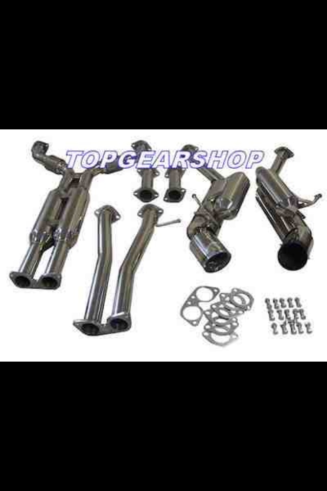

Paulz Posted June 25, 2013 Share Posted June 25, 2013 Hi everyone. I am hoping to get a nice stainless exhaust for my 350z soon. I was thinking of getting a new y pipe and the eBay twin back box type exhaust or I have been talking to my local exhaust builder and he is saying he could build me a twin system for about the same price!! I was just wondering if anyone has any feedback from the eBay twin back box system ( fit ment, sound and build quality) I will try and add a pic of the eBay type. Or do I get my local exhaust builder to make me a twin system? Also if I go down the twin system do I just get two small cans at the rear or would that be insanely loud?!?! Any help would be greatly appreciated Quote Link to comment Share on other sites More sharing options...

14N Posted June 27, 2013 Share Posted June 27, 2013 The exhaust you've pictured looks like a Japspeed K1 (or at least a copy of), which (if you do a quick search) has notorious fitment and quality issues. However some owners have this system fitted with no issues (but the majority do seem to report one issue or another). The K1 is a LOUD exhaust. The small silencers near the end of each tail pipe come with 'bungs' that screw into the ends. These reduce the volume level and make the exhaust noise barable. Removing the bungs makes the zorst VERY loud. Some owners like this, some put up with it for a while, then put the bungs back in and some put them back in immediately! Anyway, I appreciate all of that is irrelevant as you're getting a system custome made by an exhaust builder - definitely the preferred and best option Let us all know how it goes with details and pics Quote Link to comment Share on other sites More sharing options...

Paulz Posted June 27, 2013 Author Share Posted June 27, 2013 This is the pic of the shop had for the template he is planning for me. The only difference is he said not to bother with the resignator on the back boxes Quote Link to comment Share on other sites More sharing options...
longsh07 Posted June 27, 2013 Share Posted June 27, 2013 Looks like HKS replica to me! 1 Quote Link to comment Share on other sites More sharing options...
