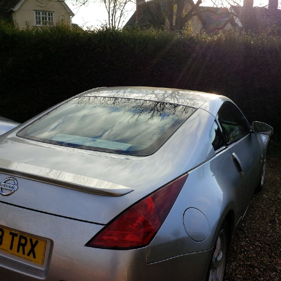

jimboy2 Posted July 6, 2014 Share Posted July 6, 2014 Any pictures of this done on a silver zed? Does the black bung stick out like a sore thumb? This is something I want to do Quote Link to comment Share on other sites More sharing options...
Vlad Posted July 7, 2014 Share Posted July 7, 2014 I have it done on my GM, but I did spray grommet as well Quote Link to comment Share on other sites More sharing options...
